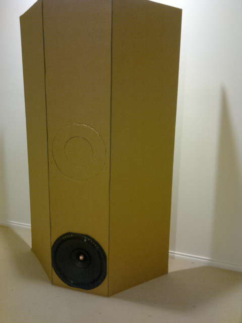

In fairness to Dave, he does also have a 13.6 cubic feet cabinet.
I do have a few ideas to try with the 5.6 cab though.
Either way it will be interesting to see what the result will be
Joined 2009

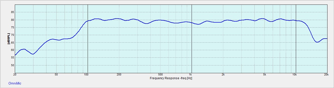

What you get with the smaller box is a bit of hump at the low frequencies. If simulations can be believed, the hump is small, smaller than the baffle step roll off. I figure that it may even be intentional - an attempt to compensate for the baffle step, but I don't think the hump is enough to do that.
I played around with the box simulations, it does look better with more space than the 5.6 cab, but I don't know how audible this would be.
When using a box smaller than the Vas, I think it makes sense to do the experiment of stuffing the port so that it's more like an Aperiodic box. You'll be able to try this experiment easy enough.
It may also work better sealed. You can block the port altogether and try this too.

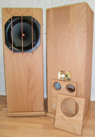

I saw one picture on the internet somewhere where the box had been designed with a big hole in it and different sized pieces of wood could be screwed over the hole to allow for different port dimensions. This sounds Melonesque...

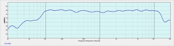

Here is the response with baffle right against the wall
EDIT: I am too lazy to take another photo. Anyway it is right against the wall

Here's a photo of what I was describing that I found on the 'net
I like the flat response against the wall.

The only listening tests I have done with woofer near the floor were the ones I did very early on with the baffle leaned back at a slight angle so it was on axis with ear. In that instance I did not get the feeling voices were comig from the floor.
My initial feeling though with this huge baffle is it seems to lose some of the magic of the smaller Jamo baffle but it could just be cardboard vs birch ply effect.
These are just very initial feelings.
I think the best compromise would be something like PHY baffle at around 1m to 1.2m tall and around 1.4m to 1.6m wide (total) with centre of woofer about 14" above ground height, and baffle angled slightly back wards.
When I have finished testing the 5.6 cabinet I can use the front baffle as a chassis for the PHY baffle, and see how it sounds.

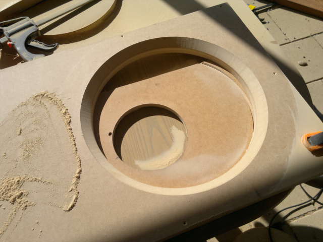

Boxes are bloody slow to build
I am doing the cut out for the woofer at the moment

Just some advice regarding construction. Make the box 1.5 inches taller and put in more bracing. Use at least 1.5 inch thick for the front baffle.
