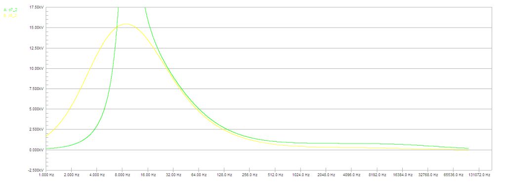

That bass bump changes depending on the head output resistance, is there any way you can measure the DC resistance of the heads that the input sees?
The curve cleary shows that the slope starts about 6khz and is down about 3db at around 12khz.
The curves at the top of this page look like a higher freq. I would say 3db down at about 20khz. Which will be barely audible from old tape. I would concentrate on the 100hz to 10khz region, the HF roll off is easy.
I could measure that, although I will have to remove the tape set so I can de-guass the heads afterwards. But if I am not mistaken, the impedance of the heads at that frequency would be more important?

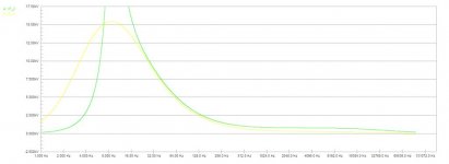

Just for your info. Finaly figured out what the 221k resistor does. Like someone said earlier,bias. It creates a stable DC bias point for the whole circuit. Its a DC error correction circuit. If the first stage bias current increases (say from temp) the second stage current decreases which decreases the final stage current which lowers the collecter voltage which decreases the base current of the first stage.
The drawback to this is the large 10hz peak if the inputs not the right impedance.
Hmmmmm,That explains why the peak disappeared in I tried the extra filtering as atmasphere suggested.
But is this the source of the noise? jer
I dont think so. But that much gain at 10hz in an audio circuit cant be good.
The DC resistance of the head stack is 192 ohms.
Thats fairly low, my sim shows there will be quite a big peak at 10hz with that value.
Well tape heads like loudspeakers have very different impedances at audio frequencies than their DC resistance. So its possible that the actual impedance could be several times higher.
There is probably an interaction with the input capacitance as well. This is why I was favoring the idea of a JFET at the input- the input capacitor could be eliminated in favor of a resistance to ground, which would help reduce 'head bump' which often shows up at bass frequencies. The only problem with this approach is that the original circuit has no such provision which suggests that the designer did not regard it as a problem and so its part of the sound of the instrument (if audible at all).
The other problem with that is coming up with a JFET that is actually any less noisy!
That was my original assumption but playing with the inductance values of the head made little difference in the sim. The freq (10hz) is probably so low it takes a huge inductance to make a difference.

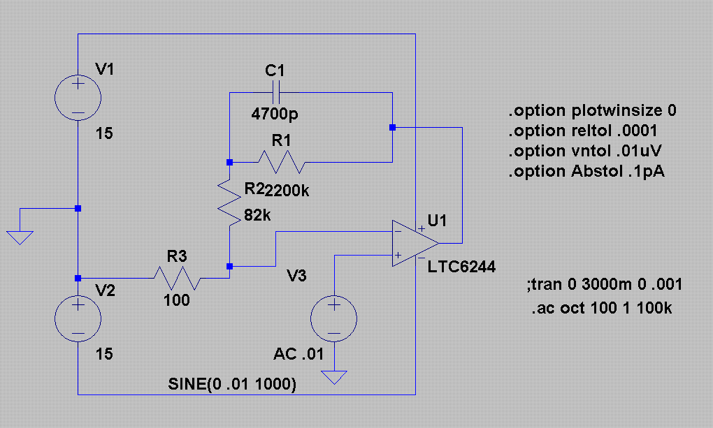

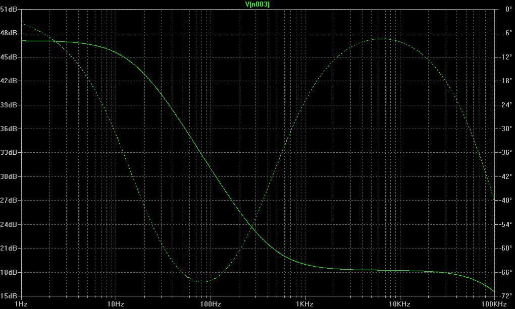

Here is what I have so far.
I don't think that the HF drop (slope) is significant to worry about.
On certain values of the 47k resistor and at 82k in the feedback loop this HF drop sarts at around 4.1khz, But the drop is very little like maybe around 1db to 2db (if that?) and flattens out as the resistor is reduced.
I still get the KV readings on the output(?).
But at least the LF slope matches the original and is very critical of the input components and the .0047uf capacitor in the feedback loop.
It is not a final draft, But it is a place to start. jer
That HF drop is due to the opamp losing gain at HF. If you can try a higher freq opamp that will probably flaten that out.
I was refering to the HF drop in the transistor circuit.
Even though those are older type opamps I have used them to buffer video signals aswell in the past.
The bass boost from what I have been reading is the NAB eq and this curve changes when the 100 ohm resistor is increased, and, starts to look more like NAB eq.
So I'm hoping that this will match up when hooked to the many heads.
As the input loading will change this.
Only if we knew the values of the tapeheads?
Right now this circuit needs another 2X gain to be an identical output level to the transistor circuit.
