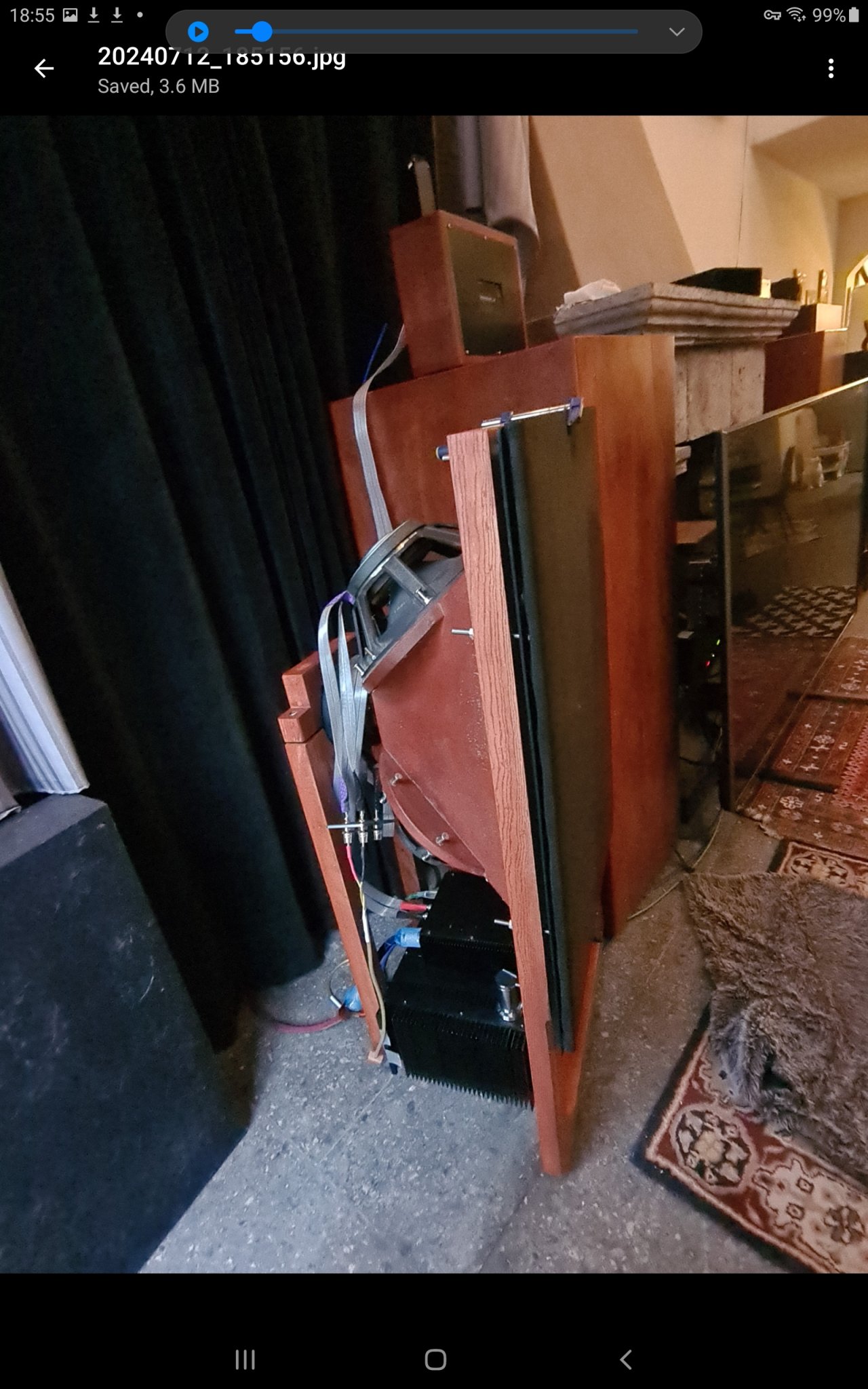

Current config with plate amps on top of the f20 subs (still need to solder the connectors for the vu meters), and finish my new dual channel mono amp cases..

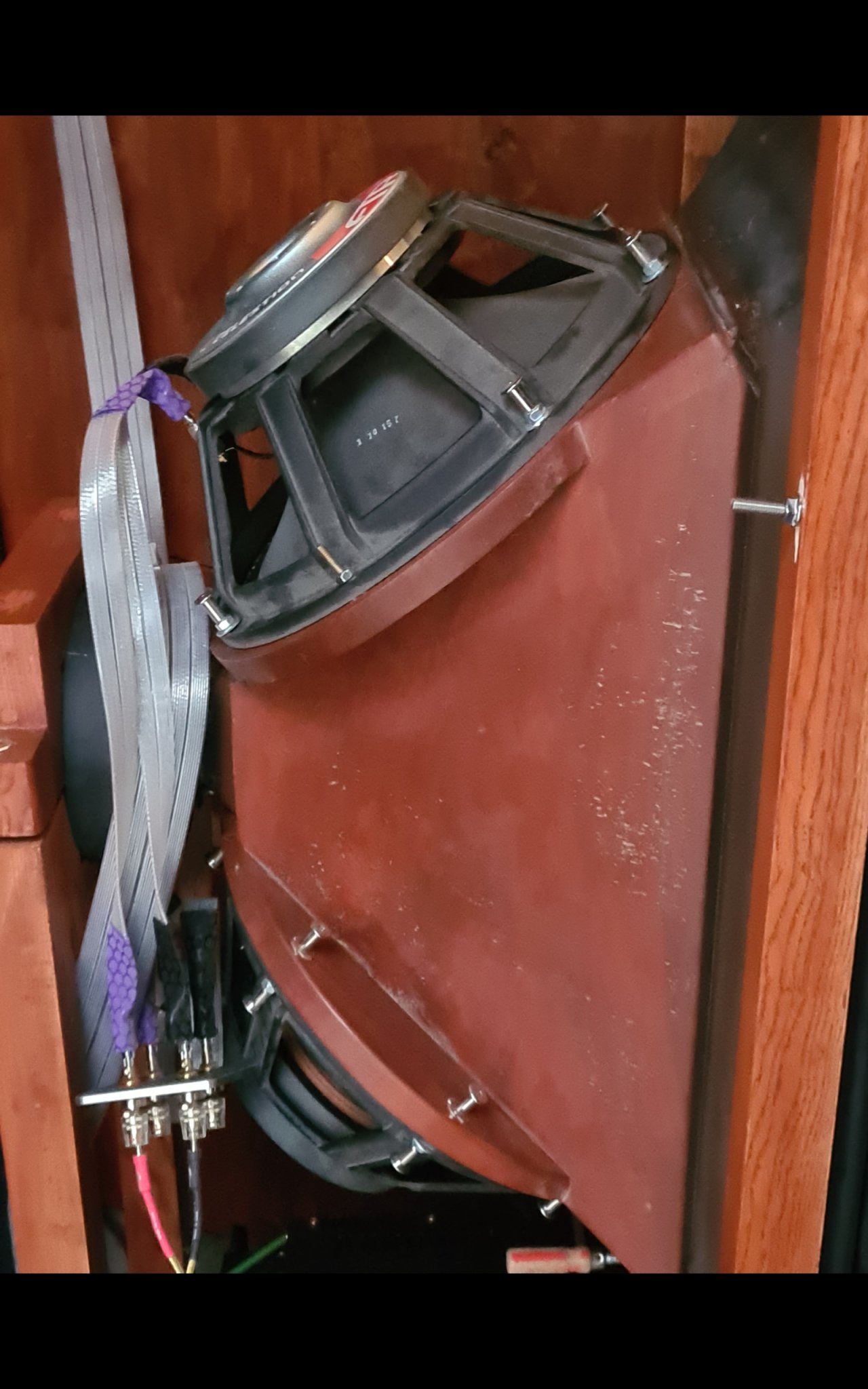

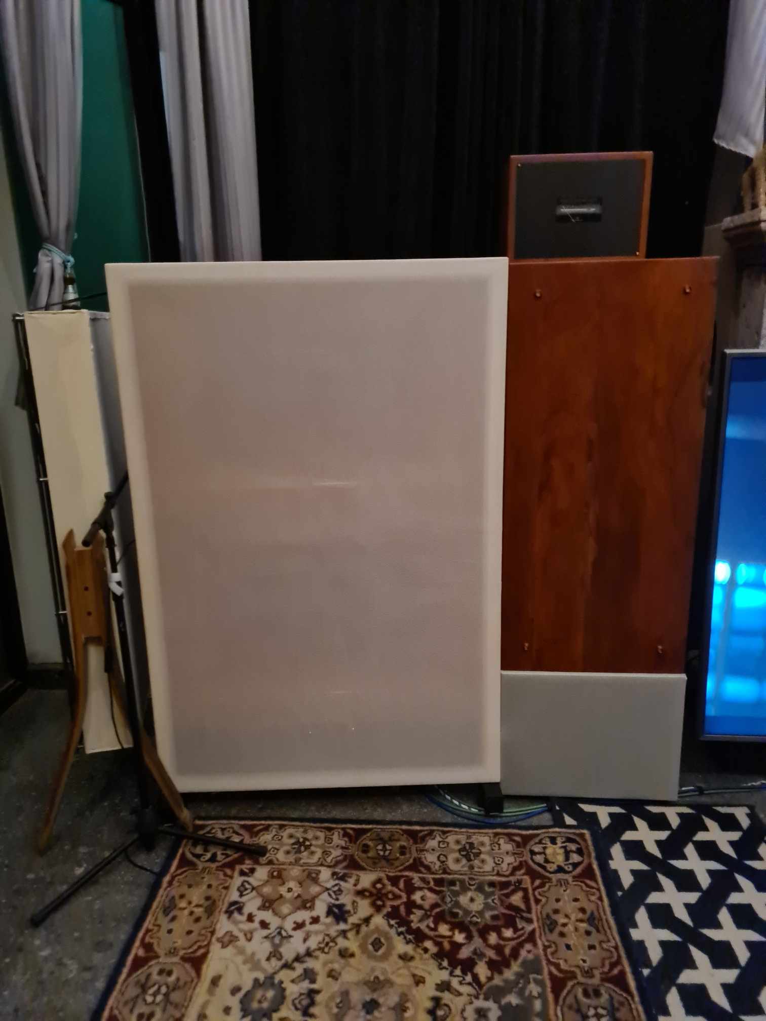

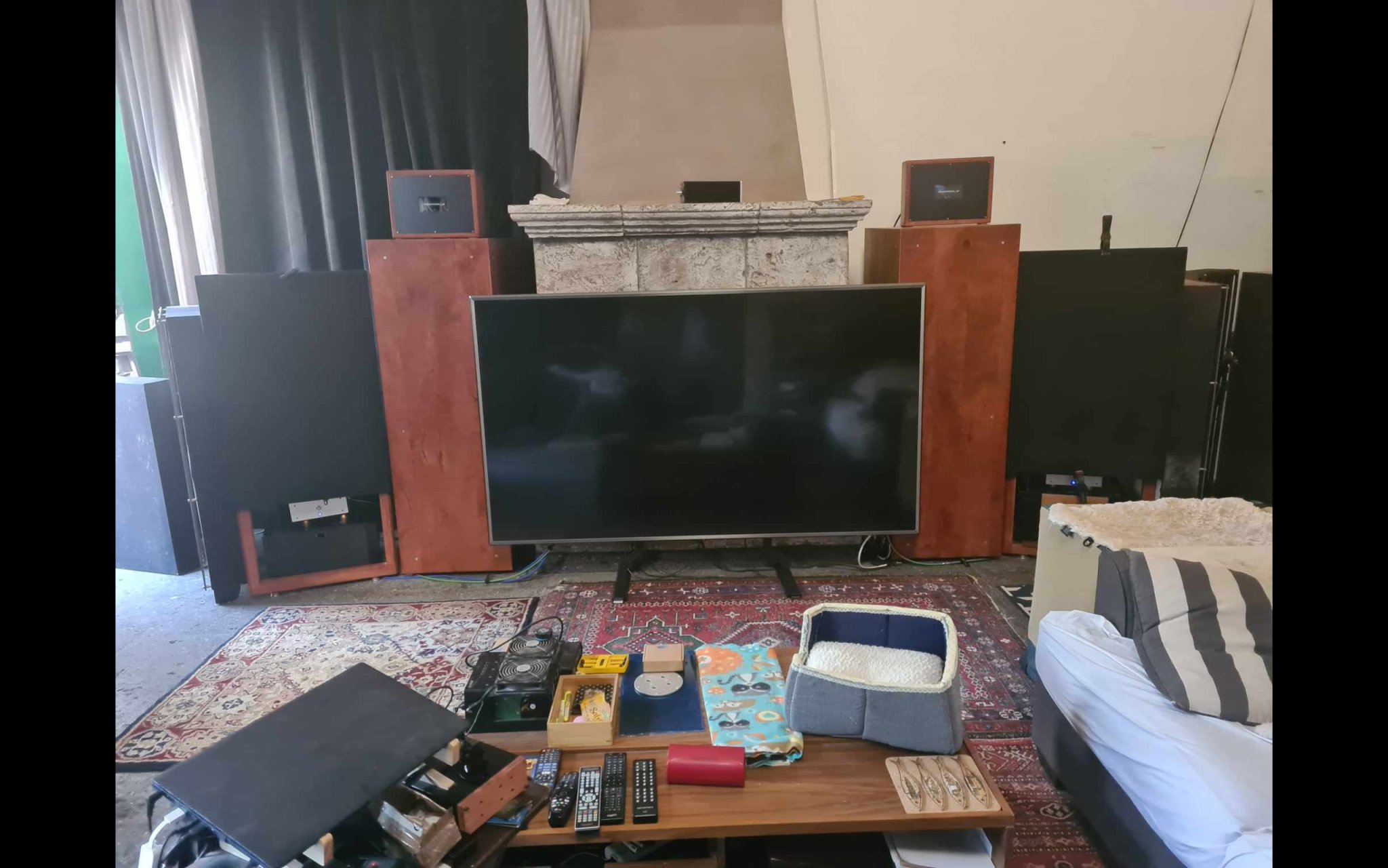

Setup is now a 3 way, with dual k402MEHs per channel and a Lilmikes f20 per channel. Only the top horn has a comp driver and a pair of 15" woofers..the bottom horn has a matching pair of woofers (no compression driver). 4 15ftr3070c woofers per channel and a Celestion axi2050 per channel. Signal is split on the output of the Xilica for the mid 15" Celestions with each pair having its own Fosi v3 monoblock amp.

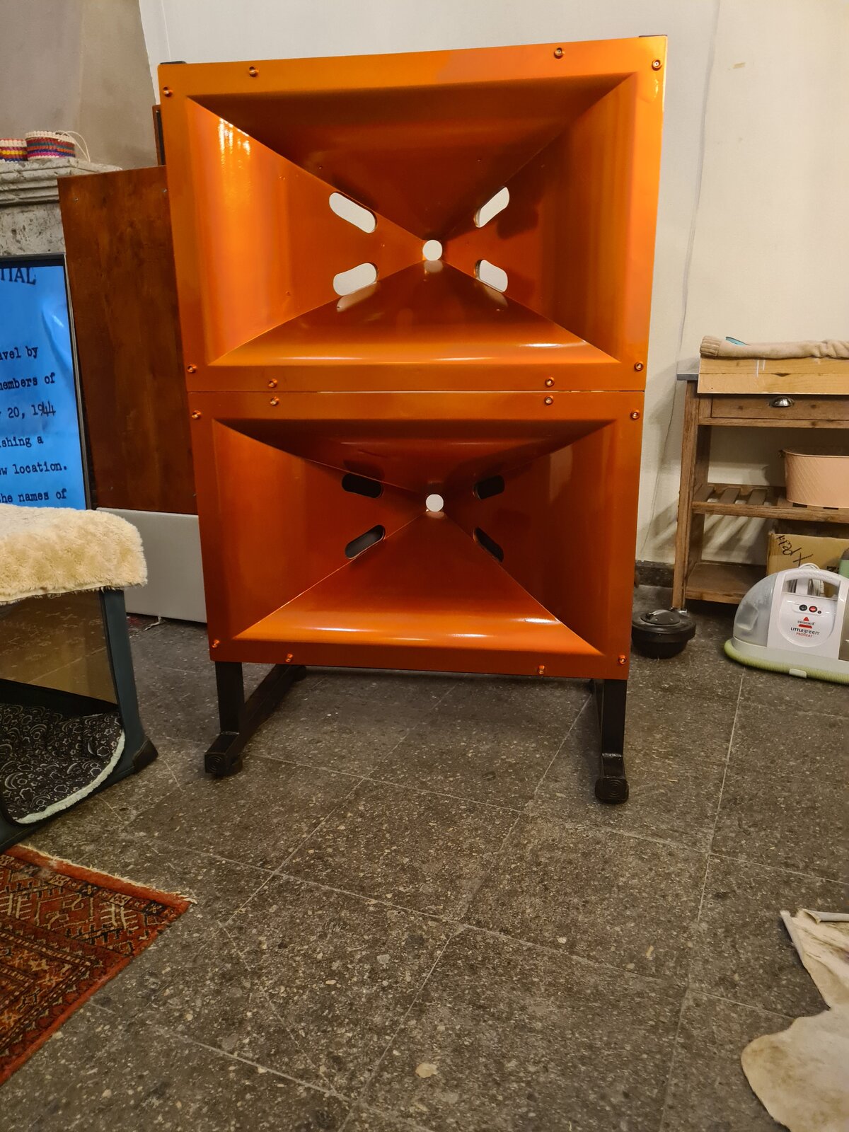

I just had a AI do a comparison of how my original MEHs would have sounded with the F20 horn subs (ALL comparisonswere with the same drivers I am currently using). I also had it compare with a conventional speaker design, horn with out cabinet, stacked identical horns (with only one comp driver) with and without cabinets, with one with a cabinet, and one without configured as one channel, I was surprised on how much more spl there was with a horn vs conventional speaker as well as some other advantages and disadvantages of each type I had AI compare.
when we move I am going to have cabinets made to protect them during shipping. When we get to our destination.. I will also try with both in cabinets and one in cabinet.
