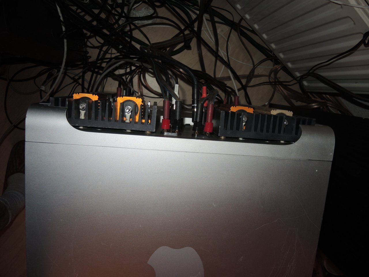

Meet "Fritz der Netzverteiler"
The cases are G5 MAC PRO, buy these very cheap and then modify them.
Inside no more, all Modified, sides Modified, Back Modified
Running like a champ..
This one when running in high Power Mode takes 700Watts Idle..
Created a new one, still working on it, takes only 40Watts per Channel Idle up to 5 watts, but can deliver about 70 Watts on 4 Ohms an uses 200Watts / Channel, when finish.. and can deliver 100 Watts Class A Power on 2 Ohms, without excessive heat. Also no FANS used,.. Mr. Pass helped me a lot, with ideas..
But still takes some time, Prototype runs perfect.. PCB number 6 will be assembled and tested soon, though the hole, with Bungard Rivets and tools. PCB's..

You see only 1 Fan..
Another 3 are in the Middle underneath that Aluminum cover.
One is sucking air in from beneath the bottom which is 1.5CM above ground..
The other two fans blowing the Air out to left and right cooling down these
Active Heat Sinks..
The one fan you see blows hot air out.. generated by the Power supply
Each Fan is single controlled with Voltage Regulator..
Transistors are mounted underneath 6 MJL4281AP per side.
Vrail +- 37.5 volts Idle Current High Power 3.75Amps per Channel..
RE= 10 Ohm 400 Watt mounted at the back..
Bandwidth 10 - 100Khz +- .2db
Max Output Power @8Ohm 28.5Watts / Channel
Distortion Max @28.5 less than 0.5 %
Distortion Max @ 1 Watt Less than 0.08 %
Max Heat full Load or Idle, 80Degrees Channel Active Cooled
Wait for my new Variable Current Source Class A
Takes only 40 Watts Idle or less Per Channel..
up to 5 Watt and only then it will draw more current
I'm testing the prototype for 5 months already
2 Ohms load no problems
100 Watts @ 2 Ohms also no problems.
But the major breakthrough is that this AMP will not heat up when in IDLE
Using two Current sources - which will work depending on voltage drawn by the amp when Input signal is increasing.

That's possible, I'm not sure of that one, but this amp does not work similar to that Floating class a.. Again this uses a Current source which feeds the Single End Output Transistor, and the Single End Output transistor it self also fed with a Resistor which creates a Current Source Bias *From Negative Voltage*, so the actual Current Source Transistor can be reduced by more than 70% to feed the Signal Single End Output Transistor With enough Current to work with..
BTW. The bottom underneath the fan is cut out..
You can not see Vent Hole, it's because the flash of the camera light up the top of the amp below that one,,

Very nice done. Wouldn't it be better to make some slots for ventilation/cold air under the fan?

But to give you an answer to the above question, check THIS out here. that's out of the construction days in 2020.. Again the front Fan is blowing air out of the case, creating a AIRFLOW underneath the case.. helps the Active Heat sink Air pull Fan to get better ration to suck in air..
