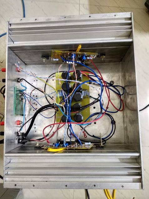

Finally after continuous 10 hours work I re assembled on PCB and removed spaghetti with P2P on vero board. Sound wise everything improved. Bass is good. I used LAN cable internal wires for internal connecting and Amp to speakers. The quality of copper in LAN cable is very good. I understood now what is Class A amp sounds. Now I am not hurry to build F7 until my Aeleph 3 broke. Special Thanks to Mr. Pass for wonderful design and Mr. Zen Mod for me in the right path. And Thank you to all members.

Sure Zen Mod, The heat sinks are high width so I am unable to do that.
@Extreme_Boky, Luckily My amp is dead silent :) when no signal and no hum.

what power supply are you using.. could not find it inside the box in that picture of your amp..
what is the type and dimensions of the heat sinks used..
