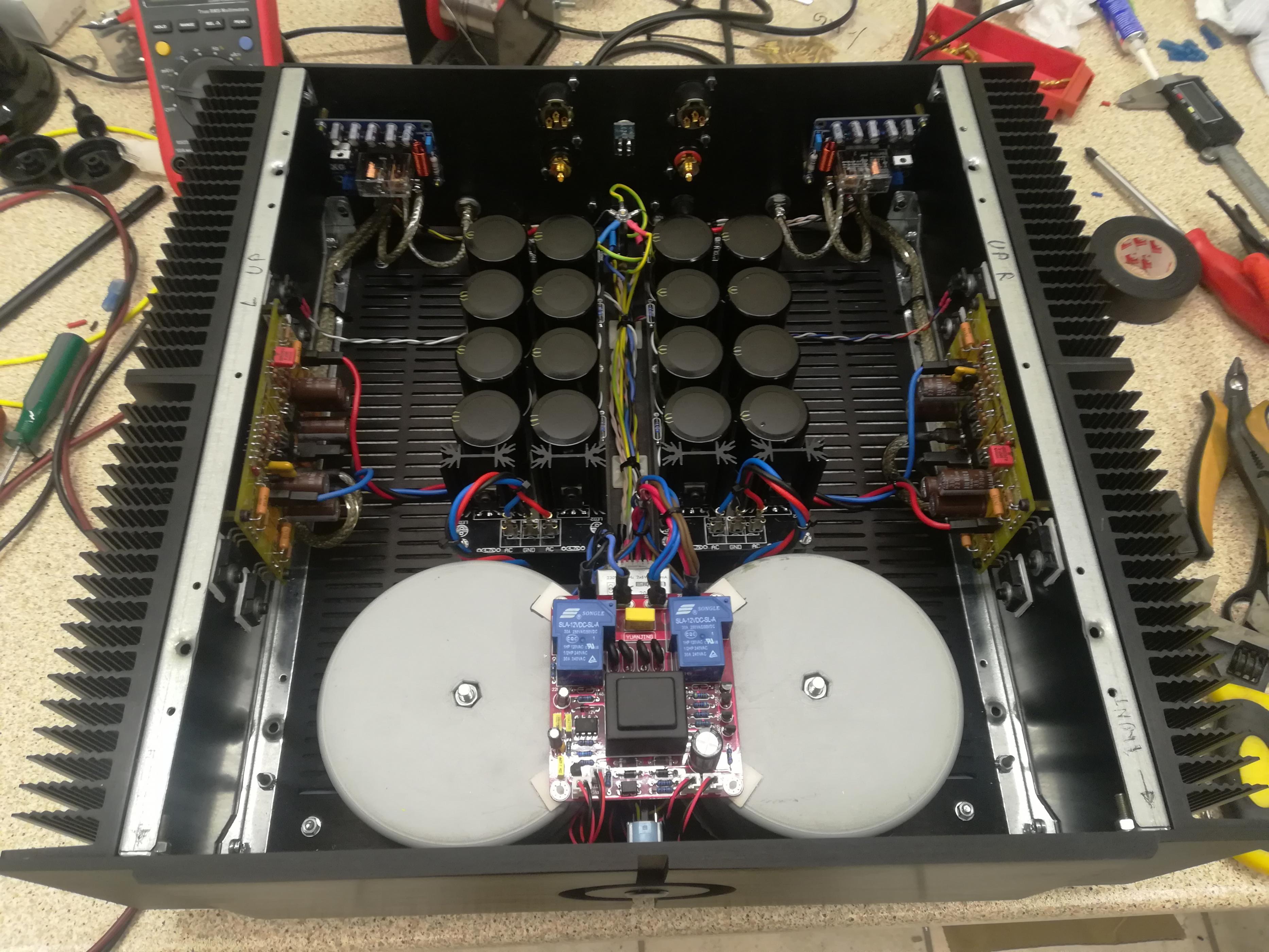

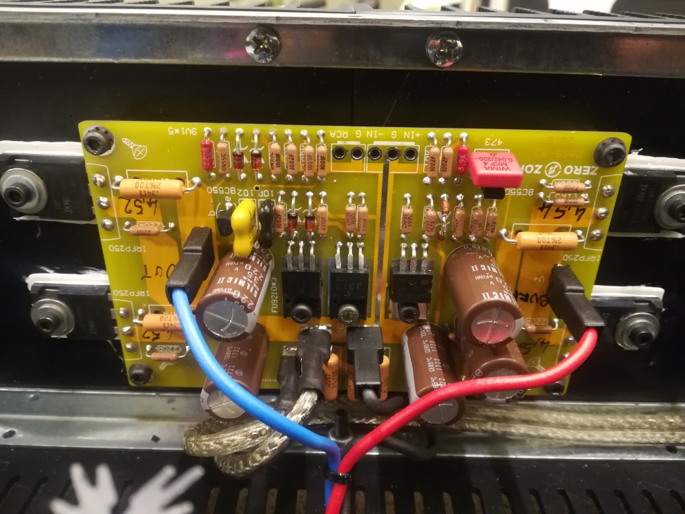

Hi guy !Yesterday i and my friends turned on the power amp and listened for the first time.
I must say that the first impression was disappointing regarding the dynamics and the extension towards the low range. I hope to be input to the psu that needs a few hours of break-in, otherwise I will have to investigate other possible causes such as the cell L C R on the speaker protector, or genuineness of the 2sj 313.
sounds like too much aleph CCS feedback , try 1K2 or more 🙂

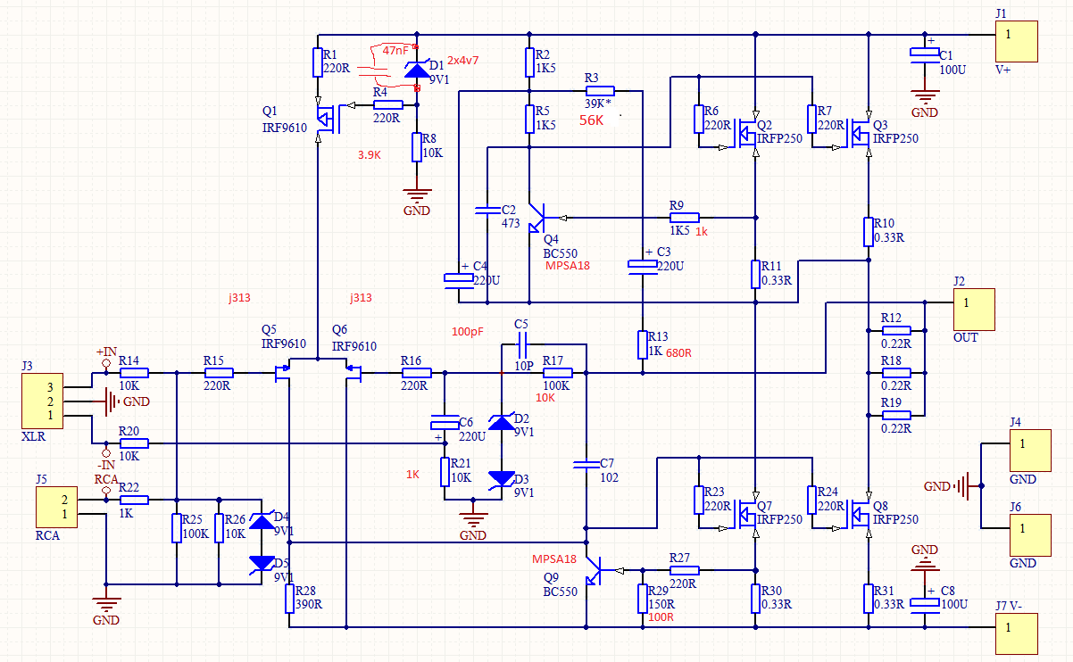

Please can you refer to this eletric diagram?

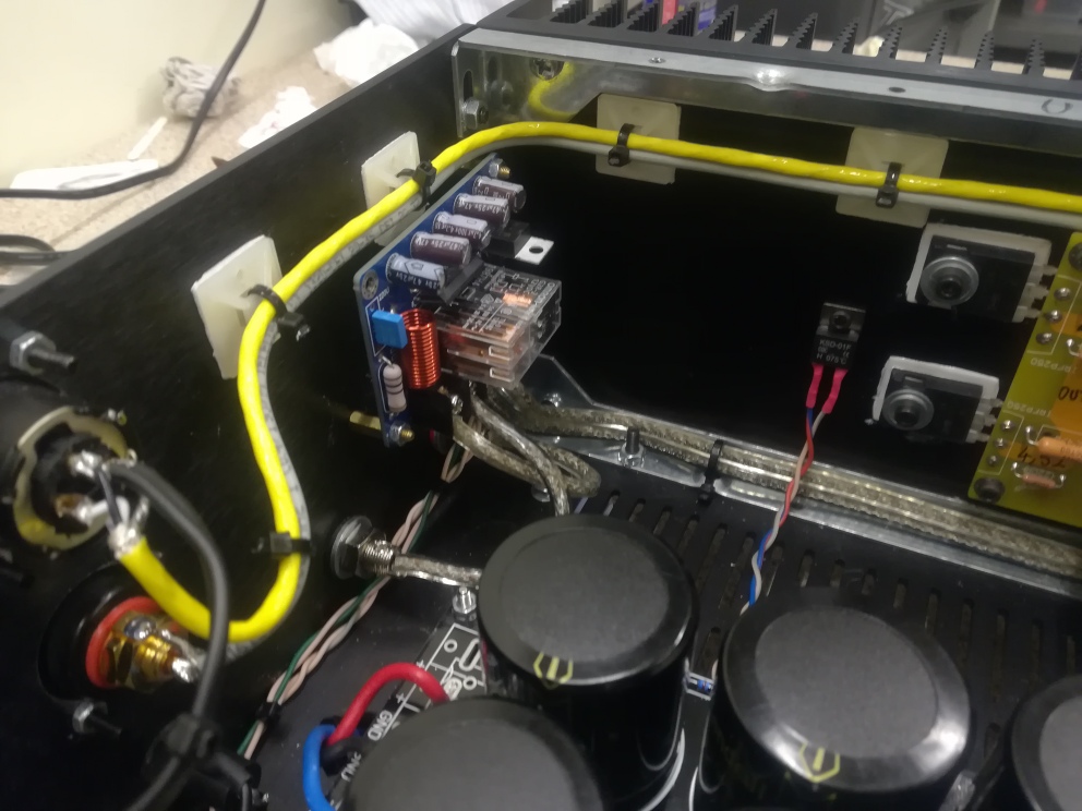

care to share some pics?
R13 you can try to increase it to 1K2 1K5 or just omit it 🙂
Doing so , i half the 4 OHM wattage.R13 you can try to increase it to 1K2 1K5 or just omit it 🙂
