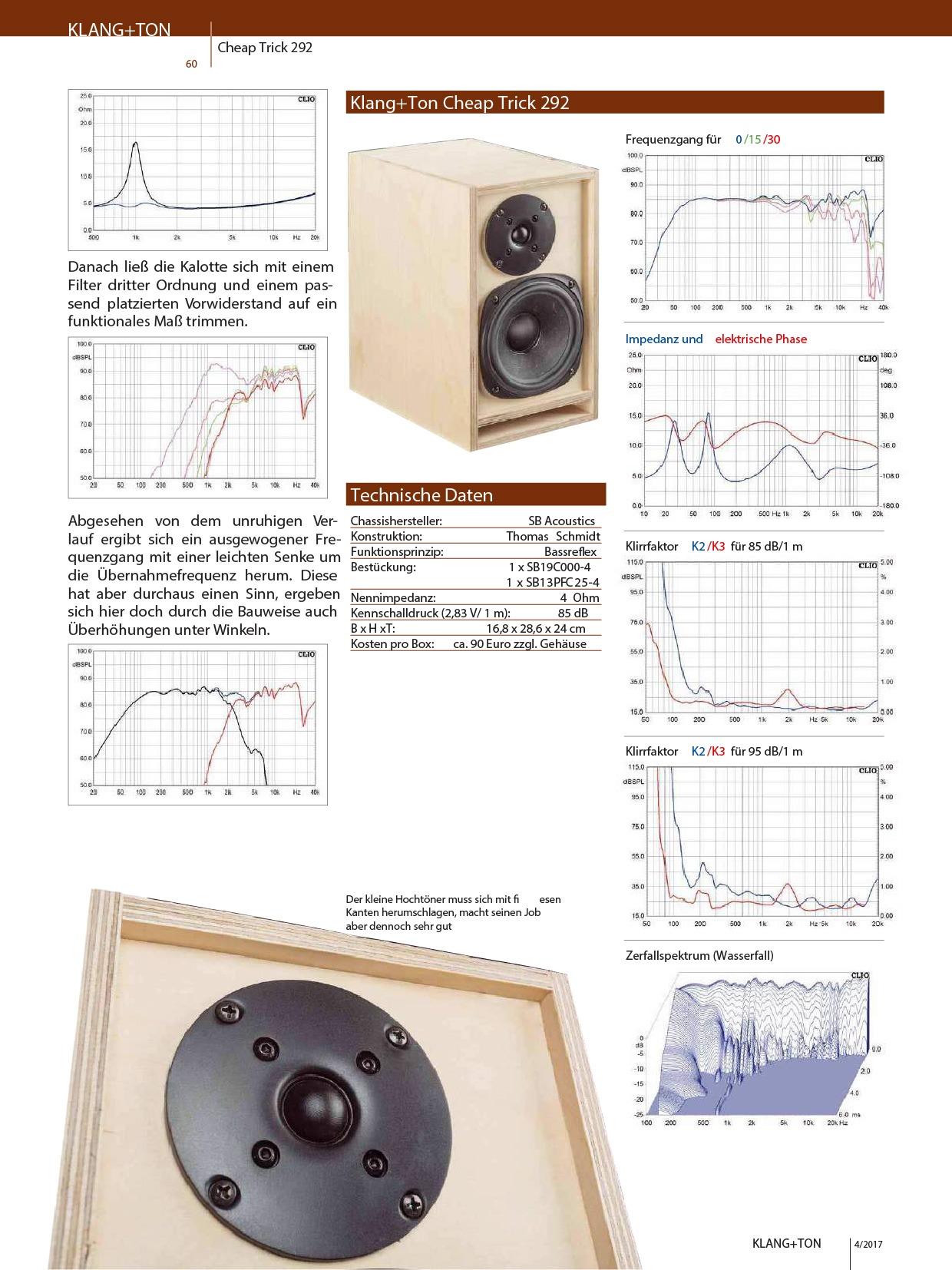

I was thinking about it this week-end, unfortunatly I also have doubts about reproducing your design, as my SB13PFC looks different even in the diaphragm material (cf: photo). Designing a box like yours, flushing the drivers would not be a problem but I also miss some impedance mesuring technology so I'm not sure to match easily your result.
So I'm still thinking... I saw another kit that looks closer with what I have in my stock (cf image 2), response and directivity does not look as sharp & accurate as your design but is well documented anyway... It's the CT292.

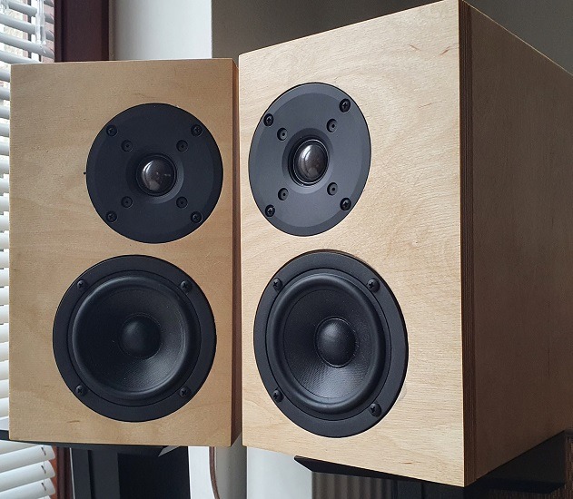

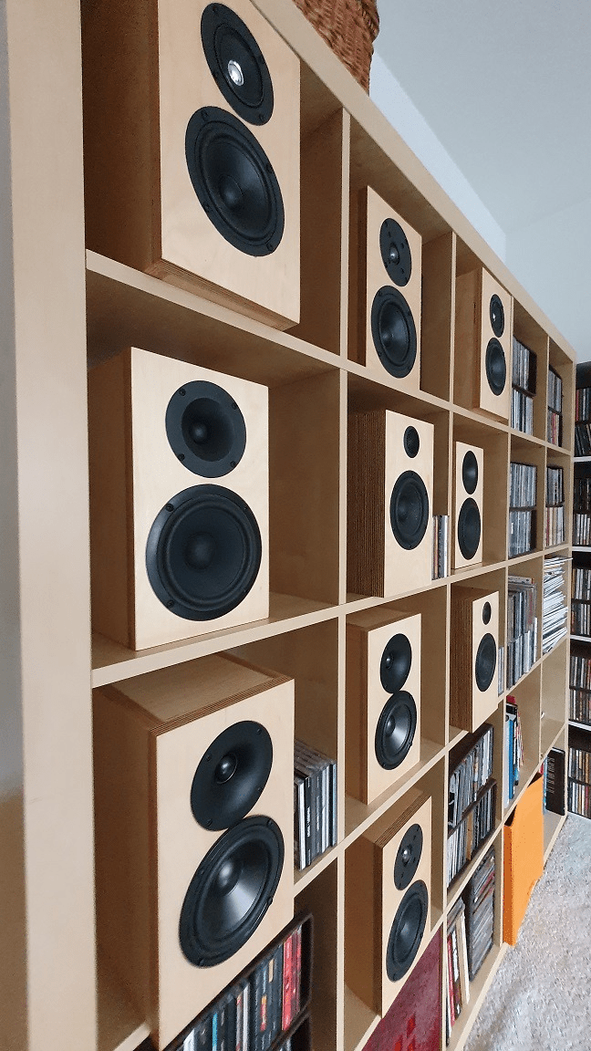

The main theme of the Mechano series is to match tweetr and woofer directivity to obtain linear dBspl and PR characteristics.
The first design was a Mechano (no number) with a 13cm Satori driver and a regular Seas dome. To get closer to the assumed goal, the crossover frequency had to be raised to 5kHz. The conclusion I took from this design was that to achieve the goal at lower crossover frequencies, the dome must be equipped with a WG or a horn or something that increases its directivity, or the midwoofer must have a smaller diameter (which reduces directivity). The next attempts were as follows:
-Mechano22 dome integrated with WG fp=3.6kHz (midwoofer 13cm)
-Mechano23 dome integrated with horn fp=3.4kHz (midwoofer 15cm)
-a design with a paper cone tweeter (not "promoted" to Mechano series) fp=4kHz (midwoofer 12cm)
-Mechano323 (3way) AMT fp=4.4kHz (mid 10cm)

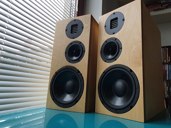

Here is another design in the series, Mechano24, using ScanSpeak D2608/913000 driver, i.e. a dome with a profiled front. fp came out as 3.7kHz.
The midwoofer is 12W4524G00.

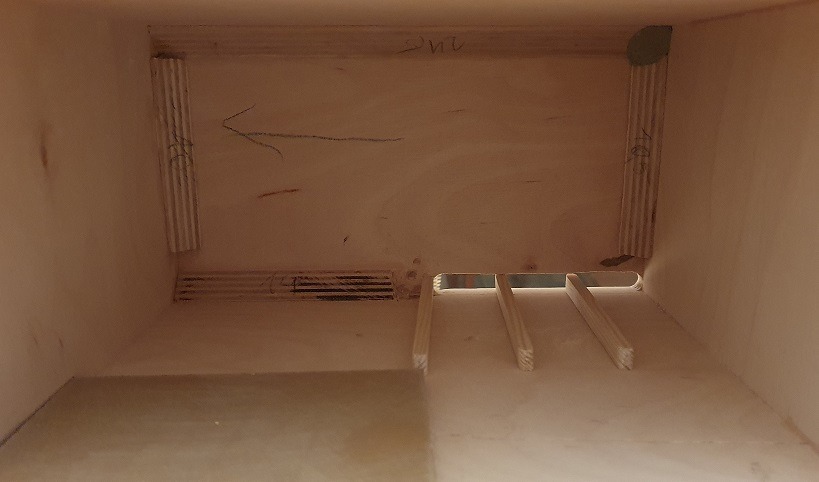

Enclosure dimensions: HxWxD: 290x174x263mm, polyester fiber filling.

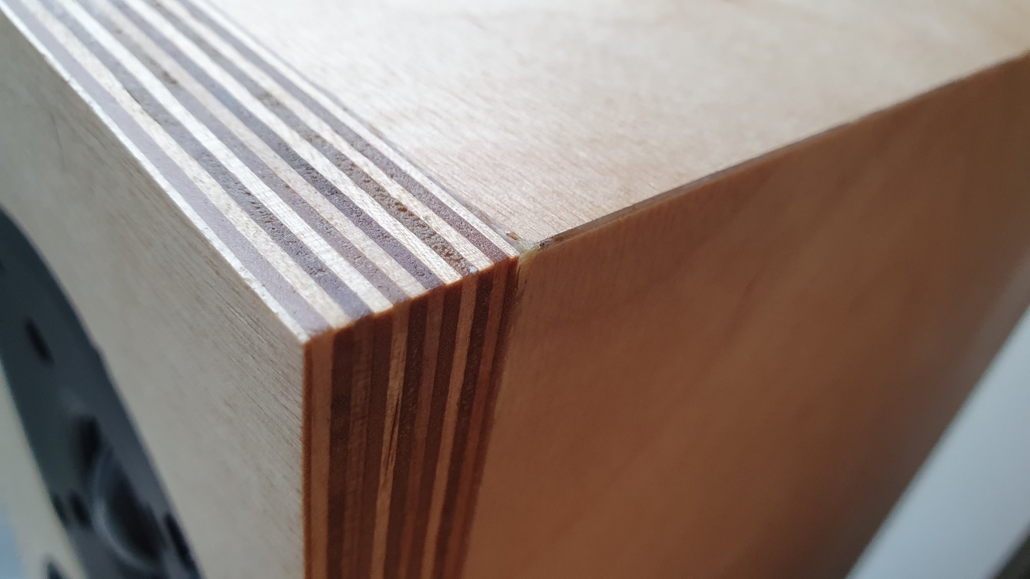

18mm birch plywood, front panel glued "on top".
Rear panel flushed into the enclosure.

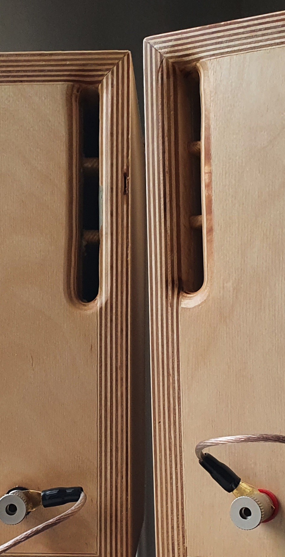

Bass reflex 8l, 45Hz. BR tunnel made of a piece of HDF glued on slats.

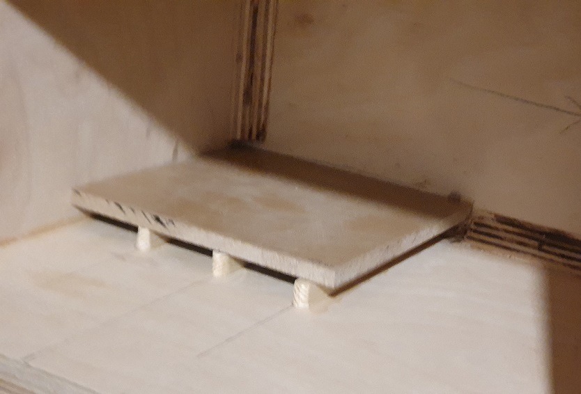

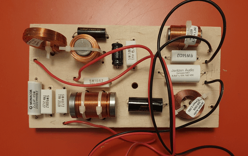

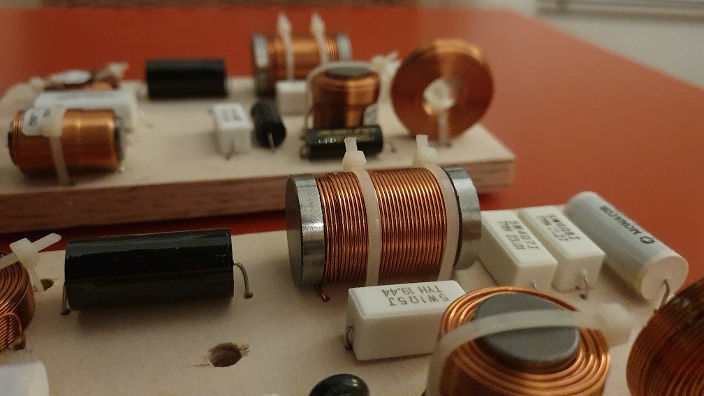

Crossovers assembled on a plywood scrap, attached with screws on an anti-vibration pad to the rear panel (installed through the woofer mounting hole).

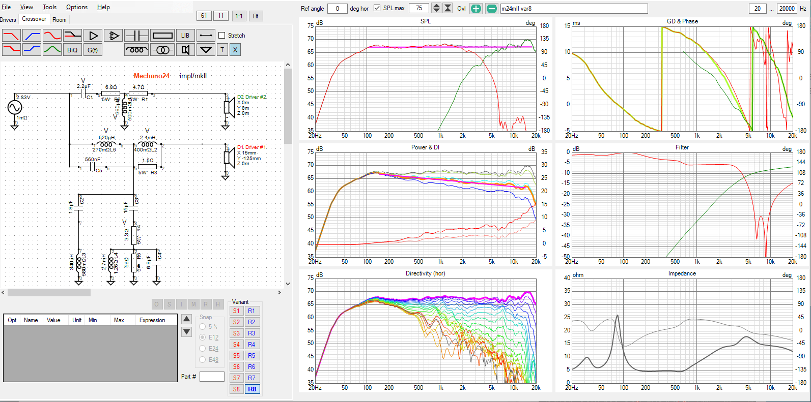

Crossover schematic and the characteristics, rating 6.78/8.81(EQ9) 6.133/7.57(EQ10)

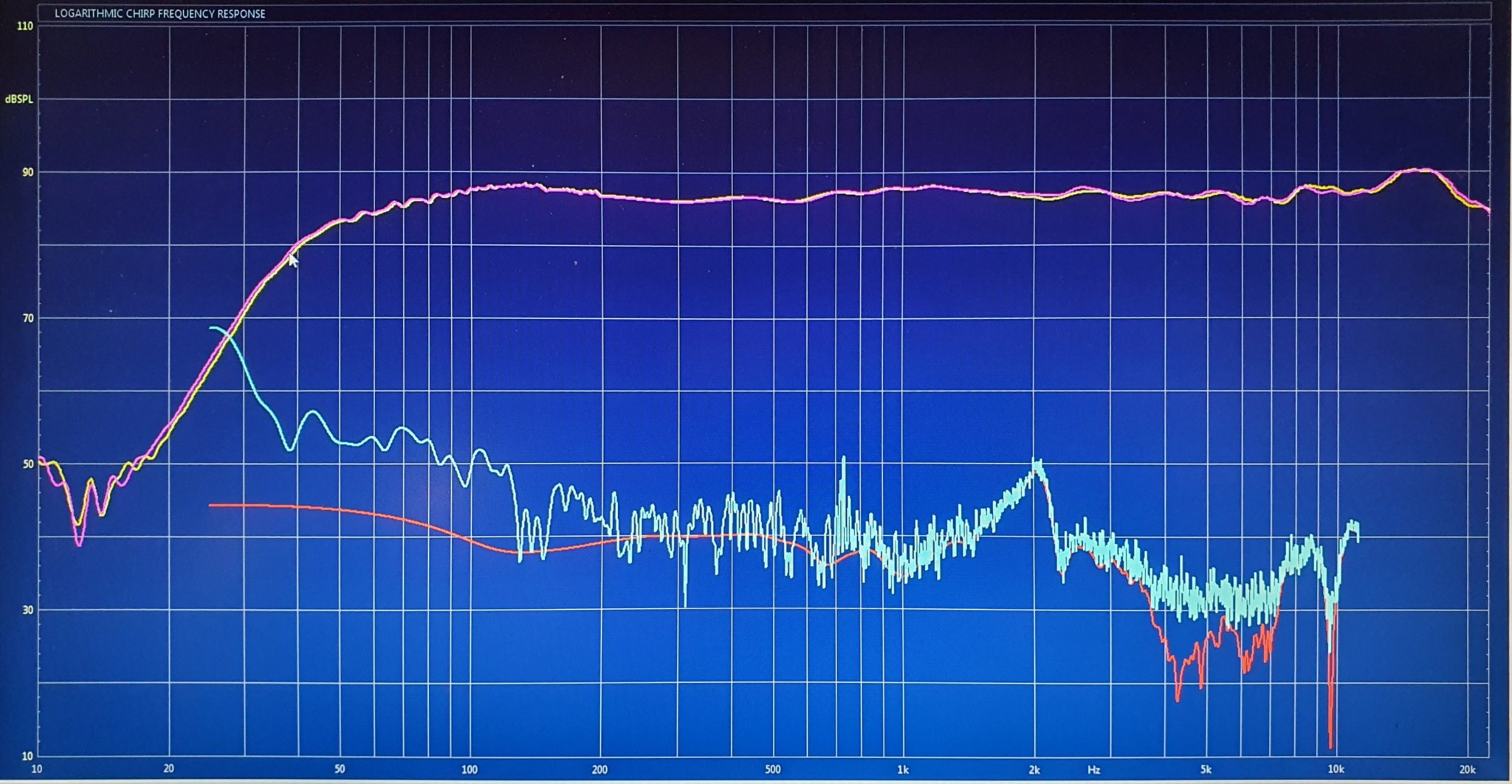

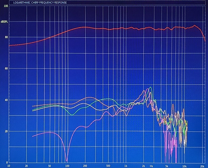

THD measurements: ~1.4% peak at 2kHz (87dB/1m)

Thank you. Actually I don't think they look nice, in fact they look ugly to me! Maybe that's because I don't like asymmetrical driver placement. I tried this with my previous (3-way) design, noticed some pros and decided to try it also with Mechano24 2-way design. When I finished cutting holes I realized that I should have left at least midwoofer on the center but it was too late.
On the other hand they sound pretty good. The 2kHz THD peak is not noticeable at least with the spl levels I'm using. Bass extension is impressive for a 12cm driver (f6=43Hz if I did all the merging correctly) although seem a bit shy in the level domain. At first I was tempted to try some EQ, but after listening for a while I concluded that everything was fine and stayed with the Source Direct setting. The picture is clear, crisp and analytical.

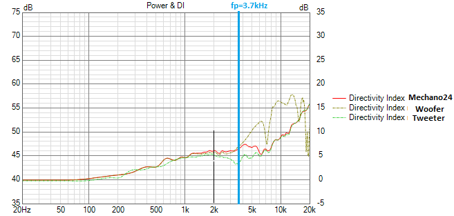

Very nice indeed. Looking at the D.I., am I correct in assuming with such a high x/o frequency it is basically woofer off axis behaviour south of 5kHz that determines the relatively flat D.I.? Or is this assumption wrong?
The following chart shows comparison of DI for the tweeter, woofer and the resultant. Crossover frequency marked with the blue marker (ignore the 2kHz marker). Below 3kHz the DI is approximately woofer's DI, but in the 3-6kHz region, DI is a resultant of both drivers.
BTW, there is a DI flaw in the 6kHz region but it's not very problematic. As a result it makes small local spl dip and fraction-db rise on PR. The rest of the characteristics look unaffected (In-room response, ER, Listening widow)

I can confirm that all these designs have a similar sound profile. Although they differ in details. For example, the last design, Mechano24, seems to me a bit more bright and analytical, and this is reflected in the characteristics: the bass does not go even 1dB above the mid-range tones before it starts sloping, and the dispersion of high tones is a little wider. But overall, the sound of these projects has a lot in common.
