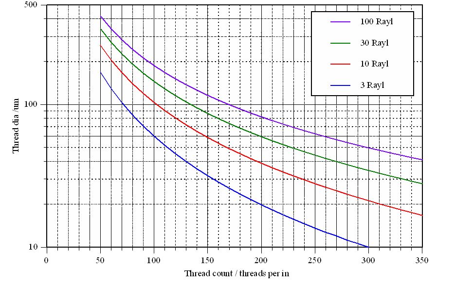

There is a company called Saarti that sells acoustic mesh with specified values for the acoustic resistance. Using their specifications I assembled the following chart - hope it helps. It should work for any mono-filament mesh like screen printing mesh, filter cloth (eg for flour ), etc. The equation I used to assemble the chart gave the saarti numbers within about plus or minus 20%.
The damping required depends on the size of panel and the resonant frequency of the membrane, but it should be between 20 and 100 rayl, probably close to 40 or 50 is a good starting guess.
As Bolserst advises, the cloth should be as close as practical to the stators to minimise the effects of reflections on the frequency response. Quad glue their cloth to the inside surface of stators. Of course this blocks >50% of the holes in the cloth, so the resistance goes up by > 2 X.
The cheapest source of mesh I have found so far is aliexpress - wide range of thread counts, suppliers and sheet sizes.

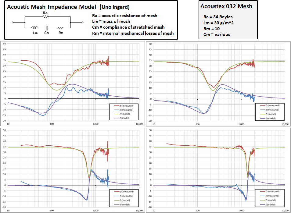

@ silvershadelynx,
Regarding the apparent contradictory statements concerning the mesh damping ability…note that there was 8 years between the statements you linked to in which time I learned a lot about testing the mesh and theory behind what parameters of the mesh affect the acoustic resistance. For example, two different 200 count mesh samples may use different thread size resulting in different pore sizes and mesh thickness and thus different acoustic resistance. I did not fully understand this back in 2009. Follow-up information on the original 200 count mesh I had tested was posted here: Another segmented ESL
Even the best theoretical formulas available only give an indication as to what the actual acoustic resistance of a mesh might be. The trend plot golfnut posted based on least squares fit to published measurements of Saarti mesh will give a good estimate of what to expect. But, the only way to know for sure is to measure it. I will let you know what I find out for the 120T mesh. I’m expecting it to be somewhere in the 30-40 Rayl range.
I know it has been mentioned that the mesh needs to be mounted tightly to achieve full damping effectiveness. The reason for this is that the mesh acts like a porous diaphragm that will have its own resonance frequency. Above and below resonance, the diaphragm is essentially stationary and the air particles must flow through the resistive mesh openings providing damping. At resonance the diaphragm will move with the air particles and thus not require the air particles to make their way through the resistive openings, resulting in little damping. Attached is an example measurement taken in an impedance tube compared to Uno Ingard's model of the behavior for 4 different tensions. You can see that even though the mesh has 34 Rayle resistance, at resonance it doesn’t provide much resistance to damp the diaphragm at all. Increasing the mesh tension moves the resonance up in frequency so that effective damping is provided at lower frequencies where it is needed.
As golfnut mentioned mounting mesh directly to stators like Quad does will increase the acoustic resistance of the mesh by the reciprocal of the open air fraction. It also is an effective way to avoid the mesh resonance problem.

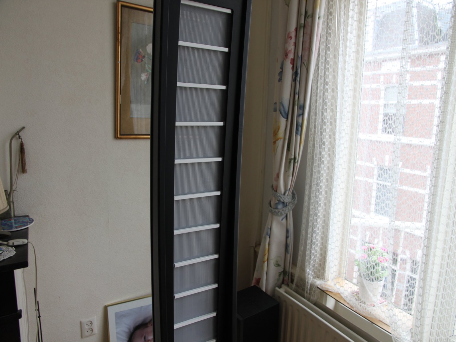

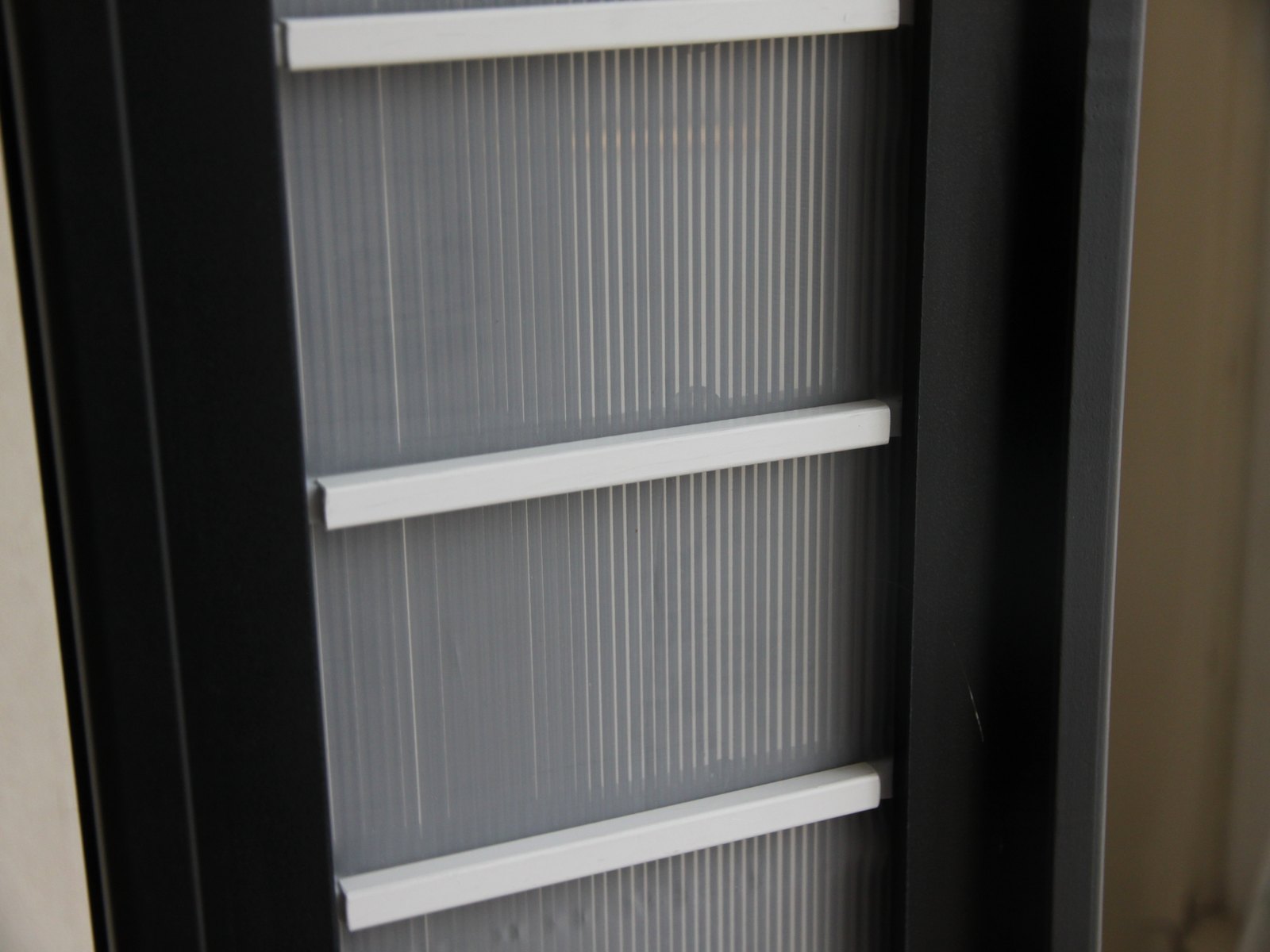

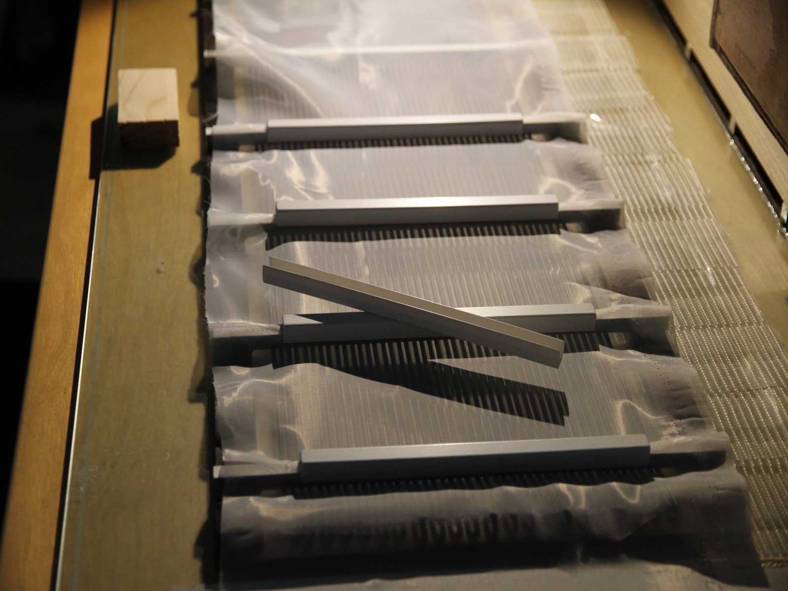

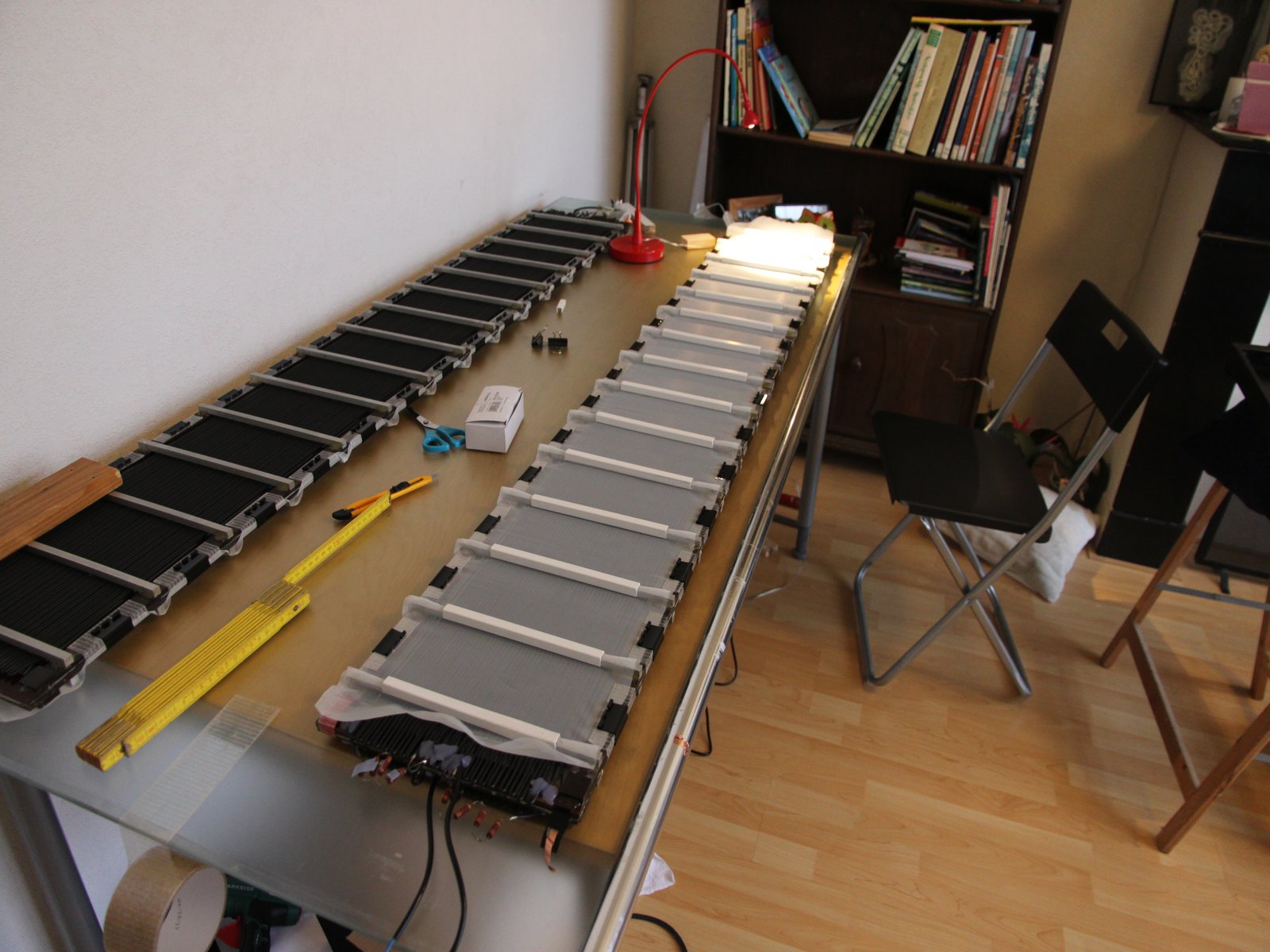

I just finished my Audiostatic ESH100 refurbishing project. Member Bolserst (knowledgeable and very helpful) inspired me to attach some mesh to these speakers so I ordered 64T 160 mesh from Ali. Problem was how to attach it as close as possible to the diaphragms. As you can see in the pictures the ESH stators are made of pertinax strengthened by aluminium crossbars.
In de 63 series and later Quad applied a mesh just behind the diaphragms. I decided that the most feasible solution here was to apply the mesh just over the stator wires.
So the mesh had to be tightly stretched in length and width and then firmly attached to the stators. For stretching in the length and fixing the mesh to the stators I found a plastic u-profile with a tight fit on the aluminium bars. For stretching in the width I could kill two birds with one stone. To join the two stator halves I used spring clips that people use to bind loose papers together.
To prevent HV leakage I put some tape under the clips. At the same time I use tape and clips to fix and tension the mesh. A lot of words but I think the pictures will clear it up.
One problem though. Although it was a nice finishing touch to my refurbished speakers which btw are sounding very nice I have no way to tell if I improved something as I have no measurement gear. Furthermore it's the first time in my life I've heard Audiostatics. Mmmm time to buy a measurement microphone ??

Good morning,
nice to see you managed to attach the mesh screen. I guess you listened to these stats before attaching the mesh screens to the panels? I would just add one screen to one panel and leave the other as is in order to be able to compare them? This is what I did to get an impression about different options and their results: measure and listen to modified and unmodified panels.
I find this an very interesing topic as I'm in the process of building my fourth pair of electrostatic loudspeaker panels: this pair will be the first pair where damping screen is intagrated in the design: I will attach it as close as possible to the membrane @ 1.9 mm distance, just between the membrane and stator wires.
I did listening tests on both my current big panels and an older pair of smaller panels. The mid / high frequency quality improved on the small panels after attaching a mesh on the inside of the back of the wire stator, but showed a slight deterioration at mid / high frequencies on the big panels. (slightly duller / less spacious sound) So it is unclear to me / hard to predict how the final result will be. But it certainly helped to improve resonance problems I'm currently facing.

A wise man would have done all the things you said. But I was too eager to finish the speakers. Furthermore I have no measuring equipment.
I am very interested in the building process of your speakers so please keep us posted.

Congrats on completion of your refurbishing project! 🙂
Unfortunately, without having a side-by-side comparison with one speaking having the damping mesh, and one without, it is tough to quantify how effective your mounting method is without measurement equipment. Do you happen to have an android smart phone or iPhone? There are several free measurement apps that could be used for this and considering the low frequencies involved you should be able to just use the built in microphone. There are also signal generator apps that you can use to do a low frequency sine wave sweep in bass range so you can listen and hear how peaky the resonance might be as you sweep across it.
