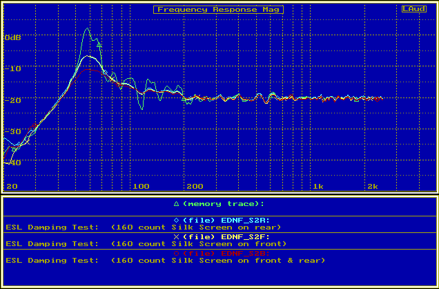

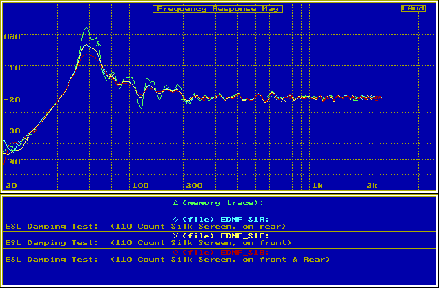

Silk Screen Mesh: Damping of ESL diaphragm resonance
I had ordered some 110, 160, and 200 count silk screen mesh, but the 200 count was on back order. So I have thrown some 1/16” felt in to the mix will I was in the measurement mode.
The 110 count mesh uses 78 µm monofilament polysester fibers (66% open area)
The 160 count mesh uses 64 µm monofilament polysester fibers (60% open area)

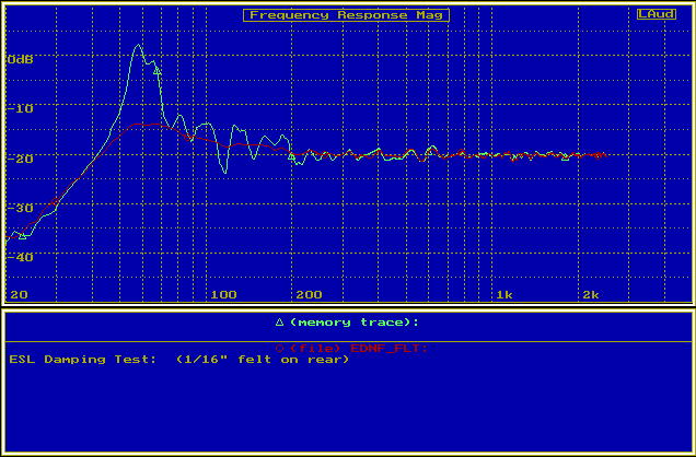

The ESL panel used for the test was 60” tall x 8” wide, with 2 rows of assymetrically placed silicon dampers. The undamped curves(Green) show a double bumped resonance peak caused by placement of the silicon dampers as mentioned by Capaciti earlier in this thread. Microphone was placed 1” in front of the midpoint of the diaphragm.
1) Damping results for 1/16” felt on the rear stator
2) Damping results for 110 count mesh, on front stator, rear stator, and both stators
3) Damping results for 160 count mesh, on front stator, rear stator, and both stators
4) Comparison of 1/16” felt .vs. 160 cound mesh.
As you can see, down to 80Hz, the 160 count mesh damps as well as the felt.
The 200 count mesh should be even better.

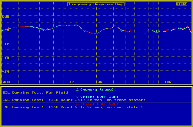

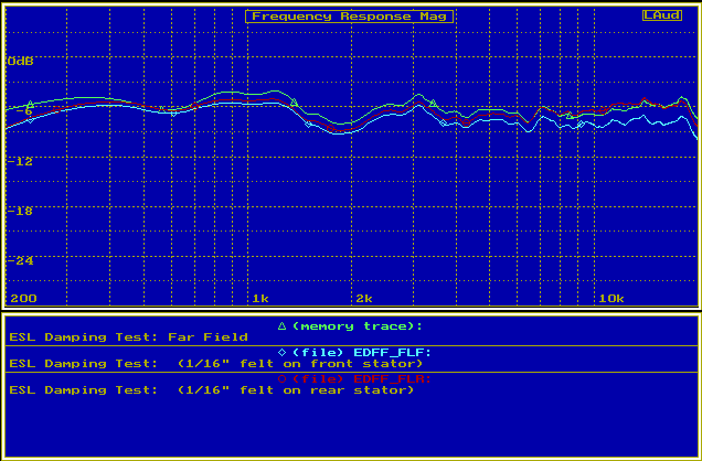

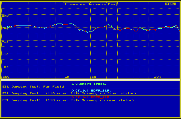

Silk Screen Mesh: Effects on High frequency response of ESL
Microphone was placed 1 meter in front of the midpoint of the diaphragm
1) Effect of 1/16” felt place on the front stator, or the rear stator
2) Effect of 110 count mesh, on the front stator, or rear stator
3) Effect of 160 count mesh, on the front stator, or rear stator
Felt on the front stator progressively filters out more with increasing frequency.
Felt on the rear stator is interesting in that it filters out the midrange but actually boosts the highs.(reflections from the felt? Or cavity resonance effect?)
Both of the silk screen meshes had essentially no effect on the response.
Thanks again to Atom666 for suggesting the silk screen. The results are much better than any other woven cloth I had tried, providing significant LF damping without affecting the HF response.

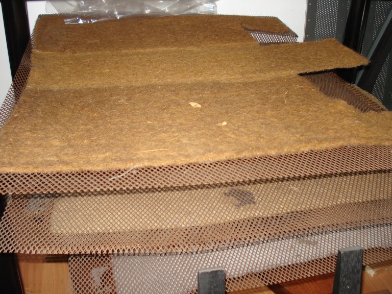

You are ill informed, Jarre.
The picture you show has the back grill removed. This metal grill originally has a sheet of natural fibre cloth on the inside (attached with a sticky tar like substance to the grill) which damps the main resonance peak of the bass panels. This is a simple fact, no point in arguing about it.
How do I know this? Well I've actually seen 'a couple' of Quad ESLs :D
Arend-jan,
When the grill+damping cloth are in place, do you know what the distance would be between the diaphragm and the damping cloth?
Would you happen to have any pictures of the inside of the back grill showing this cloth?

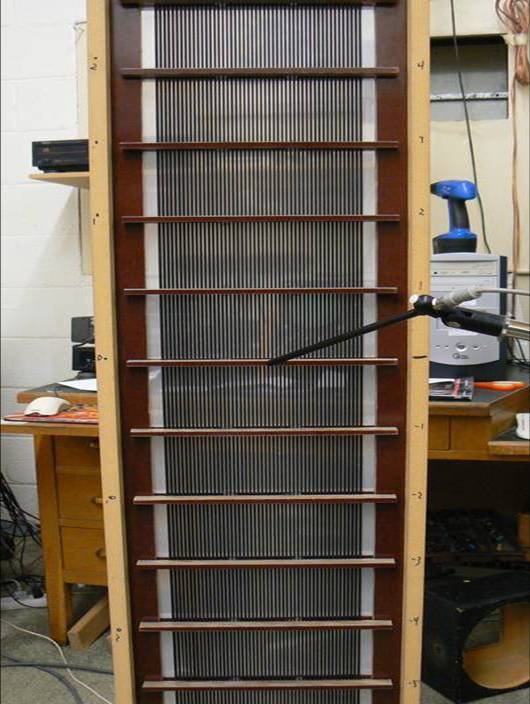

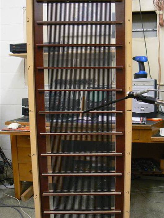

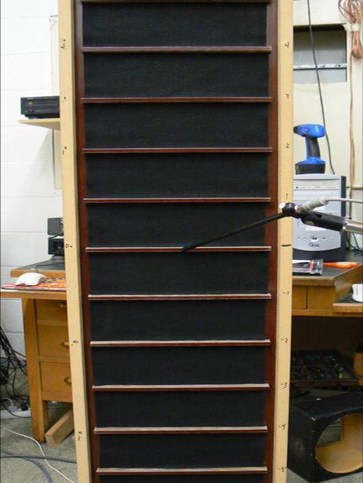

Do you have any photos of your test set-up of the damping materials?
I thought I described the setup pretty well in post #25 and #26 where I showed the results.
The testing was done on a panel similar in size and construction to those used by Capaciti and Audiostatic for full range ESLs.
" The ESL panel used for the test was 60" tall x 8" wide "
For the Near Field tests:
" Microphone was placed 1" in front of the midpoint of the diaphragm "
For the Far Field tests:
" Microphone was placed 1 meter in front of the midpoint of the diaphragm "
I'm not sure what additional information pictures would provide, but here are a few of the NF setup:
1) panel with no damping
2) panel with felt on rear stator
3) panel with felt on front stator
4) panel with mesh on rear stator
Hope this helps...

@Bolserst: If I'm correct you divided the felt in mutliple pieces - and put each piece in between two horizontal bars? I'm curious how you temporarily secured the felt to the stator - was it loose (not secured) or did you use glue or paper clips? And was the felt secured on the vertical bars on the right and left side?
Regards and thanks for sharing the photos and measurements.
Yes, I cut the felt into strips that fit between the crossbars. I attached the felt on the left and right side with common double-sided tape. For quick tests where I was experimenting with different amounts of damping on different areas of the panels I often didn’t even use the tape. With panels charged up, the felt or mesh acquires a charge that makes it stick to the stator wires.
Cutting up all the strips takes a bit of time with a ruler and a rotary fabric cutter.
Alternatively, you could user binder clips to attach a full length piece of damping mesh or felt to the cross bars as shown in these two posts.
http://www.diyaudio.com/forums/plan...ostatic-baffle-step-filter-4.html#post3476478
http://www.diyaudio.com/forums/plan...ostatic-baffle-step-filter-5.html#post3501562
