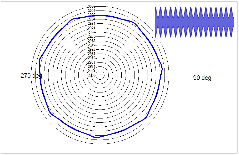

And to answer your question, Scott "Why three bins?" it's because the frequency isn't stable. I was able to make a wildly unstable signal, like an LP with the hole far off center, and it landed in multiple bins. Even a perfect tone right at the bin frequency spreads a little, depending on windowing and things.
You know that, of course, but it did look odd on my graphs. Just part of vinyl playback.

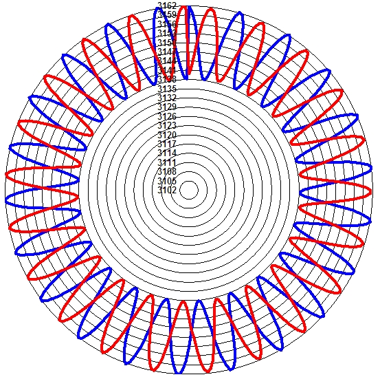

The radial plot is for part of the test suite George kindly recorded: a long 3150Hz tone designed to facilitate wow & flutter testing. So not strictly a part of the before/after 150 play tests, other than to allow us to examine FM/pitch stability for the Shure rig, which is good method anyway.
Happy to run those other radial FM plots for you, George, but the second link seems dead - would you please repost? I'll PM you when they're done, rather than distract the thread. I wrote this tool for myself a few years back, don't mind running a few every now and then.
Yes, pragmatically even with 128 point FFTs I used multiple bins. Partly because, as you say, test tone frequency doesn't necessarily tally with centre of a bin, and partly to accommodate real signals FM spread. This is fine and sensible, of course.

The flattening of the circle btn 4 and 7 o’clock shown by the diagram is something I notice with the in build stroboscope in this Kenwood KD-3100 turntable .
I have been given two Kenwood KD-3100 units and they show exactly the same platter rev instability. The Kenwood is not the TT I use for playing music though.

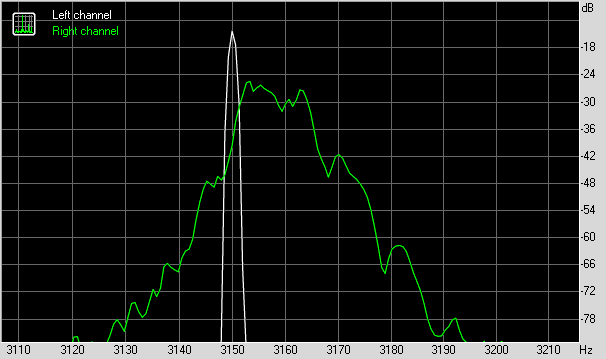

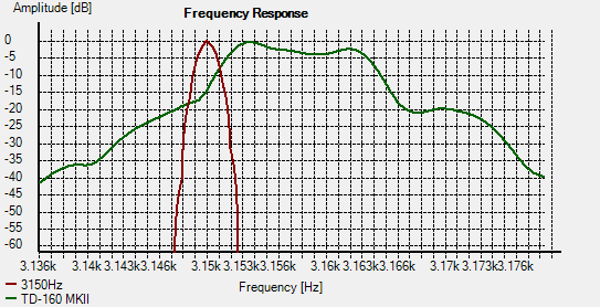

Not a polar, but here is your TD-160 vs a computer generated sine of 3150Hz.
The pure tone is mostly all in the 3150 bin, the TD-160 spreads from 3152 to 3162 Hz.

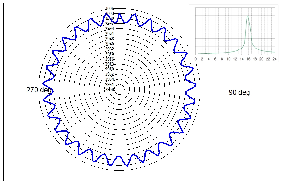

Avoiding confusion, we are talking about my polar plot 'instantaneous frequency' pitch stability software, of course. Which has good frequency resolution and precision because that's what it's designed for. Essentially, at its core it's a precision FM demodulator, and being FM, it cares not about amplitude of the test tone over a very wide range.
Yes it uses very short FFTs in places, and yes that's counter-intuitive, but the cute bit is the frequency detector, which I'm still very pleased with.

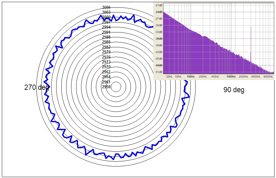

Attached are some old calibration plots, including in band AM rejection, adjacent frequency noise rejection, etc. And one showing real world shaft vibration for both the polar plot and conventional spectrum.
Michael thank you very much.
That spread equals to 0.3% (or +/- 0.15%). I guess it’s much, although I don’t know if that figure can be compared with the specified 0.06% W & F for that turntable (DIN 45507 weighted)
George
That's what I found and that's what I wondered. The FFT plot seems to show high W & F. But is it an accurate measure? I analyzed 1.8 seconds but can't tell if the variation is wow or flutter, or how much of both. Lucky's polar plot would tell you that.

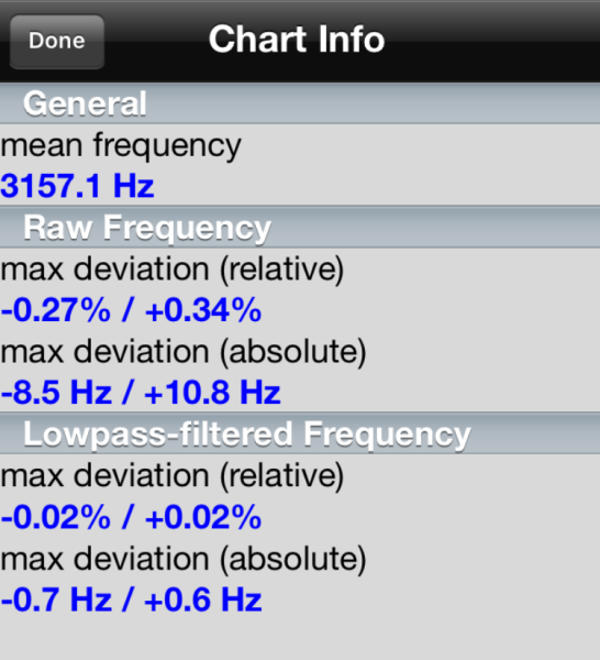

I forgot that I have the Platter Speed app on my phone. Played it your TD-160 file and the results are below. It was playing a little fast. The low pass speed variation looks within spec. It is low passed for this reason:
Because the frequency fluctuates somewhat with each single turn of the record, the fast components of the frequency chart are filtered to eliminate the influence of the record’s excentricity. What remains is the (relatively) long term deviation of the frequency which is mainly caused by the record player.

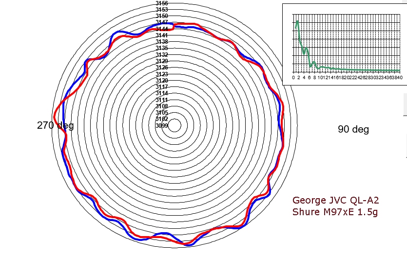

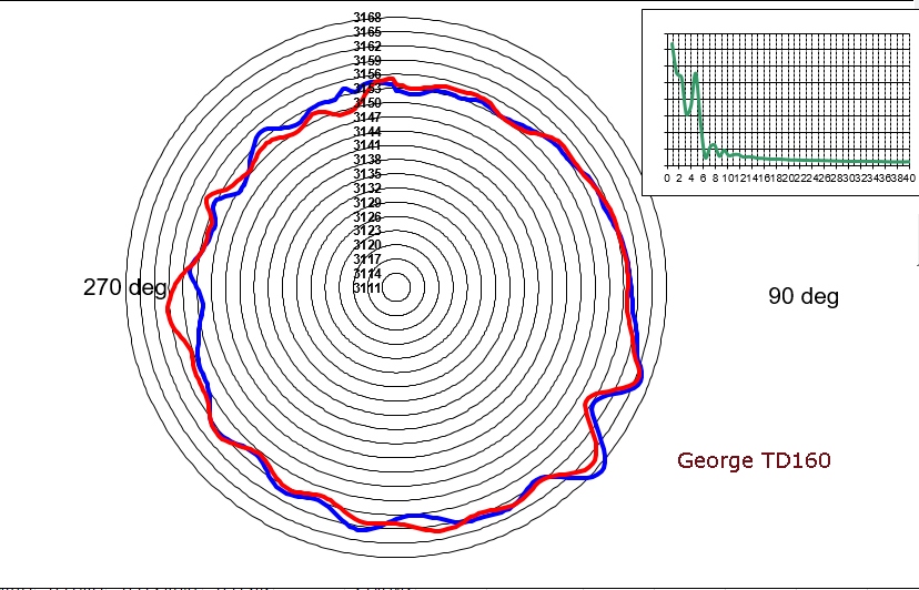

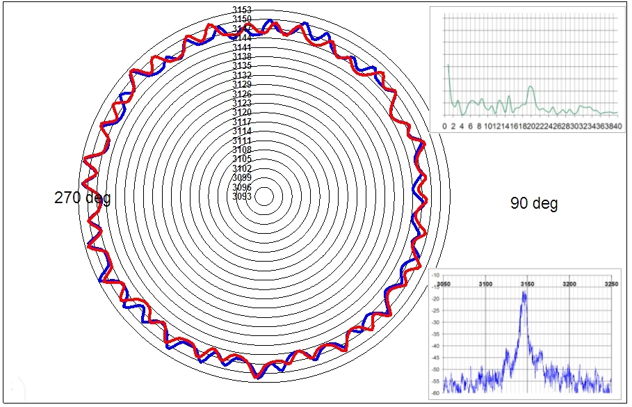

OK George, since you ask for it...........😉
Here's two polar plots, one each for your TD160 + SME3009i + DL103, and the JVC QL-A2 +M97eX.
I hope they're self explanatory: once around the polar plot is one platter revolution, radius is 'instantaneous frequency', and red and blue lines are two successive revolutions. Inset is the spectrum of FM modulation, x axis in Hz.
Overall the TD160 result tallies with Pano's spectrum/ Dr F tests: a deviation of about +/- 0.35% over the revolution. You can see, much of this is a once per revolution eccentricity type deviation, perhaps from eccentricity of the record or the spindle shaft, or vertical platter run-out. There's also a once per platter event at about 4 o'clock, which seems to have spectral content about 4Hz which might be warp, but doesn't show up when the same record was used on the JVC, so probably not.
I would say from experience that the TD160 rig, overall, is below par as to pitch stability, but not untypical of untreated TTs. One radial line on the polar plot is about my limit of audibily, that's fairly normal AFAIK. A suitable case for improvement.
The JVC QL-A2+M97 plot is a bit better, especially as to once per revolution deviation. But there looks like twice per revolution stuff going on in the spectrum, plus something about 5 Hz, and what might be the cart-arm resonance at about 7 or 8Hz beneath all the other stuff. Overall, another suitable case for improvement, IMO !
Yes, I'd contribute to a separate thread on exploring the true nature of pitch stability in vinyl playback. But, be advised, there's a lot more myths waiting to be busted, which as we know isn't exactly ever popular.........🙄
LD

Nice work, Lucky - thanks. It's an interesting way to look a this, not the least because the plot actually looks like a record. 😀
This raises several questions for me.
  • Is it possible to see the polar results in percentage, instead of frequency? That might be a little easier to grasp, along with your comments that one division is usually audible.
  • Can you change the scale?
  • Do eccentricity and warp show up the same way on your plot? Can you tell them apart?
  • What do you think of the low pass approach used by Feickert?
I agree with Bill that a thread on platter speed and stability using some of the techniques shown here would be most interesting.
