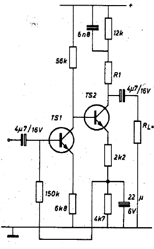

OK lucky GB and USA guys,
I am a bit lucky too to understanding Dutch a bit
but I could not understand from the text what should be R1 resistance to get right electronic damping at the input and right falling the correction curve...
Do you know the formula?

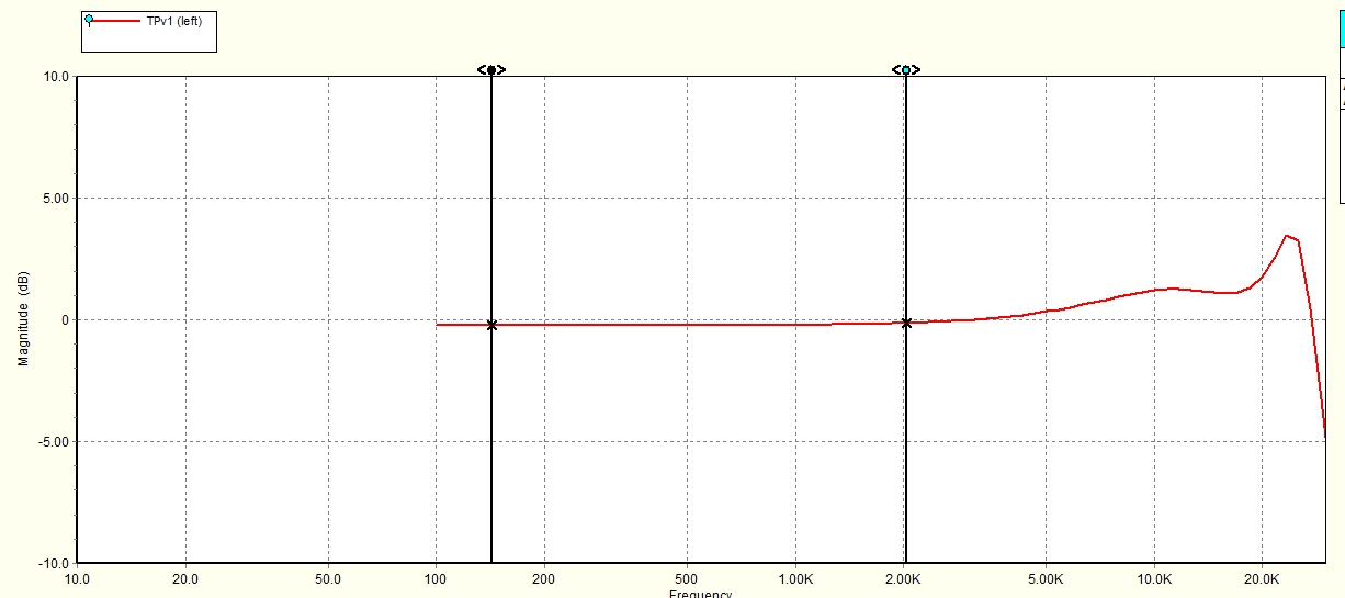

This is manual spot frequency measurement across the coil of an Shure M97XE.
An 100 Ohm Ro signal generator with a constant 4.91mVrms output, wired in series with the cartridge, feed a Hagerman Bugle RIAA preamplifier.
Cartridge:R:1K55, L:700mH.
0 dB refers to the measurement at 1KHz.
The collected data remained the same on all cases of cartridge position (Cartridge On Air, Cartridge lowered Onto Groove, Brush lowered, Brush raised, Stylus Force varied from 1 to 2 gr).
I guess the shown resonance is of electrical nature.
George

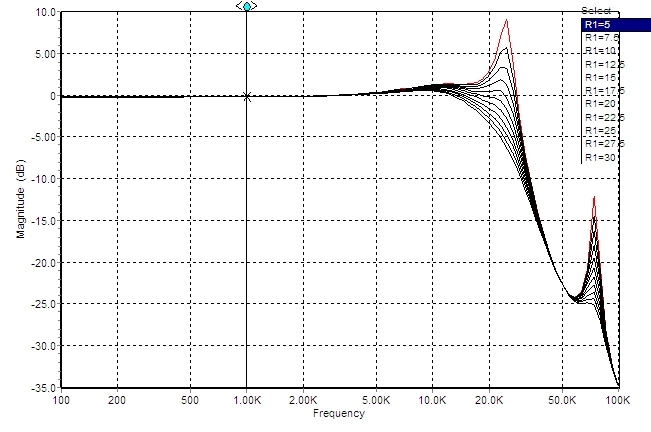

Here's a simple spice model for both mechanical and electrical aspects of a MM cartridge that produces readily recognisable results.
Mechanical system is modelled as a transmission line, with a delay appropriate for propagation as transverse wave along a cantilever, terminated by an appropriate mismatch. Electrical LCR system is modelled as just that, and coupled to the mechanical system.
A basic spice schematic is sketched below, marked up with the mechanical/electrical systems. Also attached is the simple f response for that circuit, and also a further developed model that shows MM loading variation working as it should re the overall f response.
The basic model has a lossless TL, whereas in reality there are losses, as there are in the generator. Easy enough to add to the model - try it !
I spent a happy few months a few years back playing about with models for Ortofon and AT carts, but also did a SaS/Shure V15 which I'll try to find. I rapidly became certain this model can mimic reality very well, so much so that it probably is what is really going on IMO.
