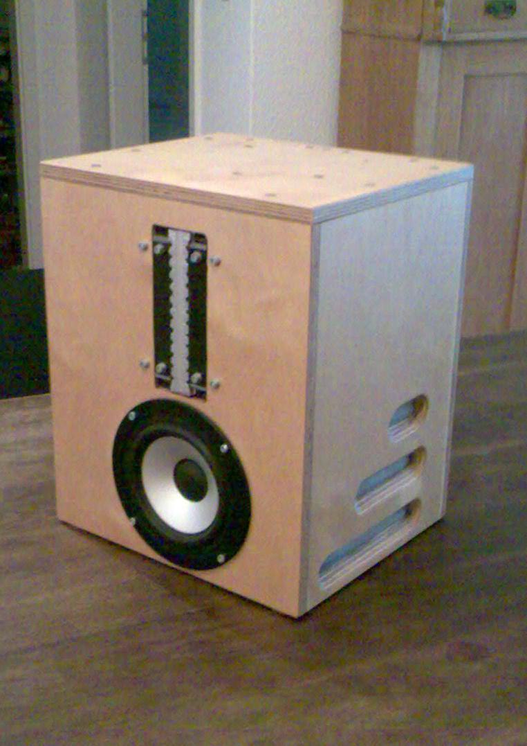

From my own experience: Before my studies some buddies in
the neighbourhood towns asked me to develop a reasonable speaker,
so i choose to make a kit and let the guys build the cabinet on their own.
My job was then to make the crossover, and do the end tuning in
their homes. I varied the stuffing and the crossover characteristics
according to their specific rooms and listening positions.
It was a 2-way BR System with XO at 2.3 Khz.
Since each cabinet was manufactured in the taste of the "customers"
(of cause i charged them for the crossover, the speaker plans and the
service ...) i listened also to different cabinets although there were
recommendations from my side.
I heard that speaker in about 8 different rooms, which lead to a more
flexible crossover, taking all "seen" situations into account by switchable
components.
"Close reflecting side wall"
-> Downpadd tweeter in crossover region."
"Large listening distance in well damped room:
-> Compensate upper Midrange directivity of the (2) Bass-Midrangers
I built a "demonstration model" then, with had switchable crossover
and a cabinet that i regarded as well built. It was the heaviest damped
one.
The variants of the speaker were from
relatively light (but stiff) coreboard to
chipboard (MDF was not common that time) to
baltic birch plywood undamped and
baltic birch plywood damped heavily by 6mm of anti vibration mats on a 19mm wall.
Ranking from best to worst:
1.Birch Plywood damped
2.Birch Plywood undamped
3.Chippoard
4.Coreboard
What is hard to denote is the distance from Rank 1. to 2.
That distance is rather far ...
Rank 4 is what i would call an unusable speaker.
The Resonances were really disturbing and had relatively
high frequency.
I have got a chamber music recording for Cello and Contrabass:
Rank 4. wants me to leave the room, Rank 1. was a speaker
able to produce the timbre of the instruments in an enjoyful
manner.

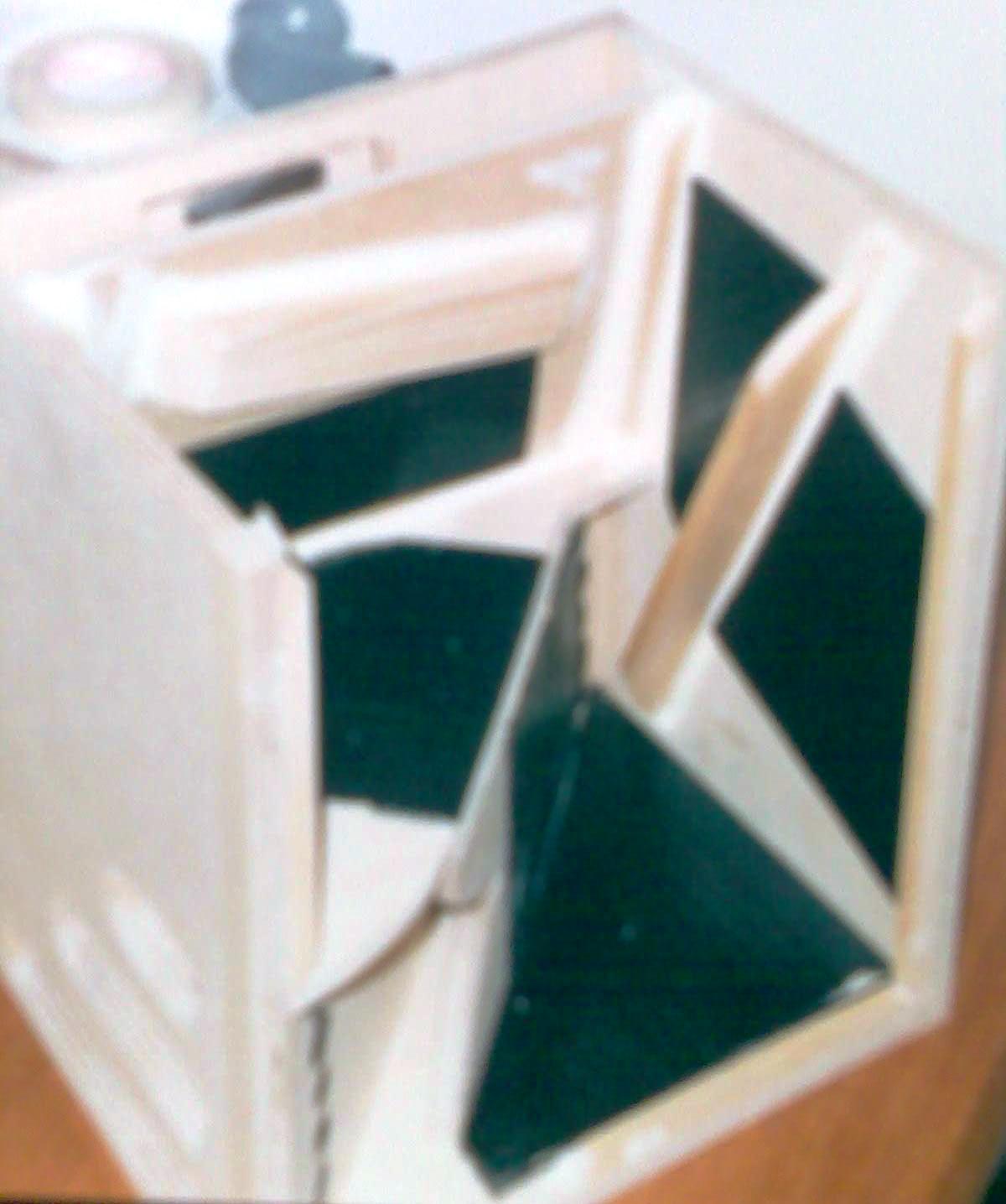

In the years later i made cabinets to further improve that experience.
One good solution was a small bookshelf speaker in which i used
rather thin plywood to hold resonances low and used no wood glue
at all. The cabinet is from ovelerlapping sheets glued with 2mm gaps
filled wich an absorbent glue which is more plastic than silicone.
Braces are not going through but made of several sheets glued
together in that mentioned fashion.
It is one of the best cabinets i have built and it was the right decision
to make the walls relatively thin to hold resonant frequencies low and
apply a high amount of damping and decoupling.
That speaker works as a kind of "reference" in uncolored midrange,
it uses a small Visaton AL 130 up to 900 Hz and the crosses
over to a homebrew ribbon tweeter.
I use that speaker up to now sometimes when in doubt what my
current prototype does to the music ...
My Dipol 08 Design is the best lower midrange i had up to now and
the success is from damping, mass loading and avoidance of radiating
cabinet/baffle surface as far as possible.
I know that there is a couple of people convinced from
even undamped enclosures. AFAIK such an undamped fullrange
construction won a price in some contest lately ...
So there must be something to it - which some of us cannot follow.
Maybe there are two polar oppositions
resonant - clean
lifelike - lifeless
Maybe there are the "clean" (sonically!) preferring kind of people
who do not want to hear and feel resonances (from the speaker itself!).
Maybe there are "lifelike" people, which associate detail and
"bodily impact" with the feeling a low damped system produces.
What a vibrating sheet can do, is change the main direction of radiation
within a small frequency intervall, thereby producing some kind of
"additional diffuse sound field". That kind of sound field may be more
similar to the sound field of a piano e.g. than that of a speaker,
which is mainly a point source with a non diffuse sound field.
Since i seem to be more the "clean" type of listener i try to understand,
what it is, that the "lifelike" people regard as high.
Maybe i am a hidden "lifelike" person too, who knows ...
Hello, do you have any photos of this construction? What kind of "absorbent" glue did you use? And why not simply use sand between the two walls? Thanks.
That where real photos on paper from mounting i made about 2003.

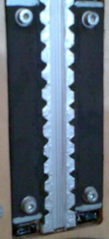

I used my handy now to copy the photo ... may be sufficient to get an idea.
That cab is rather complex, there is a wedge shaped chamber for
the ribbon tweeter because the ribbon is back open.
The main chamber consists of two cascaded helmholtz resonators,
not relevant for our discussion on damping ...
but you see the inner port with holes at the ends and some kind
of K-Slot to suppress resonances of the inner port.
The holes in the port were closed then - not needed AFAIR.
The 2nd port going outside is not visible in that step of mounting.
I used "Pattex Super Montage Extreme" it was ebony colored that time,
i think they changed it into transparent by now.
To hold the gaps on distance i used chips from cork where necessary,
they were removed afterwards where possible.
The glue needs larger surface than wood glue, but you need
surface anyway to get the damping effect.
The curved bracing is to get larger gap surface and to use
shear forces on the damping layer.
The divider for the tweeter compartment e.g. is not
directly glued to the side walls, but damped fixed to some
bars.
Why not sand ? Surely sand is nice but i think you wont get away
with less than 4cm thickness of the walls in a bookshelf speaker ...
in wanted to make a compact speaker.
The speaker is ridiculously complex ... that's why i gave up further
devopment, but the cabinet works very well especially concerning
vibrational damping.
Kind Regards
