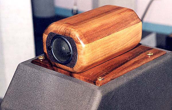

A mechanically isolated tweeter head
Here's a shot of the spring isolated tweeter head assy. (hopefully, this is the first time I've done this) from the Perkins PR 2, circa 1985. The springs are underneath and the backed out, large headed screws you see are what keep in it place and, screwed down, secure the assy. for transit.
Bill Perkins - PEARL
