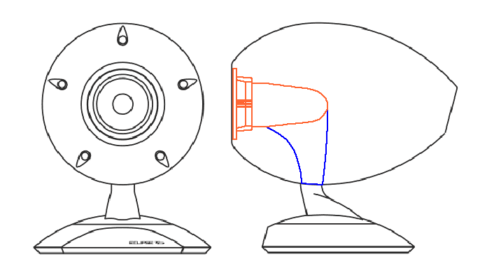

The FujiTEN Eclipse uses a sysyem where the driver is connected to a mass-loaded base (blue & black) and the shell is floated on that with no rigid contact. Something like the attached sketch.
http://www.eclipse-td.net/
speaker | ECLIPSE TD series speaker
dave
designed/patented by Yoshii Hiroyuki
decoupling seems to be technically much easier to achieve with upward firing speakers

there is more of them, also the patents licensed to Fujitsu, just search the freepatents with "Yoshii Hiroyuki", Yoshii-san seems to be quite obsessive about decoupling 🙂
