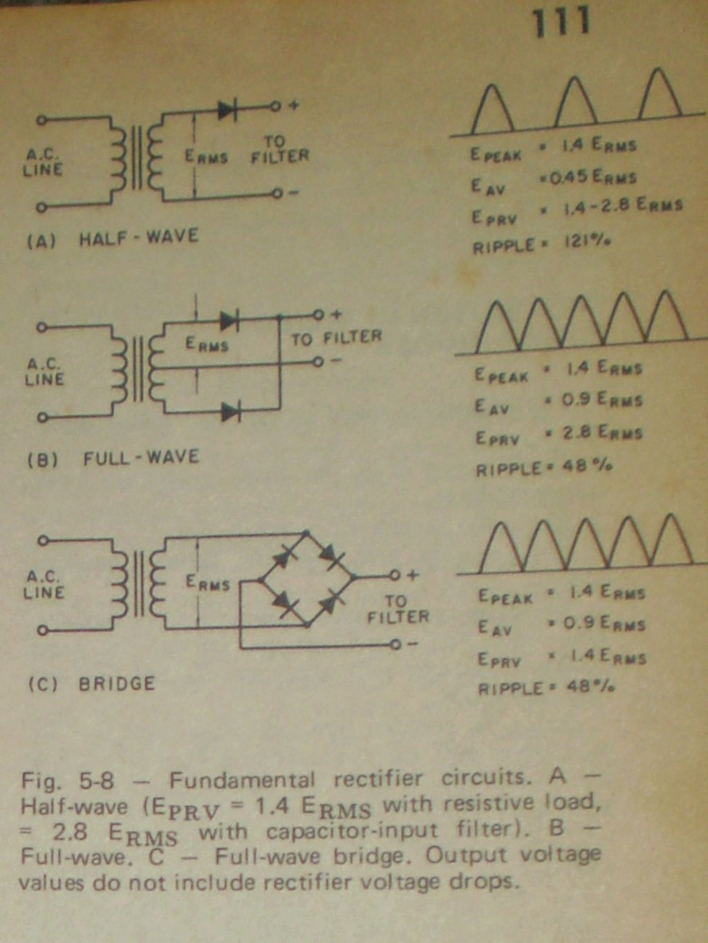

After you rectify it you will get approxomately 390v X .9= 351V.
When you add the filter caps you will get 390 X 1.142 = 551Vdc.
Here is an excerpt taken from page 111 of the ARRL 1978 handbook.
Enjoy !!
jer 🙂

Sounds right to me , i would use a pair of capacitors in series (remember to double the uF) with bleed resistors across each one terminals , using 2 caps rated 100uF-400V in series you get a cap capable of 50uF at 800V (in teory) , 600V for safety ...
use higher voltage caps....... the voltages are correct...
as to how much the voltage will drop when the system is loaded will depend on the transformer your are using - ie the internal resistance of the transformer and how much current it is designed to provide and how much current is being drawn...without these parameters/details, impossible to tell how much the expected drop will be
You might want to consider using what's called a choke-input filter, which will give a lower loaded voltage with some other advantages. Unloaded voltage (including start-up!) will still be the same very high voltage, so you'll still need to allow for that when choosing caps.
