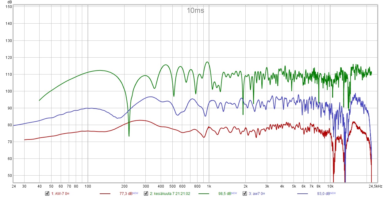

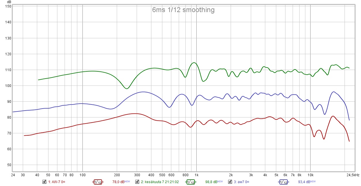

Thank you very much Erin et al. for this thread! Measuring loudspeaker output is really really difficult! Every "system" has flaws.
Perhaps spliced combination of groundplane up to 500-1kHz and on high stand would be best. But naturally single fullrange measurements would be faster to perform... Impulse response will show all reflections easily, and reveals best how different measurements are.

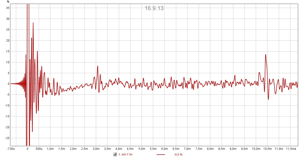

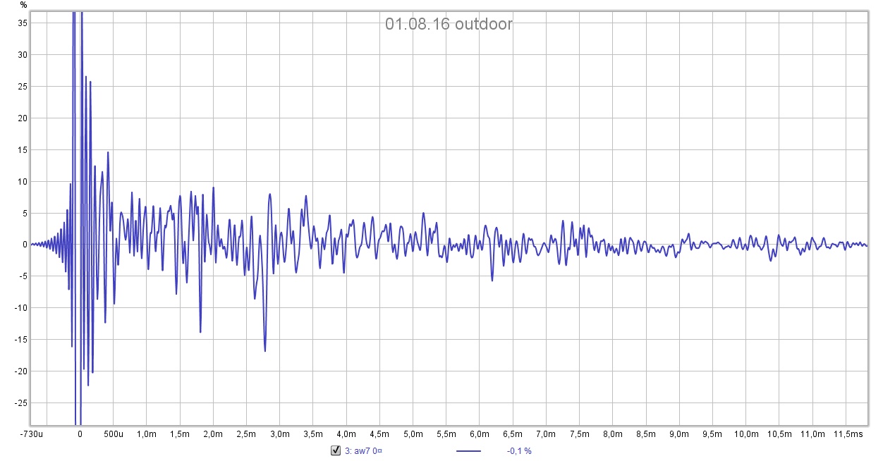

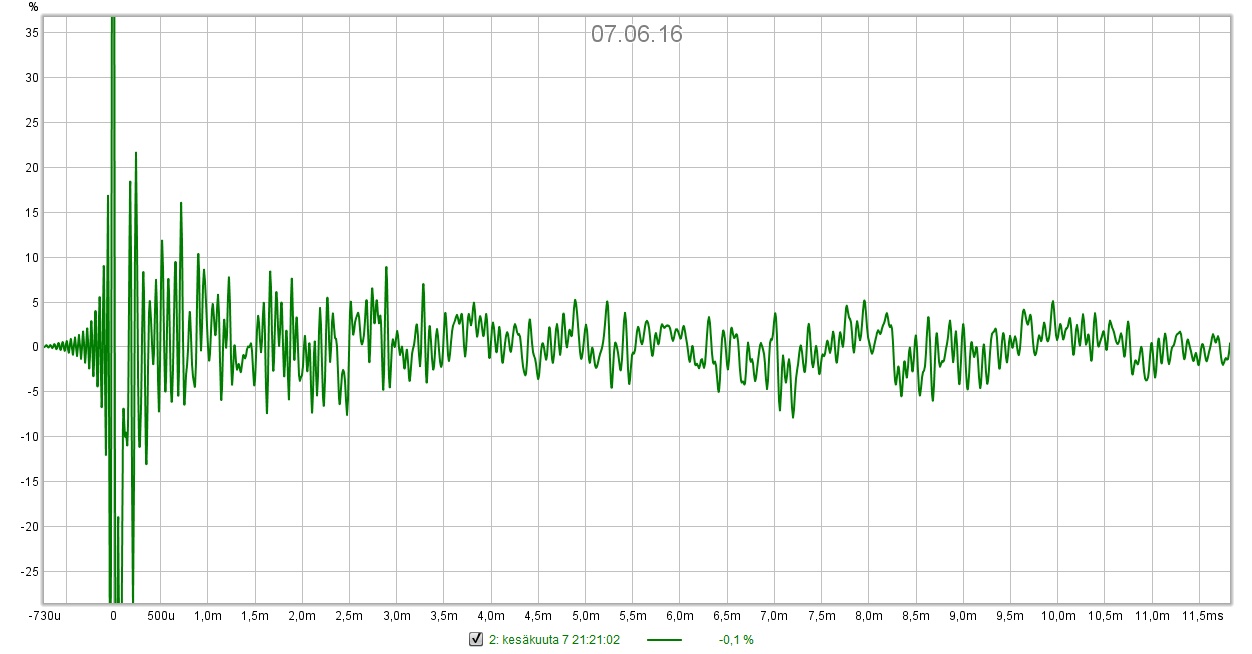

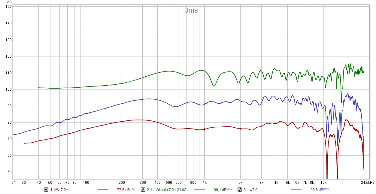

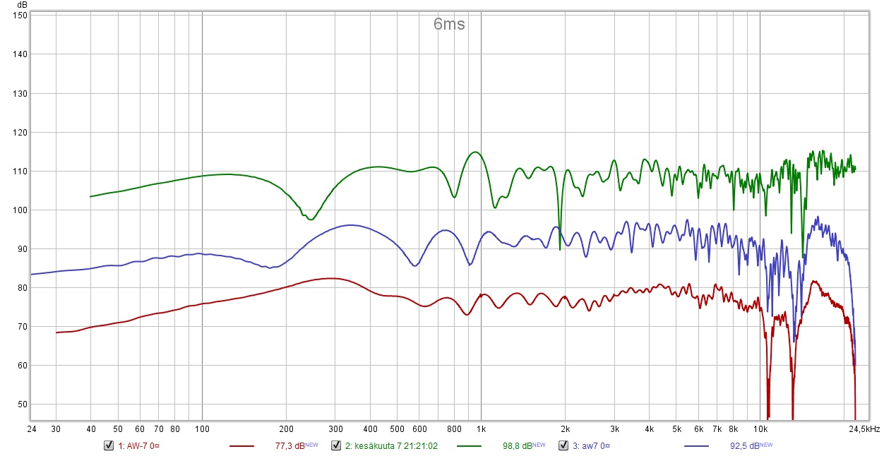

Above 1khz isn't easy either. Here my measurements with the same mic, different evironment and distance. Also on-axis line was with eyes only. The speaker is diy with co-axial SEAS T18 with aluminium tweeter. I have no idea which of these is the right one... The purple one was done outdoors at 1,5m, others indoors.

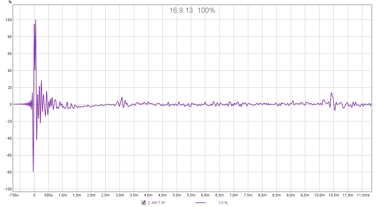

Please notice that impulse displays show only 30% of the signal peak.
But yes first ms is hashy. Mic was taped on a camera tripod. Also co-axials have those interferences making dips and peaks 10-20kHz
Red impulse with 100%
True it doesn't help to only see that much of the impulse 😉
Red looks to be the cleanest much less going on between the 1ms hash and the 3ms reflection. That looks to be the one least affected by reflections.
