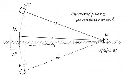

It is based on the theory of acoustical mirror images, by measuring a speaker on the reflective surface with the mic on the reflective surface in the same plane that boundary is removed from the measurement. Like measuring two speakers one on top of the other, so you get a 6dB level increase and baffle effects that look like it is twice as big as it really is.
Here's a Linkwitz Diagram to visualize it
attachment.php
The less reflective the surface the less this holds true, interference happens and the result is less accurate.
Erin's measurements show that it is still good below 500Hz. It's only when you want to measure full range that the surface becomes critical.
