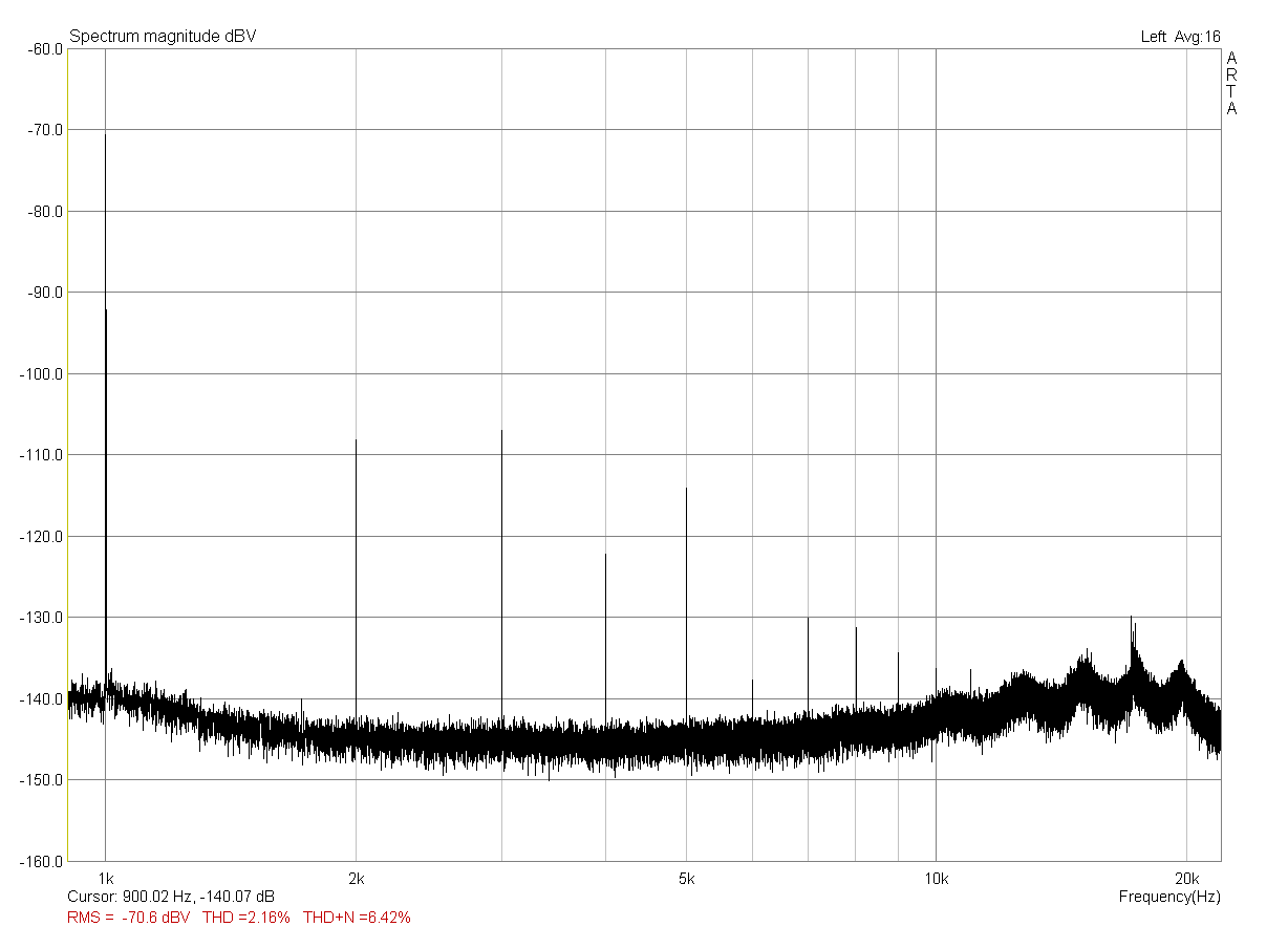

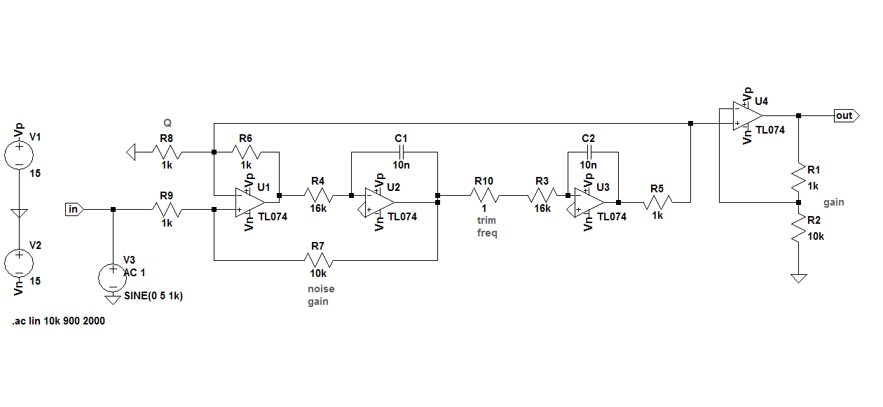

Amazing little circuit...! Let me tell you what I have found out so far. Here's the schematic again:
R7 and R9 set the gain for the first stage (20dB in this case) and dictate most of the performance of the whole circuit. Increasing R7 will yield a better noise performance and a higher Q (i.e. sharper and deeper notch), but will demand more performance and headroom from the opamp. The input signal will be amplified by this amount and the opamp must not clip to the rails or add distortion due to being operated too close to the rails. Decreasing R7 on the other hand makes the noise performance worse (in my sim it dropped from ~20nV with 10k/1k to ~40nV with 1k/1k) and lowers the Q, so the notch gets wider and the harmonics will be attenuated more, but now there's not such a high signal level to be handled by the opamps. I have made R7 and R9 equal with great results, which I'll show you in a minute.
R1 and R2 usually have the same ratio as R7 and R9, to make up for any gain or loss in the pass band and make the overall filter response 0dB. Of course this last stage can also be set to a higher level, to amplify the remaining distortion products.
C1/R4 and C2/R3 determine the notch frequency. The capacitors should be close in value, because a huge difference degrades the notch depth, but fortunately they don't have to be matched nearly as close as in a Twin-T! The resistors don't have to be matched at all, because one of them will be adjustable to center the notch frequency on the oscillator. You really only need that one potentiometer!
Increasing R8 will increase Q to some extent. This may be helpful for some, but I've left this pretty much unchanged.

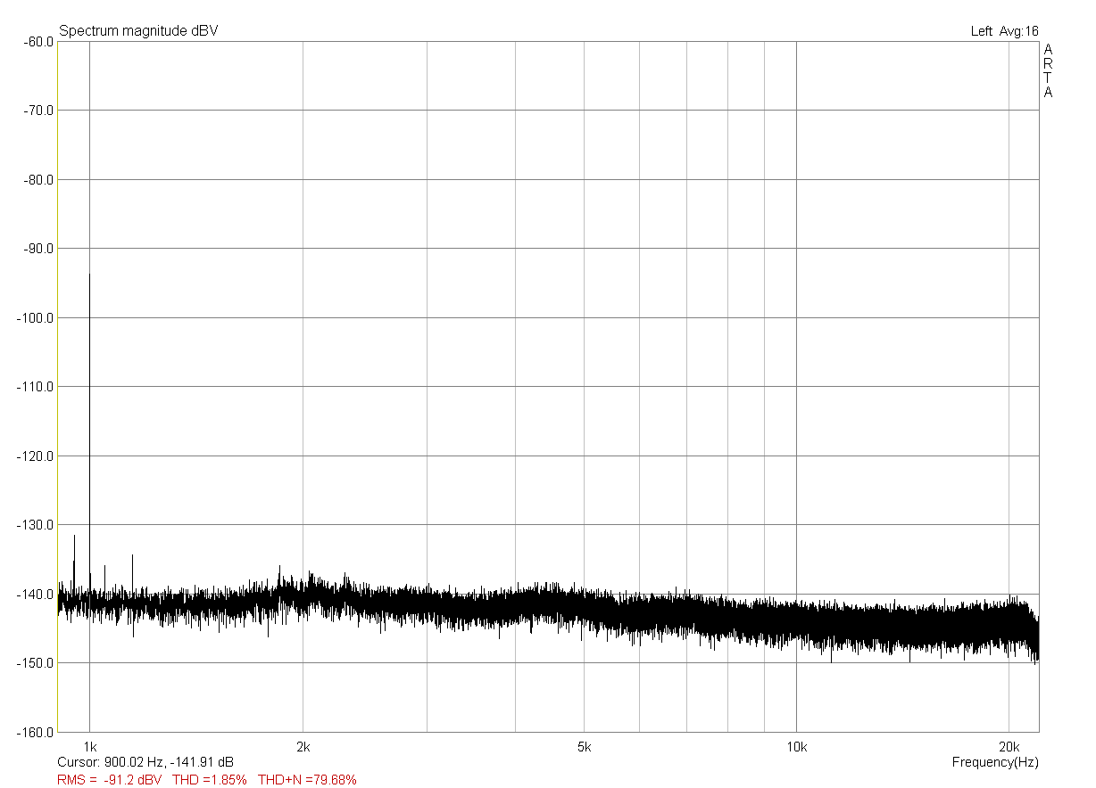

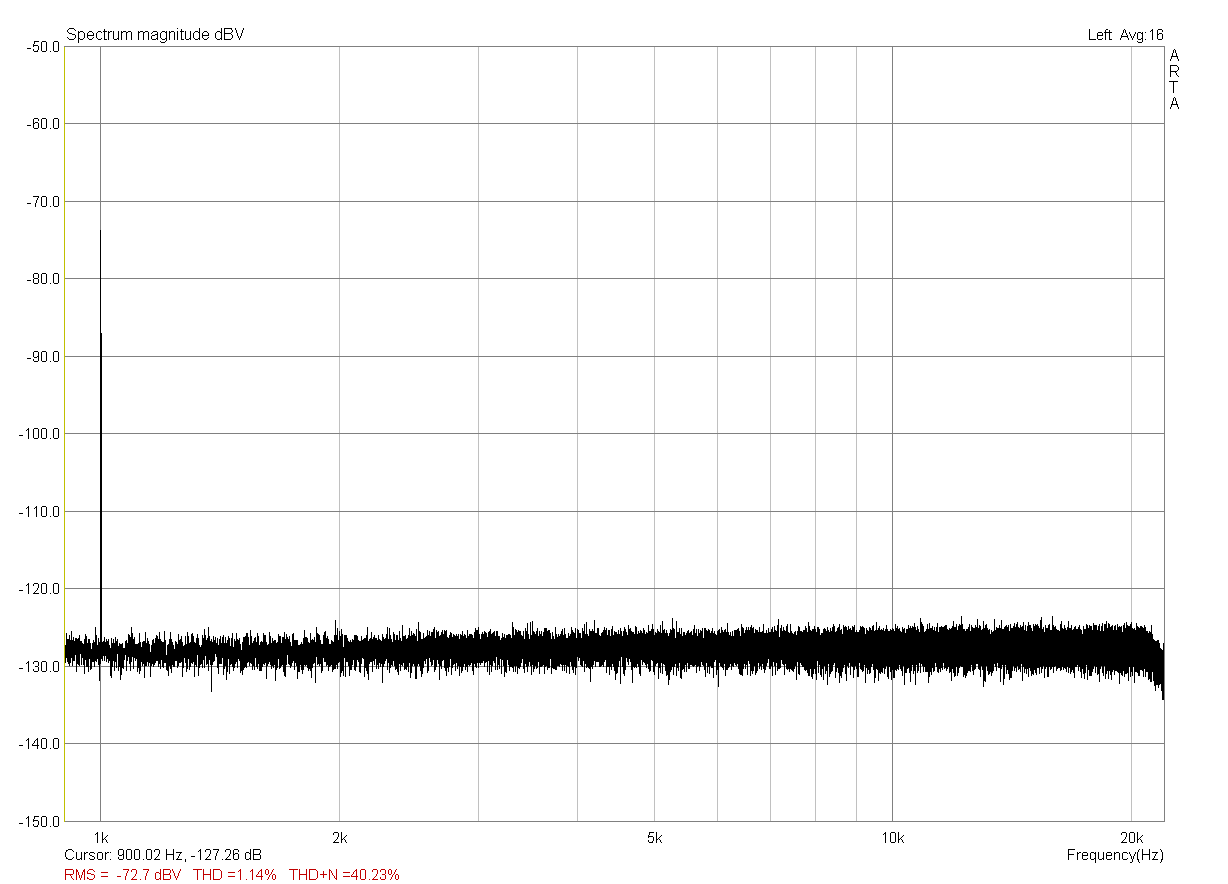

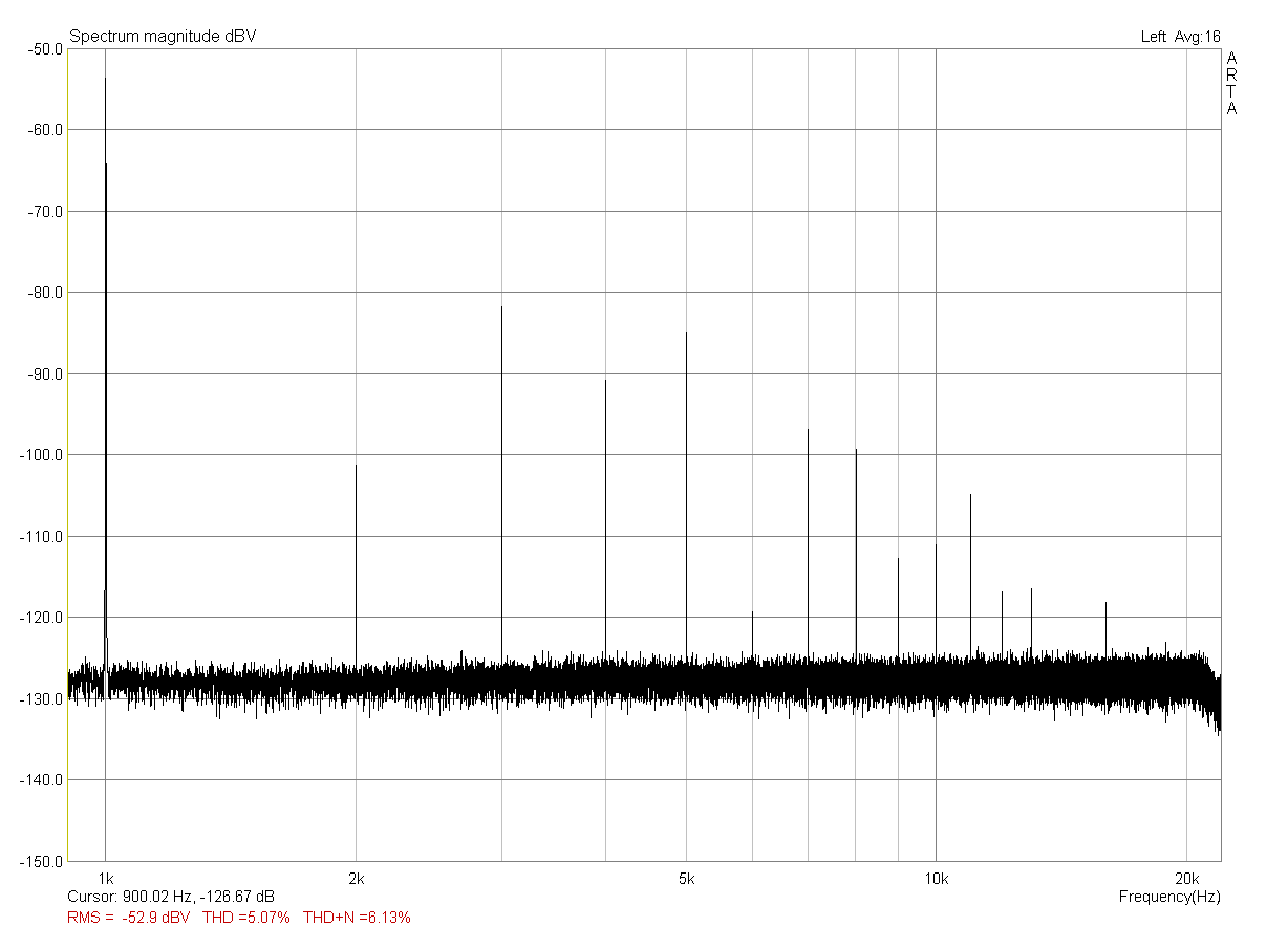

Now for some practical results. Here is the circuit from above fed with Victor's oscillator set to its lowest output level, which measured to 0.2Vrms:
You can see a lot of harmonics, which I suppose are not originating from the oscillator itself. I rather think they're produced in the first three opamp stages, which are working with 2Vrms signal level into "roughly 1k" impedance. Like I said before, the TL074 (or TL084 actually) is probably not the best choice in this case, but it was the only thing I had conveniently handy. But let's see if we can do better.
This is the result with R7 and R9 both set to 1k. This makes the gain in the first stage 0dB and thus the opamp doesn't have to work so hard anymore. You can see that the noise floor rose by about 5dB, but now you can't see no harmonics anymore! Where are they gone? The simulation of this circuit will tell us that the 2nd harmonic will be down by 3dB and the 3rd by about 1dB, due to the lowered Q of the filter, but that's certainly not enough to hide the 30+dB that we saw before. Let's try another thing:
Now I have additionally changed R1 and R2 to 20k and 1k, respectively. This gives us another ~20dB gain of the signal we've seen before. We can easily check that with the indicated RMS value of the fundamental, which rose from -91.2dBV to now -72.7dBV. In the meantime between the two measurements the oscillator drifted a little and the notch was not spot-on for both, that's why we only see 18.5dB here, but that's not really important now.
The noise floor made another huge leap from below -140dB to just above -130dB, which was to be expected, but notice that there are still no harmonics to be seen!
And finally, here's Victor's oscillator with its full output of slightly more than 2Vrms into the filter. Now we've got our harmonics back, but they're still produced by the opamps and not the oscillator. The Twin-T didn't reveal any harmonics under the same conditions of full output level into a deep notch and 20dB gain afterwards.

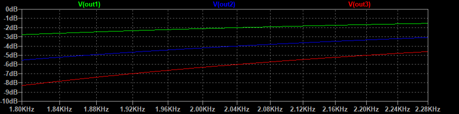

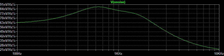

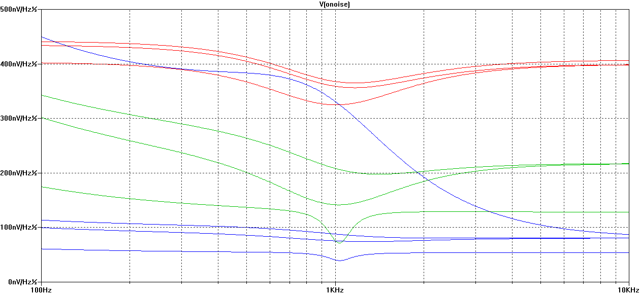

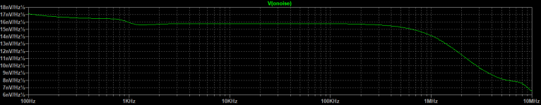

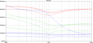

Meanwhile I've made some more simulations concerning the noise performance of the State Variable filter. For the next prototype I could get a quad OPA4134 and some dual OPA1612. Playing around with the passives and optimizing for low impedances (keeping current limits in mind) makes the 1612 a clear favorite here.
At a glance: The uppermost red curve shows the simulated performance of the TL084-prototype that I have built and measured above. It is the configuration with unity first-stage gain and the output buffer set to ~20dB. The other red curves show what could be gained by lowering some resistors and increasing the capacitors.
The green traces show the performance of the OPA4134. It has about half the input voltage noise of the TL, which also halves the overall output noise of the circuit.
The blue traces show the OPA1612 on duty. The upper curve doesn't look that great, which is probably due to the input current noise being almost an order of magnitude higher than that of the FET opamps, in conjunction with the rather high-ish 16k resistors. Reducing those increases the performance considerably, and that is what I will be building next.

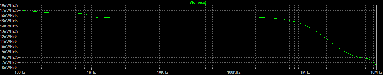

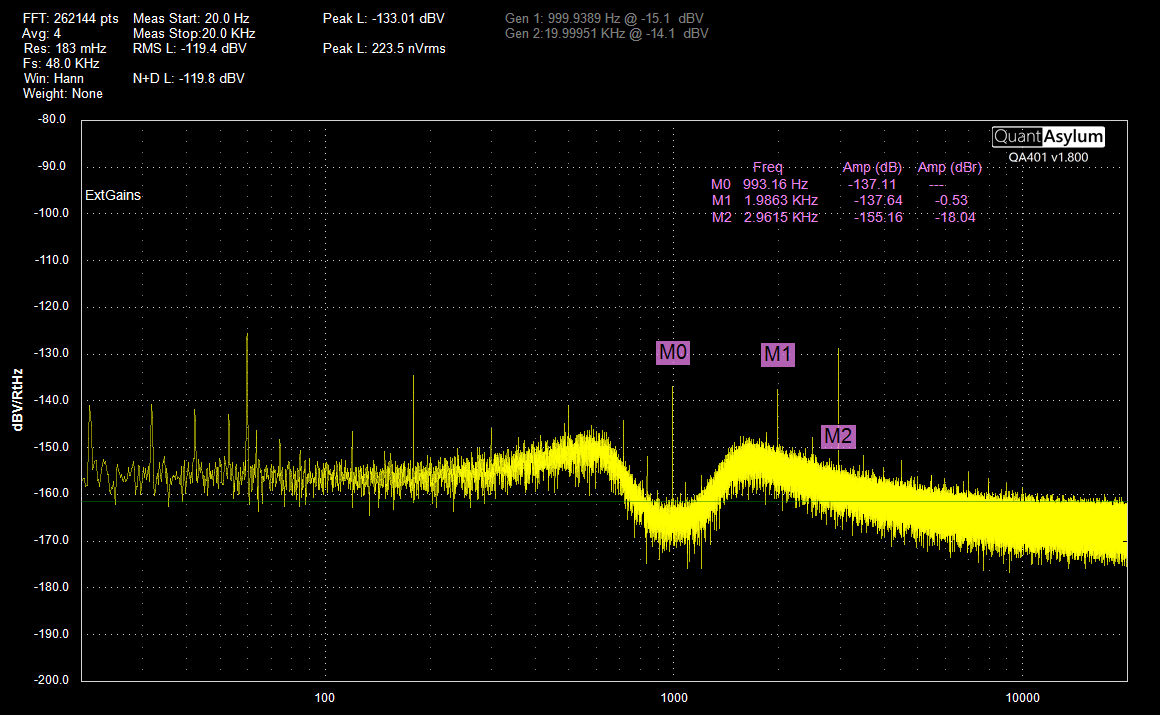

There were questions about the noise characteristics of the AD725D notch filters.
Attached is a scaled plot of the 725D measuring the victor oscillator in rtHz. Marker 3 I could not get to connect to HD3 of the oscillator.
I'm looking though my options for a way to plot the frequency response. The QA does not have a suitable way (not enough resolution).

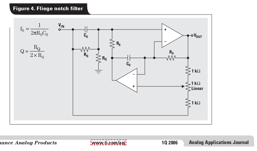

I'm testing Fliege notch right now.
Pro:
1. single pot adjustment central frequency about +-10%;
2. Q easy to set, so harmonics magnitude is correct.
Contra:
1. tendency to oscillate with high GBW OPA;
2. adjustment changes max attenuation level.

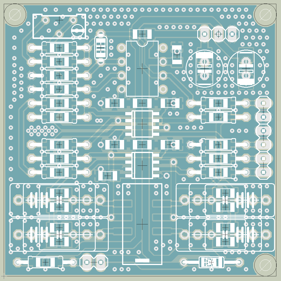

Created a little layout for the SV with two dual SMD OPA1612 and a single DIP LT1028 for additional gain after the notch. One of the OPA's is configured as an input buffer this time, as the input impedance of 1k might be a little low already and too much of a load for Victor's oscillator or any other DUT.
Crammed everything onto 5x5cm, including a relay to switch between two sets of capacitors for 1kHz and 10kHz use. Footprints are there for SMD or THT passives, which may come in handy during experimenting with the best performing values. The small size qualifies for el-cheapo chinese manufacturing, but I think this time I'll opt for some European board house, so I don't have to wait another month or so.

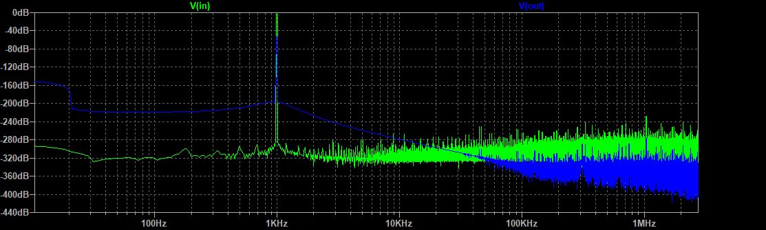

Here an 3x of your given asc file. The question rises how the 725D compensates the H2 attenuation as about 6.3dB 😀
See below freq. response, 2Khz details, noise analysis..
Hp
I'm not sure how accurate my .asc file is. Some aspects are confusing like how to represent the cap neutralization etc. not to mention the potential for errors on my part.
The unit does not seem to have attenuation on H2 so I well might have an error.

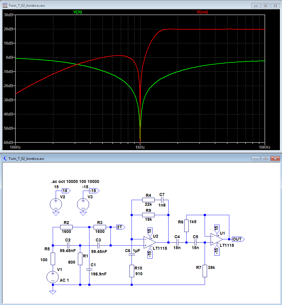

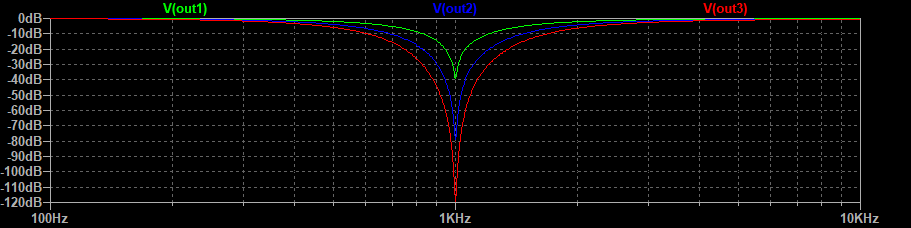

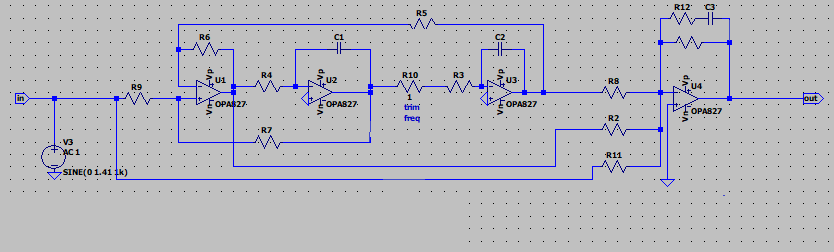

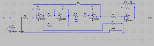

Some latest simulations using an active SVF-Sum Notch using the OPA827...
Real HW to come and verify... 😀
Mira pictures:
. Circuit (may a 20dB gain would look nice too)
. Noise
. THD
. H2 attenuation less than 1 dB
Hp
