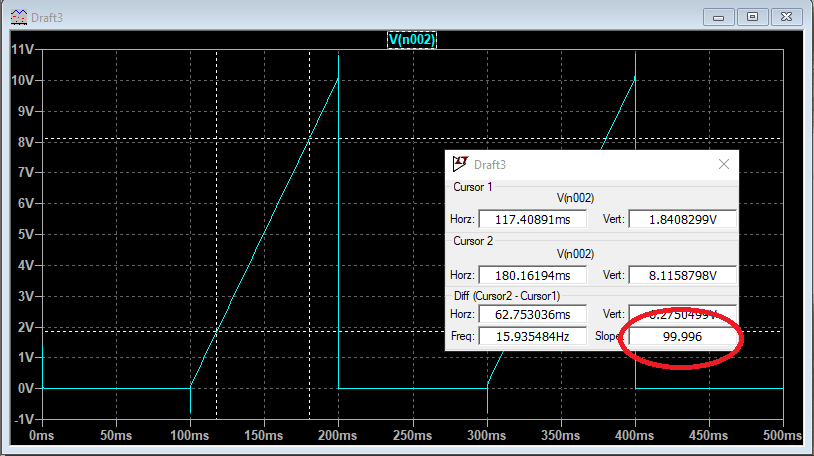

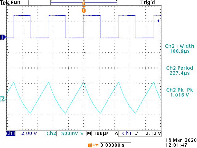

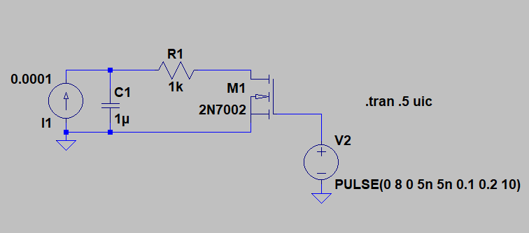

You use a constant current source of known value and measure the slope. A two transistor ccs would be accurate enough, a depletion mosfet better. Below 100uA CCS and 1uF capacitor discharged by 2N7002, slope is 99.996. You should be able to do this with any scope, but for a larger cap change the current (and use a beefier mosfet)
