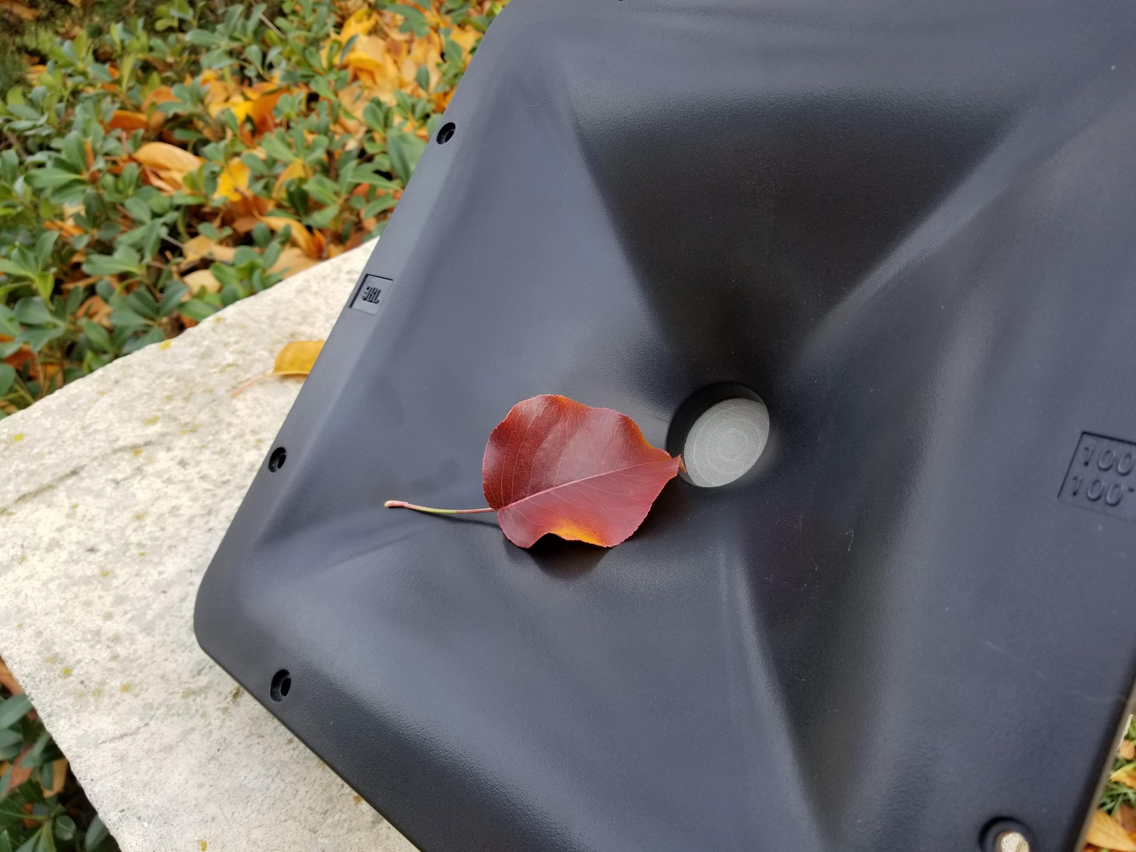

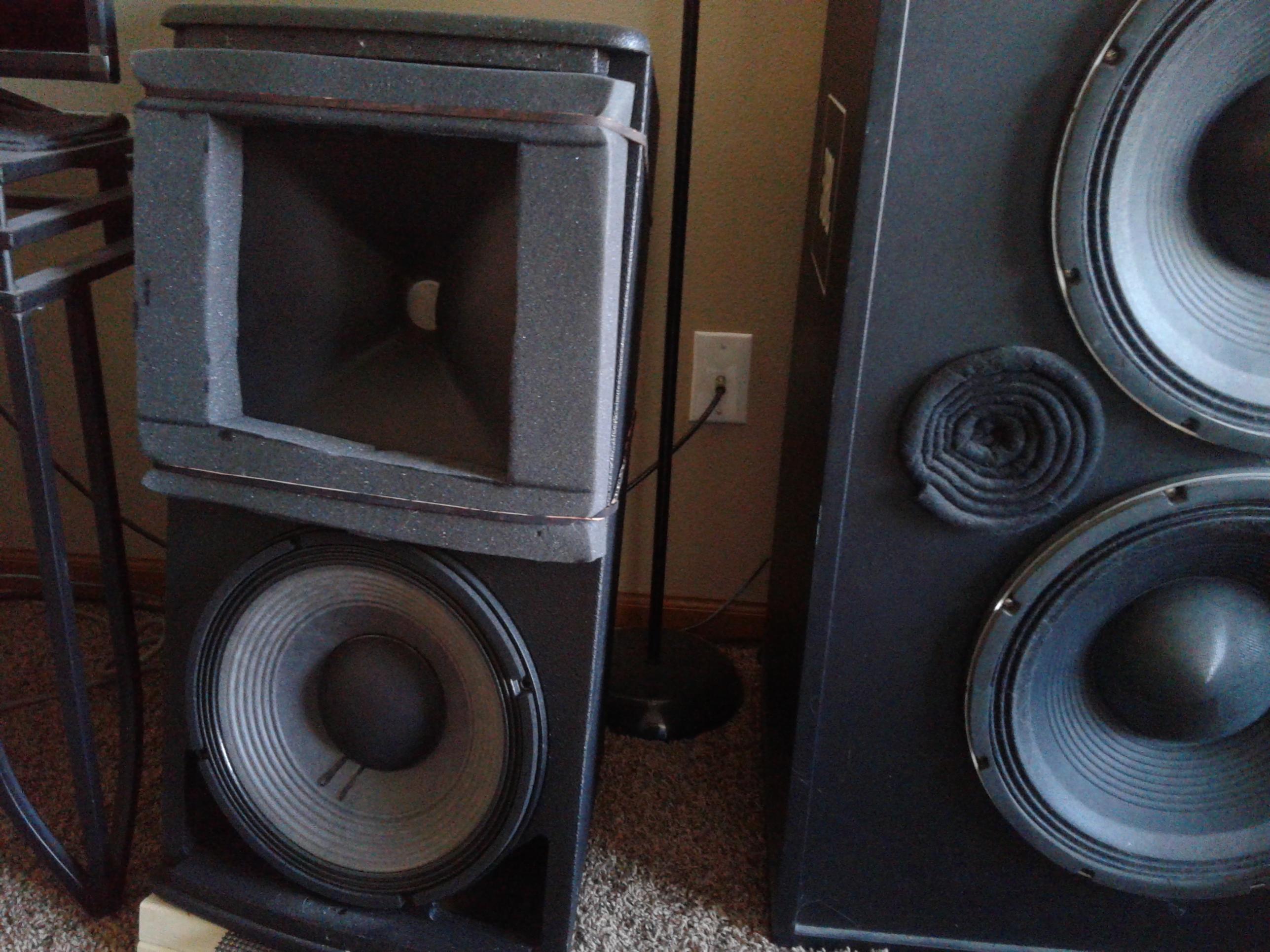

Mark,
I've been on a long search for a low reflection horn. I had a close friend who knew a lot. There are some things to stay away from, such as parallel walls (diffraction slots), corners (good luck with non circular), and edges. Look for smooth paths, not a series of straight lines that "angle" away. I had a big ev hp 640 that added a "live" reverb sound to everything, fine for pa, not for reproduction.
Waveguides seem to be an answer, and they don't narrow dispersion the higher in frequency you go.
I add that I'd like the mouth to slowly bend to the baffle.
Shoter horns sound better thgan deeper, but it depends where you want to cross at. Currently 12" 2-way 1,200hz crossing works for my varied tastes (movies to dianna krall to halsey/ariana pop). Sure my morel 2-way is far more detailed, but I'd like mid bass further than 7' from my speaker and i occasionally turn it up loud.
I have luck with my current pt waveguide, but would like to try the newer one. Mine has a bubble in the throat, but other wise no complaints.
For clean horns, look to the smaller monitors such as behringer truth or mackie mr824.

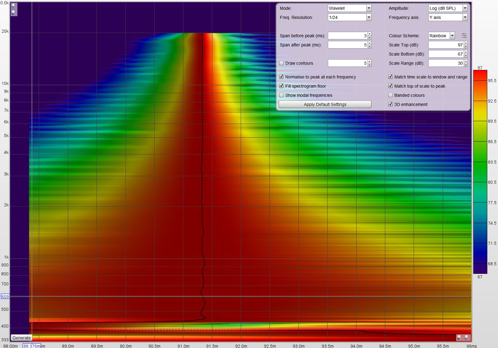

@ all, I posted the following spectro on a current thread about the 4594....it's a single point on-axis tuning i made the other day after I got frustrated trying to pinpoint reflections...
had to accomplish something/anything that looked good or showed promise lol
