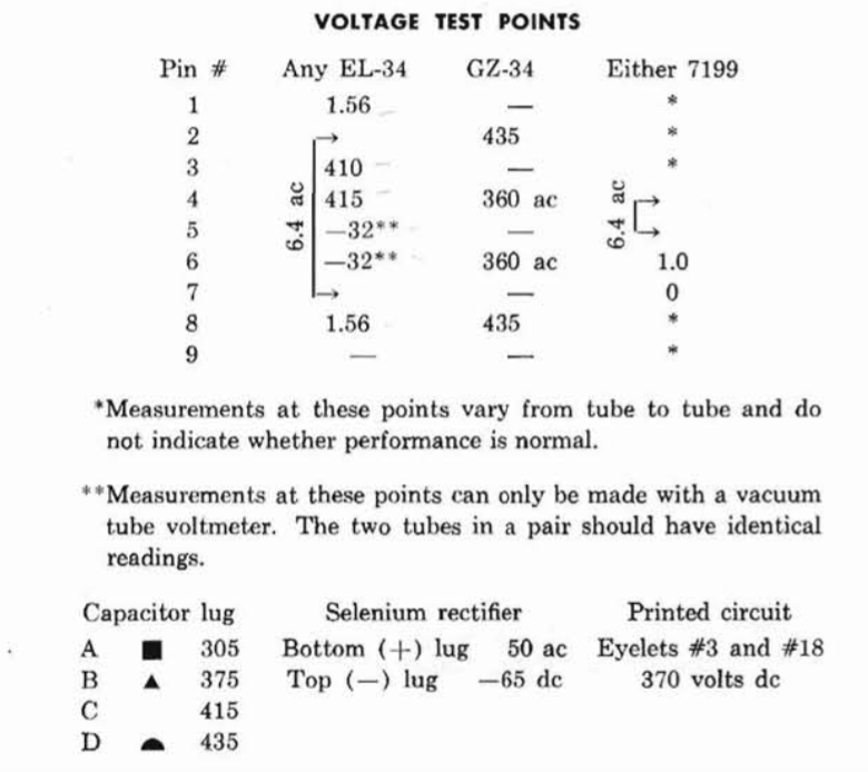

I want to check voltage points for my Dynaco ST-70, since the bias value seems too high.
In the manual of the Dynaco ST-70, I found the attached voltage points for EL34, GZ-34, Capacitor lug, selenium rectifier (which I replaced with a diode) etc.
For example, EL34:
Pin 1 - 1.56v
Pin 2 - 6.4v ac
Pin 3 - 410v
Pin 4 - 415v
Pin 5 - 32**
Pin 6 - 32**
Pin 7 - 6.4v ac
Pin 8 - 1.56v
Pin 9 - --
The manual specify for ** "Measurements at these points can only be made with a vacuum tube voltmeter. The two tubes in a pair should have identical readings."

DO NOT try to measure HV unless you are absolutely sure about what you are doing! To bias the ST70, you only need to measure pin 8, with the black probe connected to ground, it should read 1.56V. That's all...
Any decent modern DMM should have sufficiently high input impedance for this task. Back when the circuit was developed, only VTVM were good enough - ordinary multimeters had a much lower input impedance.

For example, EL34:
Pin 1 - 1.56v
Pin 2 - 6.4v ac NO
Pin 3 - 410v DANGER
Pin 4 - 415v DANGER
Pin 5 - 32** NO
Pin 6 - 32** NO
Pin 7 - 6.4v ac NO
Pin 8 - 1.56v
Pin 9 - --
the scanned voltage chart is right, of course, but you didn't copy it properly.
543730d1460696052-measuring-high-impedance-voltage-digital-multimeter-screen-shot-2016-04-15-12.44.26-am.png
a) on pins 5 and 6 you have minus 32V or 32V negative , relative to chassis.
b) on pins 2 and 7 you do not "have 6.4VAC" but with one probe on one, the othar probe on the other, shown on the drawing, you measure 6.4VAC ; this is not a voltage relative to ground.
Sorry but I wouldn't suggest you mess with that amp guts until you learn a little bit more about measuring and multimeter use. 🙂
Just trying to keep you sound and safe so you continue with this wonderful hobby 🙂
