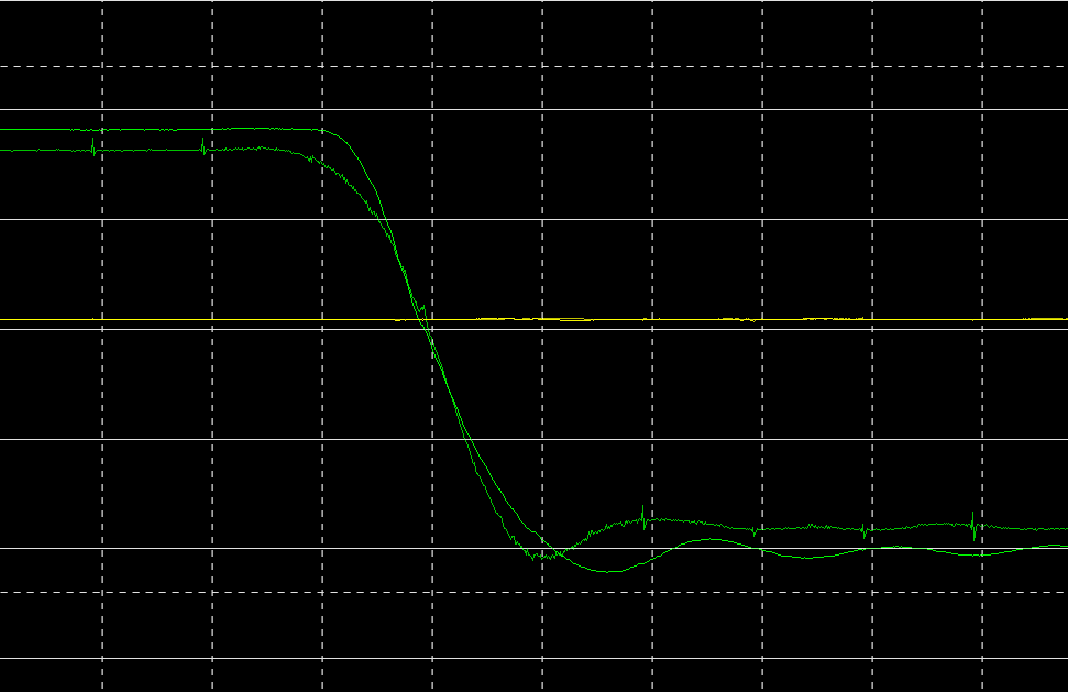

Chris,
i talk about chip solutions, where gates isn't accessible. I've tried resistive load totem pole, but can't see the dead time exactly. This is switching wave form (10ns/div) for the TDA8939, which claimed zero dead time, because rise/fall edges 20ns>10ns as dead time. So i want to check others accessible chips, just by looking to the totem pole switching. How?
Hi Ivan,
Consider the following. Dead time manifests itself in various ways in the actual behaviour of the power stage. You might try to list a few of the most important ones and see if any of them are measurable, either on a fully operational amp or on a test circuit.
For example, on amplifiers with a clear "dead time hump" in the THD vs power response, extrapolation of the right hand slope of the hump to the clipping point allows you to calculate dead time with good accuracy (if you know the loop gain of course - open loop amps are easier in this respect). Dead time on the TDA8939 is too short for this though, but there are other even more direct metrics.

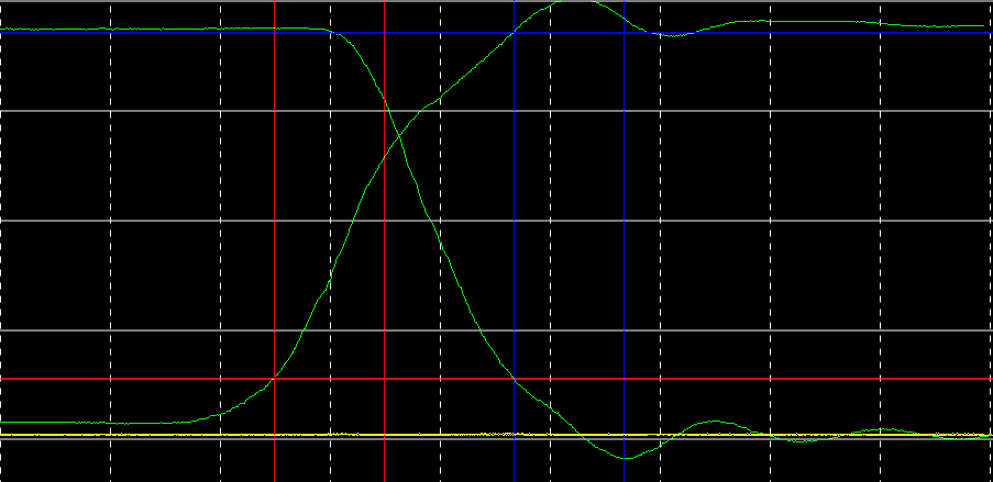

Nice input, Bruno. But for such wise DT measurement, i need already well designed PCB for each chip, it so hard for me.. more direct -more attractive. This is switching screenshot for loaded(~15ns)/unloaded(~20ns) same chip (20uHn/1uF/8Ohm), it seems that DT is really zero 🙂 Well, I'll try to compare the rise vs fall edges for DC at the output..(pumping- scary movie).
Considering that the switching behaviour of the chip will depend to some extent on the PCB layout, trying to determine "dead time" on a chip without a good PCB does not produce reliable readings.
Your scope plot shows differences in rise time, but not where the edge is with respect to the actual dead time... Triggering on the switching waveform itself is not informative.
Such kind of PCB.. yeah, it's not given to me easily. 😕
Actually, some assymmetry is well seen when "playing" DC. Just by fast looking (visual integration) the assymmetry maybe equivalent 5ns or less. I suspect, that also can try to read the driver supply current (boot strap pin), at least, in the simulation this current do things visible, however it is driver design depended.
