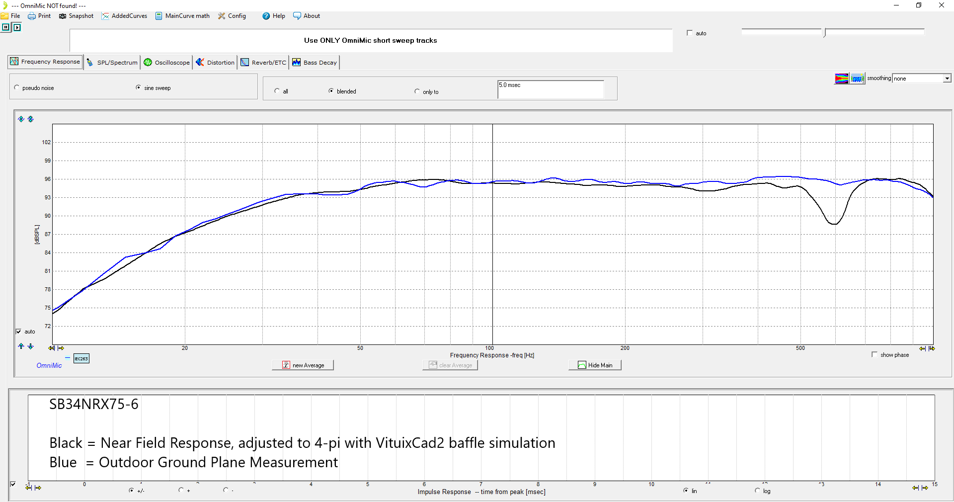

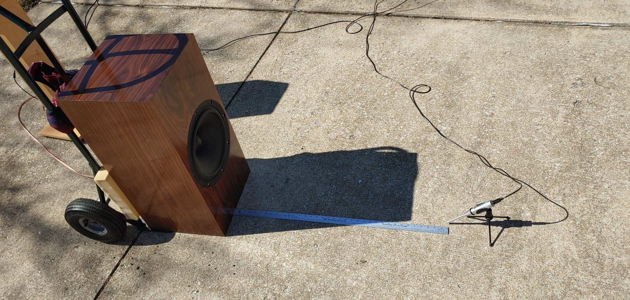

This is just one data point, but it helped me get comfortable with the process of taking a near field response, modifying it with a simulated baffle diffraction effect, and then merging it with a far field gated response. The outdoor ground plane measurement took place on pavement, 19 ft from the nearest reflective surface.

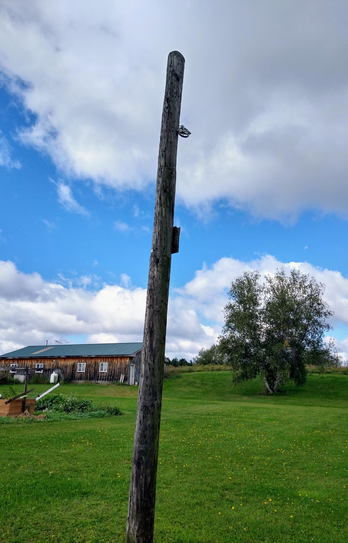

I tend to gravitate towards the most difficult solutions in many cases, if there's enough gain to be had by it. Though I don't think I'll be using this again anytime soon as a friend of mine has 3 lifts and the tallest one can reach 60ft, so I'll be welding up a jig and hauling my speakers to his place for the final measurements when it's not in use. I built the sound system for the spin room at the gym his wife owns earlier this year, so there are deals to be made.
Height is another line of thought to ponder as you consider the assets you may have available to you.

FWIW, It was a while ago but I have played around with my OmniMic using different locations while measuring to see how much reflections effect the response. I've moved since I did this, but at my old house I used to measure all my speakers in my 23x27 foot garage with 8' ceilings. It was actually pretty dead aside from the cement floor because I had lumber racks, wood working equipment, shelves, etc on all the walls. Using the same impulse response (IIRC it was 3.5), and 1/24 smoothing, with the mic on axis at the tweeter, 1 meter away on all the different measurement locations...
-I measured in what I considered the ideal location in my garage (right in the middle of the room, using a blanket on the concrete floor between the mic and the speaker), with the speaker facing the open garage door.
-Then I measured with the door closed and blanket removed- no difference at all, at least nothing that would justify opening the door anymore.
-Then I moved the speaker about 4 feet away from a wall (or from a shelf against the wall) and measured and was shocked but basically no difference.
-Then I took all of it down to what was my listening room at the time (pretty terrible room, 7' ceilings, tile floor over cement with a small rug, pool table, and roughly about a 25' deep x 13' wide room with a large entry opening to the room on one side of the speakers... and again was pretty shocked at how much the measurement was basically the same.
A mild blip of a change here and there, but nothing that I would say would cause me to make any change in a crossover.
But again, I was also ignoring everything below 400 ish Hz, so I don't recall what changed in this region. It would be fun to do this experiment again but also pay attention down there this time.
I understand being skeptical of the process, and your concerns make sense. We all have to do what we are comfortable with.
Excellent. Love the pole. I've thought about a pair of telephone poles with a cross piece at top.
