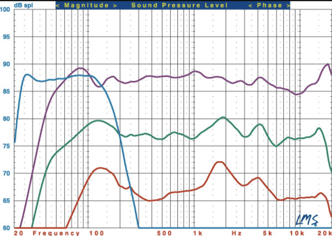

Here is Sound And Vision's measurement. Based on this, I would assume these speakers don't sound very good at all. But I've heard them and in my opinion they sound very good.
I know this isn't the main point of your earlier question, but Stereophile's method averages multiple measurements to smooth out some of the location-specific issues in the midrange and treble. Toward the bottom of the page linked below he describes the averaging method.
He also talks about his "acoustic black hole" between the microphone and speaker. Doing something along these lines is typically required, as floor bounce tends to seriously mess up your measurements in the 200-500ish Hz range (problem frequency range depends on speaker and microphone heights). If you have a tall room, angling the speaker up some and using a higher microphone position can help.

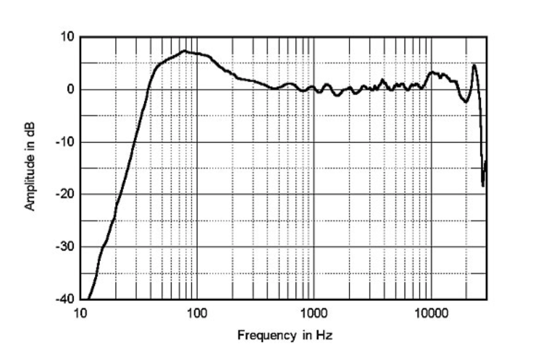

This is Sterophile's measurement. This seem closer to reality based on what I've heard from these speakers. Although, I do often see what I would consider an exaggerated bass response in Stereophile's measurements...
JA does not include the effects of baffle and box diffraction on his nearfield measurement which causes this rise in low frequencies. It is what it is, but it is not an accurate free field representation.

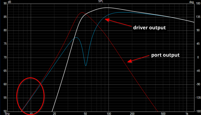

  2. Measure near field response. For low frequency accuracy use sine sweep, not noise or MLS signal
  3. Measure port response. For low frequency accuracy use sine sweep, not noise or MLS signal.

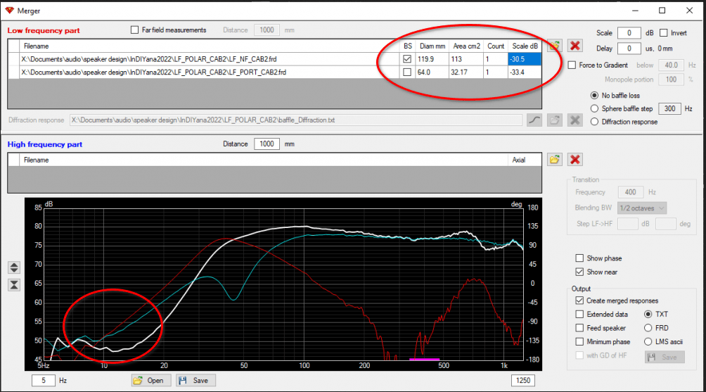

  4. Simulate baffle diffraction using VituixCAD diffraction tool. For this tool, place the mic directly in front of the speaker just as you measured in the far field, and enter the mic distance at the far field measurement distance. Export the result.
  5. Use the VituixCAD merge tool.
    1. Load near field and port response to the "low frequency" section.
    2. Select "diffraction response" and load the saved diffraction response from step 4.
    3. Load far field response(s) to the high frequency section.
    4. Adjust port response scale if needed, to align with near field response at low frequency. These responses should converge on each other as they approach 0Hz.
    5. Adjust scaling of low frequency portion to align with far field response amplitude. If you've done this process correctly, there should be a nice overlap in 300-500Hz range to splice the responses together.
Near field and port response can be a bit problematic to not have some contamination from the woofer output in the port measurement and vice versa, but for verifying the cabinet model I find this process still works very well.
