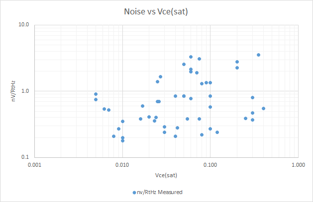

At least there is a positive correlation! I was thinking of doing something along these lines too. I have a couple of questions. Vcesat is quoted for different combinations of collector and base currents, so which one do you pick from the datasheets? Also there are a number of devices in the Table 8.1 with noise around 0.2-0.3 nV, but you have only 3 dots in the figure below 0.5 nV/Hz. Maybe we need more statistics.

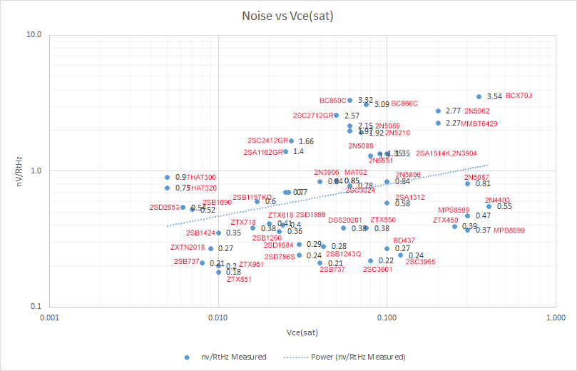

Where I could, I used the measured Ic parameter from table 8.1a and the 10:1 curve for Vce(sat) from datasheets. Quite a few of the devices have gone dodo even since the book was published. Don't throw a brick at me for using log-log chart:
This is cool, thanks for doing all the look-up!
Can you use the Excel option to label each point with the transistor number?
It would be good to understand what is the difference between transistors that have vce(sat) near 0.01V and very low noise vs. the ones that have vcesat of 0.005V but more noise.
Some of the data for Vse(sat) are very hard to read from the plots. For example, I downloaded the datasheet for ZTX851. Luckily its in a vector graphics format and I was able to make the lines of the plot thinner in Adobe Illustrator. Then one can see that for Ic=10 mA and Ic/Ib=10 the voltage Vce(sat) is only 1.6 mV.
I labeled the datapoints in Photoshop.
Anyone, feel free to provide better Vce(sat) numbers.
Thanks! I looked at more specific examples. For example 2sd2653 and 2sb1690 clearly have Vce(sat) of less than 10 mV, while 2sc3601 and 2sc3955 have Vce(sat) of about 0.1V. Yet the noise of the first pair is a factor of 2 higher than the noise of the second pair. So, while low Vce(sat) seems to contribute to giving a low-noise transistor, its not the only necessary ingredient.
Perhaps someone can stare at the examples of these datasheets and identify another reason why some transistors might be better than others.
I am going to get some PBSS4021nz transistors, which have Vce(sat) of less than 1 mV, the lowest I could find, and try to measure their noise. I haven't done such measurements before, so it may take me some time to setup the amplifier circuit. If anyone already has a setup to measure the noise, feel free to beat me to it.
