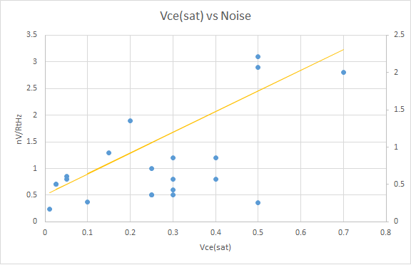

At least there is a positive correlation! I was thinking of doing something along these lines too. I have a couple of questions. Vcesat is quoted for different combinations of collector and base currents, so which one do you pick from the datasheets? Also there are a number of devices in the Table 8.1 with noise around 0.2-0.3 nV, but you have only 3 dots in the figure below 0.5 nV/Hz. Maybe we need more statistics.

I didn't include the higher power transistors which have low noise but Vcesat ~1.0. 2SB1243Q, BU406 and 2SC3955. If you include these, the correlation becomes meaningless.
TAoE gives two columnar values for noise -- measured and optimized. Generally "measured" is @10mA.

Vcesat on these is probably specified at 1-5A of Ic you would need to measure it at lower current for a proper comparison.

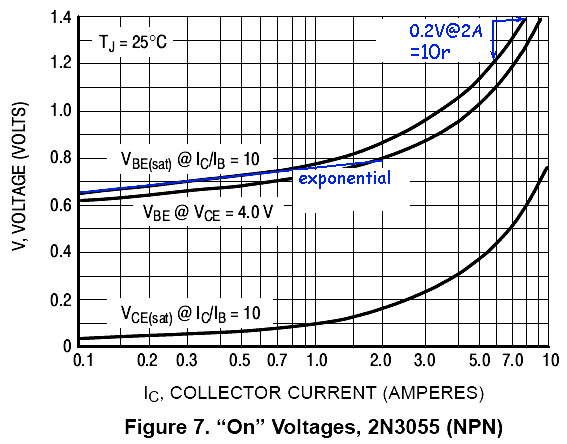

Most datasheets have plots of Vce(sat) as a function of collector current, so one can read off Vce(sat) at 10 mA. For example, for 2SC3955 it is about 120mV (while the maximum listed in the table of parameters is 1V).
The only other variability is ratio Ic/Ib used in the measurement, which can be in the range of 10 to 100, depending on the hfe of the transistor (typically several times smaller than hfe to drive the transistor into saturation).
Where I could, I used the measured Ic parameter from table 8.1a and the 10:1 curve for Vce(sat) from datasheets. Quite a few of the devices have gone dodo even since the book was published. Don't throw a brick at me for using log-log chart:
