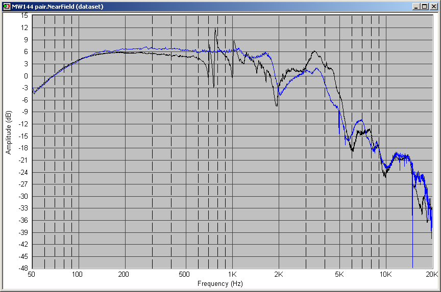

Hi Dan, yes I too have found it useful to do measurements to check the difference between damped and undamped boxes. I used nearfield measurements for my tests, which probably exaggerate the problems, but sure show you when you have fixed them!!
Below is shown two measurements of one of my midbass units, one in the bare box, and one with damping material added. I think it should be obvious which is which! 😉
Note that these measurements were done quite a few years apart, and with different software, however I can assure you the peaks that are there (1st measurement done with speaker workshop) are real and compared to other measurements I took at the time the peaks were substantially reduced, however they weren't reduced as much as my current damping material which is the recent blue measurement.
Tony.

Thanks! that is a great little test.
Could you explain what you used for dampening? Also, Was it placed on the walls or was it loosely placed inside.
