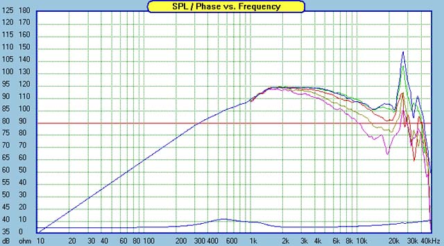

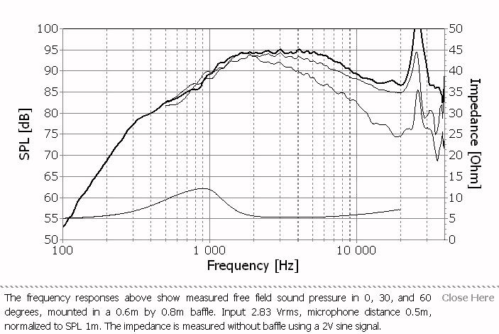

27TBCD/GB-DXT Novel driver(plot below)...maybe. Was not available 10 years ago. Please notice how the on axis and 30 degrees off axis curves are very close together and the frequency responses is -10dB at 20kHz from its 3kHz value? This roll off is always the case with CD transducer because it must be so. One can have flat frequency response or constant directivity but not both without EQ in a wide band driver. Will check out this tweeter. wonder if SEAS ever got the voice coil falling off the dome problem fixed...humm.
My tweeter was custom made and is not unlike the SEAS in response. I do not get doug20 complaint. Forget my tweeter (developed with Forgings) and look at the CONSTANT DIRECTIVITY SEAS and then look at these post #262 of response of the waveguide. No way is that even relevant to constant directivity at the 40 degree response. What these curves are does not have a name as far as I know. To call them "constant directivity" is just wrong. Call it something else. Give it a name you like the sound of like "axial flatness" or just anything that is not already used and well defined, please.
Whatever "Earl" wrote appears more to be a different method of plotting the same old data than anything new. Combining data from many separate graphs into one color plot makes not one bit of difference in the raw data so, what is your point? Waveguides as shown in post #262 do not show constant directivity at the 40 degree line because that line is below the -3dB constant power boundary as defined for beamwidth calculations. If your desire is to redefine standards that have been around for a very long time well, then why bother with any standard and just make up (invent) whatever suits your fancy to prove whatever you dream up? My complaint is calling this constant directivity out to 80 degrees because it simply is not no matter how the data is plotted. If you toss away the standard then yes, it can be anything you wish. Of course with no standards and no defined differences communication is terminated. Is that the goal?

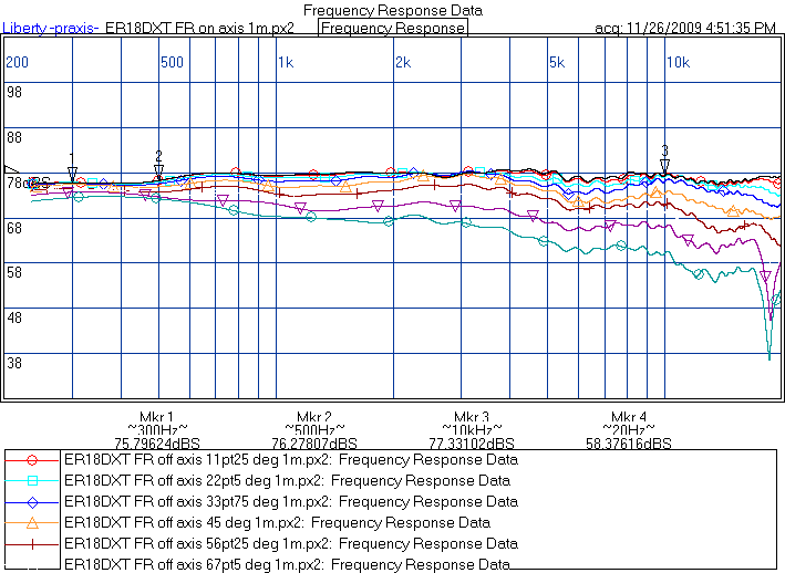

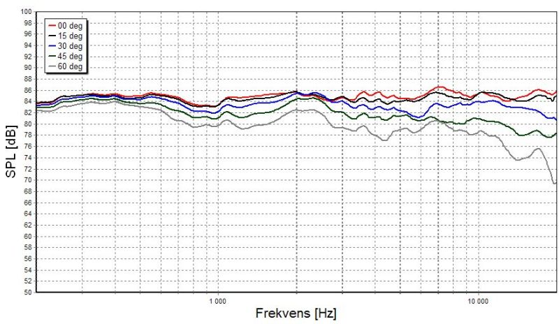

DXT w/HF comp:
attachment.php
And as measured by others with and without comp:
attachment.php
attachment.php
