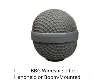

It seems condenser microphones are fragile and need to be handled like instruments. I wonder if people use windscreens with their mics for protection from accidental damage? or primarily for wind/noise reduction? or perhaps both?
Though the primary use is wind noise or vocal plosive ("popping P sounds") reduction, a "BBG" (Baby Ball Gag) type wind screen can provide a fair amount of shock impact reduction if the mic is dropped:
Open cell foam, or "furry" wind screens won't do much impact reduction at all, but can be fitted over a BBG for increased wind noise reduction.
Microphone high frequency response is affected by windscreens, some indoor tests need to be performed to determine how much the change is.
The center ring on the BBG will change the polar response of the mic, while open cell foam, or "furry" wind screens generally just roll off HF evenly from all directions.

Windscreens always introduce some frequency changes, you would need to recalibrate your microphone. Even the protection grid often already makes some errors! (calibration curves are always made without the grid!)
And these hard ones can even produce reflections and mire nasty erors.
So only use when you REALLY need them and then know what you are doing.
