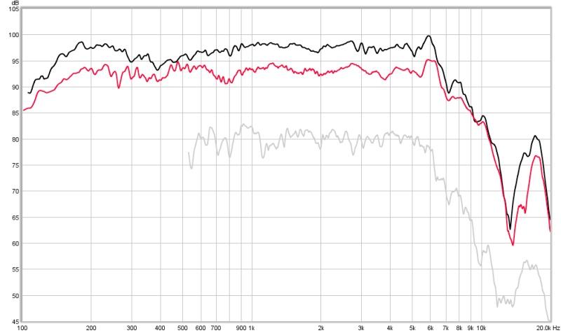

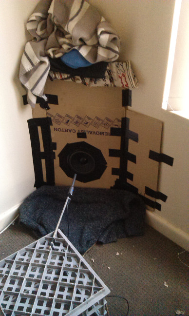

This is my improved test baffle. The top is semi open / a leaky edge, at roughly double the distance of the prior baffle's closest edges.
After taking the photo, I also placed pillows and blankets to reduce floor bounce & 1st reflections.
The graph shows-
RED: old baffle, mic @ 10cm (with 800Hz dip)
BLACK: corner baffle, mic @ 10cm
GREY: the average of several measurements taken @ 1 metre, 15-20degrees off axis.
I think this one correlates best to real world listening, since my head is not equipped with a single stationary ear 🙂
This is all with a slightly tweaked driver - frame caulked, light foam on the back of the cone, dust cap painted. The tweaks mildly improved the impulse plots and HF breakup.
Subjectively it sounds fine, with just the <200Hz range filtered out.
I'll keep tinkering in about a week. I'd like to see how it goes in a minimal crossover system.

Umm, red one looks best; no big trough 250-1k Hz (although that's the kind of curve that can be tweaked satisfactorily with some gentle EQ). Red and black have identical plus and minus 2.5 dB bands. But either would be quite good by real-world comparisons, judged only from those two traces.
Just armchair eyeball comment from me.
B.
Those black vs red are academic plots for problem finding. The mic is too close to be 'real world'.

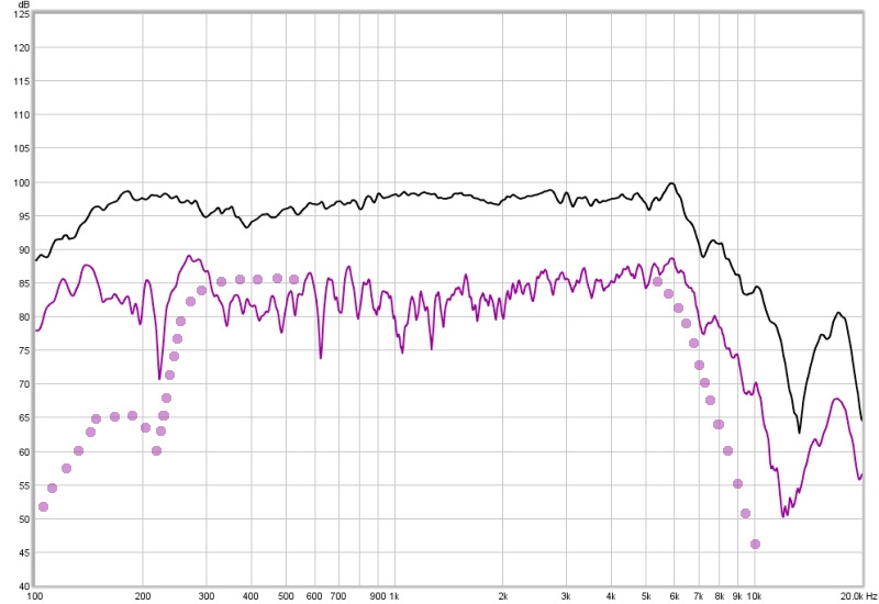

This is another 1m plot (on axis), a somewhat better indicator of real-world performance. The ~15degree off-axis plots don't have the HF rise.
The dots show what I might aim for with a 1.5 way midrange:
Bandpass points 300Hz and 5kHz
Additional driver(s) 300-600Hz
Without a high pass filter, the 2HD levels climb at high SPL, which I guess is from the limited excursion.
