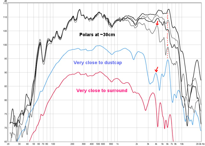

Is there any merit to basing tweaks on close-mic measurements of a cone?
Pictured: tests of a new 95dB 6" mid. I measured crudely (test box with cardboard baffle), but it seems to match the manufacturer's plot pretty well, such as the 800Hz 3dB dip, so I assume my tests are good enough to base some questions on. The polars were at roughly 0, 15, 30, 45 degrees.
manufacturer's data
1) The main peaks in my polar plots seem to match peaks from the dustcap. Would damping just the dustcap be likely to give a smoother HF rolloff?
EDIT: initial results seem counter intuitive. The ~6kHz peak does seem to be from the dustcap, but damping the dustcap as the only mod (using a thin layer of silicone glue) actually makes the 6kHz peak bigger. I wonder if the peak is a cavity resonance, and the glue has made it worse by making the dustcap more airtight. This is going to need lots of trial and error.
2) Any tips on using (REW) waterfall / impulse plots to guide the tweaking process?
EDIT: a non issue / good result. These plots are already seem good, and damping makes the driver settle slightly faster.
3) Any idea what would cause that 800Hz dip / tips for reducing it?
EDIT: turns out it was the test baffle
4) This test-and-spot-tweak methodology seems like an obvious idea, but I don't recall it being done or discussed by amateurs. Why not?
It seems that dammar and other cone tweaks were discussed more often a few years ago - before the advent of cheap and easy ways to test their effectiveness.

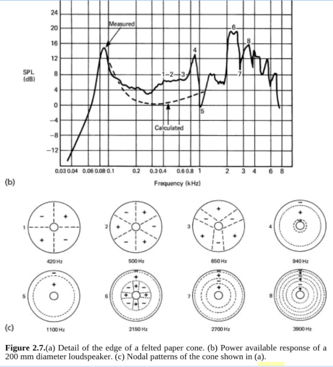

...bell modes...

The 800 Hz dip shows up at the dust-cap, and the surround, and every polar.
If it's a bell mode then shouldn't there be some place where it doesn't cancel?
Maybe that's mid cone, perhaps try a sweep there.
Best wishes
David
It's probably not a bell mode if it shows up everywhere. Most LF drivers have a spider resonance in the region of 400 - 500Hz. This driver has a fairly high Fs, so perhaps the spider resonance is at a fairly high frequency.
I would suggest taking an impedance sweep. If you don't see a spider resonance before 800Hz, then this is probably it.
Paper coned pro type drivers normally have very little or no cone / surround dip, unlike paper coned hi-fi drivers with a rubber surround.

Your measurements so far look like the test should be valid.
So if it doesn't show up mid-cone then, like Hennie, I would suspect that it's not a bell mode.

The close mic tests: pretty consistent around 800Hz. The dip is everywhere.
The far field tests are very position dependent. If I take many samples at almost the same spot, a few will be perfect, but most will show the 800Hz dip.

If it's not a bell mode then what does cause it?
I hope it has a simple cause: driver mounting.
Loudspeaker Measurements
My ripple looks very similar to what Troels demonstrates with his Vifa XT25TG flush vs/ non flush plots, at the bottom of the page.
...so I should try better mounting + the mic setup he recommends.

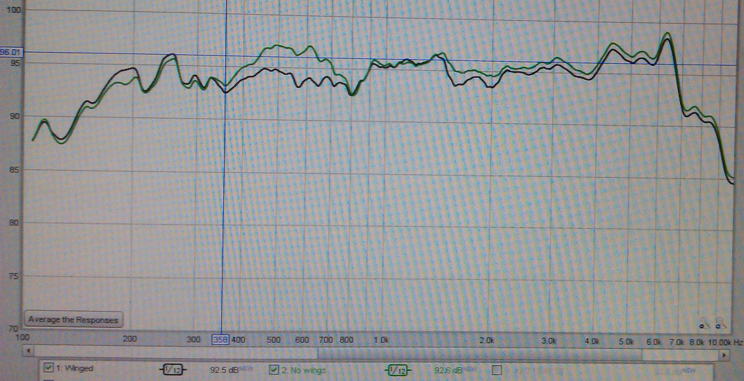

The 800Hz thing seems to be utterly swamped by baffle changes. This is the difference adding wings makes (apologies for the naff image).
No wings (green) is a ~40cm wide baffle, boosted half a dB for clarity. Black is the same thing with extensions taped on.
If I want to get really academic, and isolate driver-specific anomalies, I need to build a ~infinite baffle.
For now, it looks like I'll get most benefit / widest smooth bandwidth by:
a) Sorting the < 2kHz range mostly by finding the best (most benign) baffle size & positioning
b) damping the peaks > 4kHz with cone tweaks

Still there however- I think you are correct to try to fix this.
Yea, reduced but still there. I haven't yet been exhaustive about pinning down the source; I only changed my baffle in one dimension.
Next step: make a crude soffit mount (baffle + room corner + duct tape). If that 800Hz dip is no longer evident, I can be pretty sure that it was a box / baffle anomaly.
This baffle sensitivity has surprised me. I had thought that by getting the mic very to the speaker, the enclosure would become near-irrelevant.
