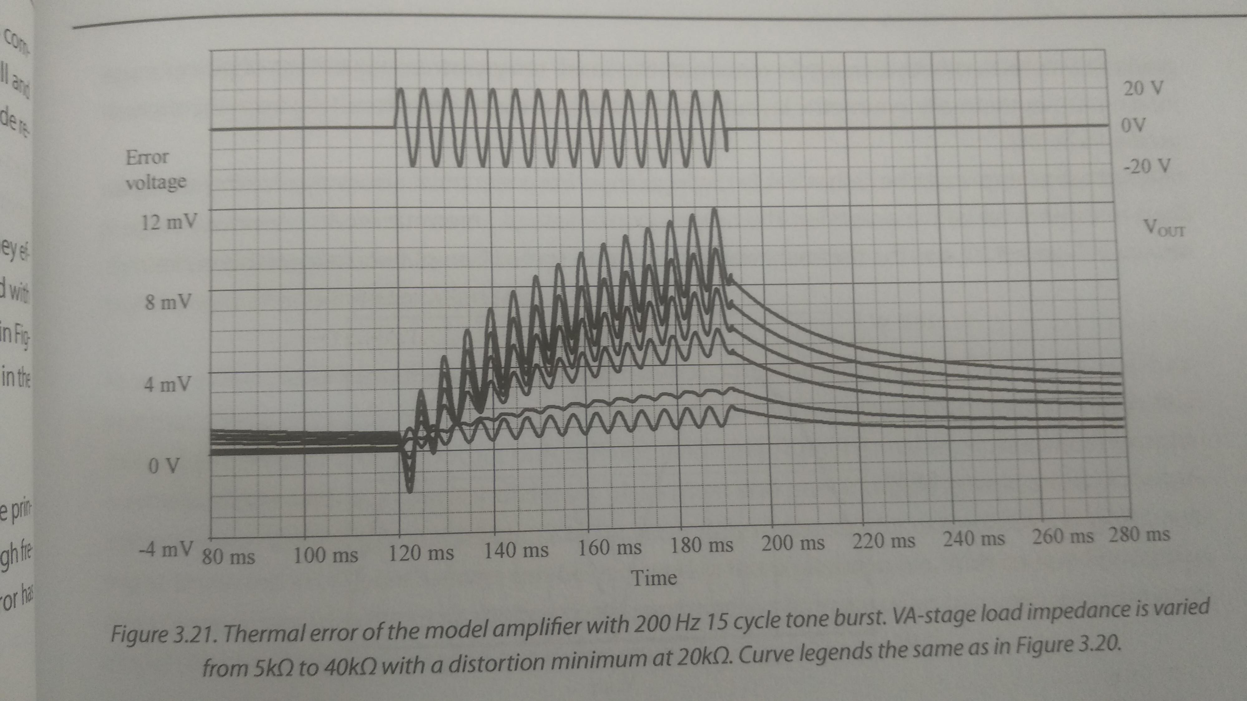

Thermal error.
One of my amplifier after play heavy bass, in less than one second sound not right, according to a friend who worked as sound engineer. Maybe because of thermal error or other dynamic error? It is not clipping for sure.
"Cleanliness of sound" is not equivalent to "musical sound". The latter is often the result of second harmonic distortion or some other distortion that sounds pleasing to most people.
Dr. Gedlee research to harmonic profile of distortion and found human is sensitive to high order harmonic distortion.
Hugh Dean (AKSA) advocated to make monotonic harmonic profile of distortion. I found class A amplifier have monotonic harmonic profile of distortion, but class AB amplifier can have too, like Pelatuk amplifier, one of my amplifier. But my personal preference is I like low distortion in all audio frequency. Bob Cordell advocated to make distortion at 20 kHz is lowest as possible and I agree. Distortion at 20 kHz should almost same level as distortion at 1 kHz.
