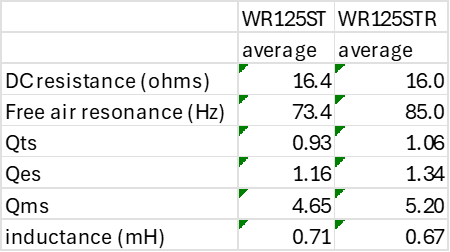

  1. I'm using pairs of CSS WR125 drivers. I got their T/S parameters from the pdf file included in the documents. (see CSS-FR125S-wr125-dimensions)
  2. I enter these parameters into VituixCAD. and modeled a closed box with Qtc of 0.8. It said 18.6 liters for 2 drivers in parallel. (see VituixCAD showing 18.6 liters)

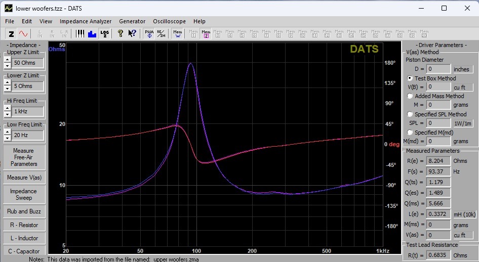

  6. I also measure the impedance (of both drivers in parallel) with the Dayton DATS V3. The result says my Qtc=1.18! (see snip of DATS data)

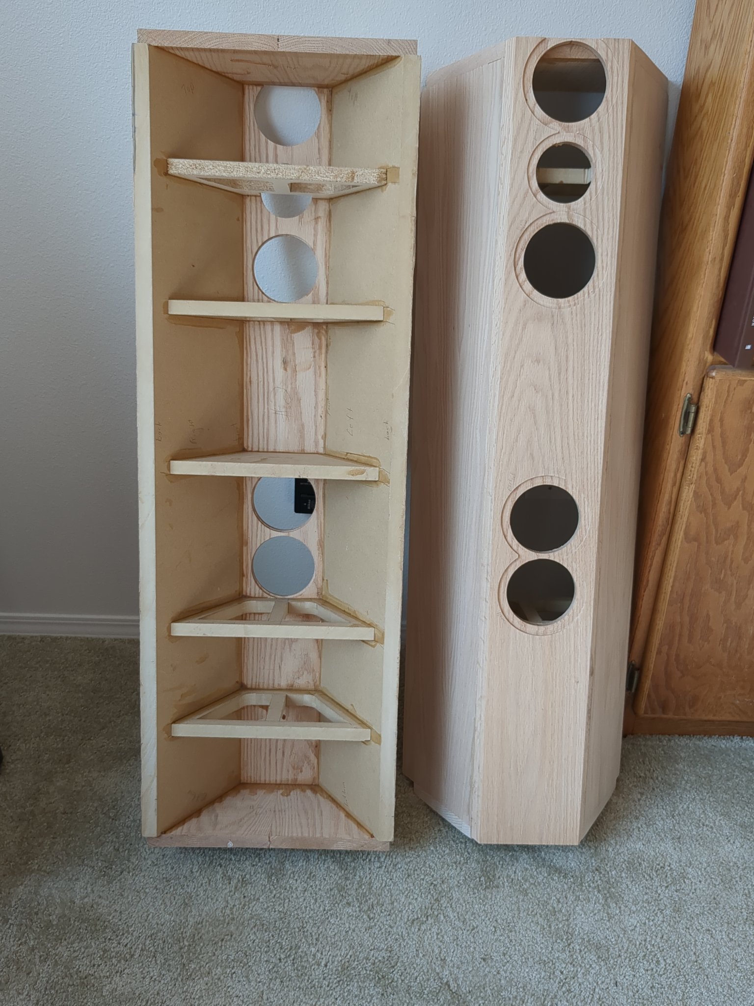

So I'm kinda' stumped, and hoping there's something wrong with my measurements. One thing I'm considering is that my cabinet is too tall and skinny. the cross-section is a trapezoid with a 5" baffle, an 11.75" back and 5.75" deep for a cross section area of 48in^2. Then it's 21.25" tall. Did I accidentally make a transmission line without an opening?

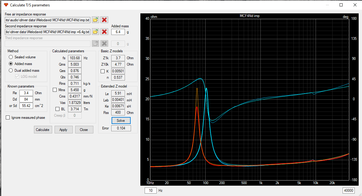

If you have a DATS and a measurement mic, first step should be to throw spec PDF away. Use real measurements of your drivers for design. Measure complete T/S parameters with DATS. Best method would me to use added mass method, and run T/S calculations right in VituixCAD. For a speaker of this size, about 5g added mass should be all you need, but check that the measurement with added mass has a Fs decrease by at least 25%.
In VituixCAD T/S calculator, solve for "Extended Z" parameters for accurate impedance characterization. Within simulation of the cabinet with your measured T/S parameters, right click on the chart and select "show effect of impedance". Next, adjust Qa and Ql to some value other than 100 to simulate some fill and some leakage.
Example:
Now compare results again and see what it looks like.

Yes. I designed be box using the Manufacturer's specs. Once built, I used DATS to measure 2 drivers in parallel in the cabinet. I measured both top pair and bottom pair. They were identical, as they should be.

You can't see from the photos, but the box has 2 18.1 liter chambers, each with 2 woofers in it. that middle "brace" in the photo is a bulkhead separating the upper and lower chambers. The other 4 are just braces.
Well, I have good news everyone. Last night I hooked up both speakers to my stereo system (without tweeters), and they sound fantastic! According to my measurements, I should get a boomy sound around 100Hz with nothing below that. NOPE! I didn't hear any boomy-ness, and the bass was surprisingly deep. So my current theory is that I did something wrong in my measurement. And my best guess is that it has something to do with:
  • measuring 2 drivers in parallel when the software is expecting 1 driver, for both the frequency response and impedance.
  • measuring drivers which had not been broken in. I know Cal (the gentleman who sold me these beauties) broke them in for 24 hrs, but that was a "while ago".
I appreciate the advice from olsond3 and DcibeL, but it's a bit late to re-measure the drivers and design a whole new cabinet- especially considering that I like the sound so much. I will save that advice for my next pair of speakers.
My only challenge now is designing the low pass filter for the lower pair. It's going to be a 2.5-way system. I'll break them in for a few days and re-measure impedance and nearfield and see where I am.
