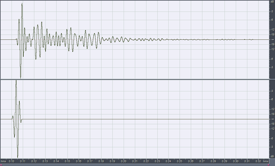

320 Hz is well above the modal region. When you see decays like that it can only be due to reflections. There is a strong reflection from somewhere and the impulse response should tell you that. I'm betting on a floor or ceiling bounce. There is nothing "modal" about this problem.

Same freq. as im my previous post, this time with a short shaped burst. Doesn't look like a single reflection from a simple floor/ceiling bounce. More like a repeated reflection that will become a mode when the exitation is long enough. The shorter pulse has wider spectrum, though, which mus be taken into account.
The Linkwitz graphs is just exactly what Elias and I are concerned with. My understanding (and perception) also is that we hear the envelope pretty well. Also we know that in the bass region the hair cells fire only during the positive (relative) pressure halves of a waveform, which explains a lot of otherwise unexplainable phenomena (like sub-harmonics, ear "IMD", and audibilty of absolute poarity with transient asymmetric waveforms -- the latter I recently backed up with a clean ABX blindtest using sort of an "electric bass drum" as test signal).

gedlee said:I have no idea what the attached link is supposed to show
The top trace is the signal and the bottom trace is what the mic recorded. The first one is at a frequency where there aren't any significant room effects and the recording is pretty clean. The others are at frequencies where there are significant room peaks or notches and they don't look so pretty.
Try it for yourself. Download and play http://www.linkwitzlab.com/images/sound/100mbst4.wav . It's "a signal consisting of four bursts with cosine envelope over 10 cycles of a 100 Hz sine-wave", repeated 3 times. If you can distinctly hear the 4 bursts, your system is doing okay at 100 Hz. If it sounds like one long burst, it isn't doing so well.
Ok, I tried it. I could hear the modulation on all the systems that I have, including my PC speakers. SO what? The bass in the PC speakers is awful and the bass in my HT is superb and this test came out the same in both situations. I simply don't get the relationship between this test and anything relevent about the subjective perception of bass.

The structure of my test signals show the effect even more pronounced than Linkwitz'. This is because of the longer/stronger exitation and the nature of the shrinking gaps between the individual bursts, plus the phase relationsships I mentioned.catapult said:Try it for yourself. Download and play http://www.linkwitzlab.com/images/sound/100mbst4.wav . It's "a signal consisting of four bursts with cosine envelope over 10 cycles of a 100 Hz sine-wave", repeated 3 times. If you can distinctly hear the 4 bursts, your system is doing okay at 100 Hz. If it sounds like one long burst, it isn't doing so well.

I think the fact that we can all hear the bursts is significant. It shows that there's more to bass than the steady-state condition. The bursts are similar to certain musical sounds so it's not an unrealistic test.
