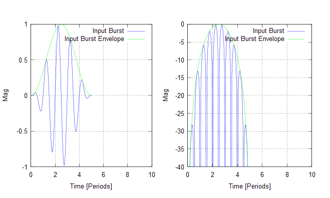

I thought some explanations might be helpful what is actually going on. So this is the shape of the excitation signal I'm using for these measurements. It's a short burst of 5 cycles of sinusoid modified by a shaped envelope. The picture shows the signal and it's envelope in linear and dB scale.
This signal is copied from the idea from Linkwitz.
The burst is short enough to give quite good resolution in time domain, and the shaped envelope helps to keep the spectral regrowth in minimum and the bandwidth in acceptable limit.

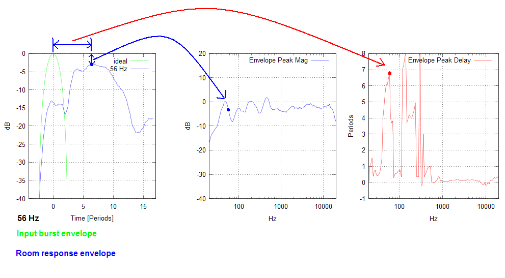

Here's the method I use to calculate the envelope peak magnitude and the envelope peak delay.
The left hand side shows the input signal envelope and the blue is the measured room response envelope at a particular frequency (56 Hz in this case). The peak point of the measured room response envelope defines the peak magnitude and peak delay as shown in the middle and right hand side pictures.
To get the freq responses as shown in the picture the input burst frequency is stepped in 1/12 octave intervals and the above is repeated.
Hope this helps 🙂

Hello Scott,
The results shown are almost purely due to the room effects.
See for example the measured monopole response picture:
http://www.diyaudio.com/forums/attachment.php?s=&postid=1884495&stamp=1248117969
The left hand side shows the input and measured envelope (blue). One can see that at first the signal tries to come but then first reflections cancel the signal away and it does not follow the input envelope but then later arriving reflections over emphasize the response. This is due the monopole having simple too many reflections to all directions because the lack of directivity.
If we have directivity we have less first reflections and the room response envelope follows more closely to the input envelope.
Important to note that not all the reflections are so bad. The first reflections are the worst! So reflections please do come, but not yet! Wait for a while so I can first hear the music recording, and after that I may be willing to listen to reflections too!
The key is to minimise the first reflections in a time frame compared to periods, since the ear integration time is not constant with frequency. And to be able to do this at low freqs the source needs to have directivity.
- Elias

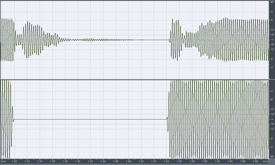

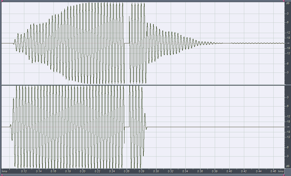

Hello,
This is a very good picture and tells many things. As I see the time axis the signal starts at 0.1 and steady state begins at 0.2. So there is a room response transient state duration of 100ms, that's about 20 periods at the measurement freq.
Obvious question considering this thread is have you done any tests comparing different directivity speakers to investigate if the transient state duration or slope is changing?
I don't know what was the speaker directivity for this test, but according to my measurements there should be a noticeable difference when using higher directivity source in this freq range of 240Hz.
Then one can think how this transient state is perceived. I've noticed in my listening tests that even if I change the envelope over the couple of periods only at the starting of the burst there is clearly perceived difference. In this room the transient lasts 20 periods, so that should be easily perceivable.
How do you hear it?
Another thing is of cource the transient decay, but there should be no questions about it's perception: It is easily perceivable - That's why they add artificial reverberation to studio recordings 🙂
- Elias
How do you hear it?
- Elias
KSTR said:See attachment, for a higher order mode at 240Hz in my room, listen position at point where a boost results
Of course at the real listening spot and with my normal listening conditions (doors&windows open, mostly) it is not that bad.
What I learn from this that things happening in the modal range of a real room are nothing intuitive at all and very hard to predict and track down what really is happening. Best thing of course is to avoid the exitation in the first place with directional speakers located at the right places and ranging from dipole to cardioid and anything in between (hypercardioid looks very promising to me), for upper bass and midrange. For lower bass multiple subs (DBA included) looks easier to me to get best results.
- Klaus
No, not with this setup. Those were standard monopole 3way-floorstanders, and 240Hz happen to be about the xover between 8" woofer and 4" midrange. But I have listening experience with dipoles and know what difference it makes, especially in the bass range.Elias said:Obvious question considering this thread is have you done any tests comparing different directivity speakers to investigate if the transient state duration or slope is changing?
Just as it looks like, the buildup/decay is clearly audible. But I have nastier freq spots than this, at 320Hz for example the buildup/decay is strange, sort of a hick-up. During buildup the hickup effect is pretty well masked, but on decay it really sounds funny, one can hear it.Then one can think how this transient state is perceived. I've noticed in my listening tests that even if I change the envelope over the couple of periods only at the starting of the burst there is clearly perceived difference. In this room the transient lasts 20 periods, so that should be easily perceivable.
How do you hear it?
- Klaus
