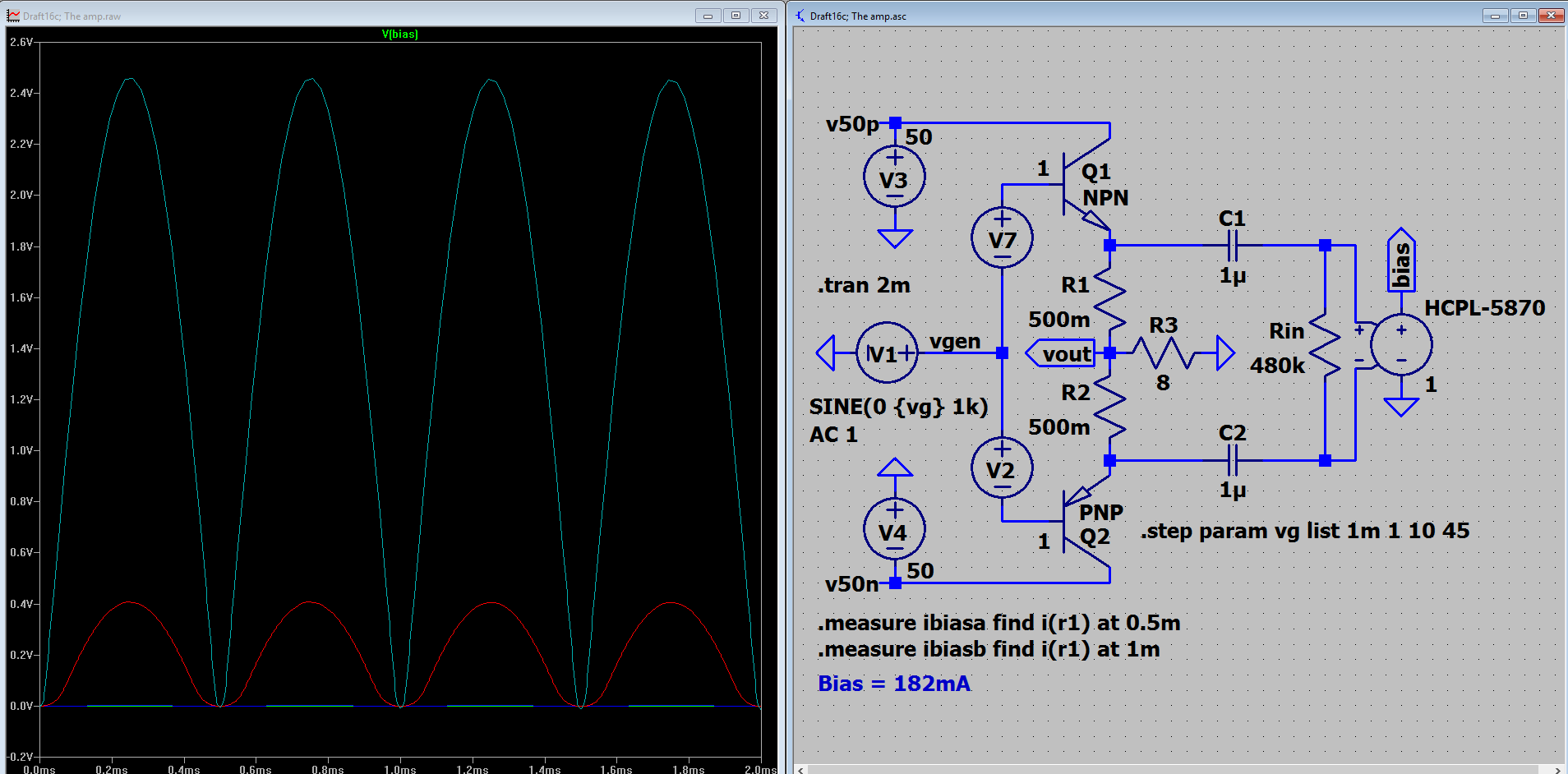

Q: Is there a simple (or even not so simple) method/circuit available/published to measure the DC-bias of an operating class AB (or A) amplifier.
The intention of the measurement is to create an automated bias adjustment that needs no manual setting of the bias.
Also one could create an measurement device to check bias, under load, in a operating amplifier.
In both cases it would be needed to measure the absolute value of the bias current with an reasonable accuracy.
Edit: Please show a [simple] schematic of your solution 🙂

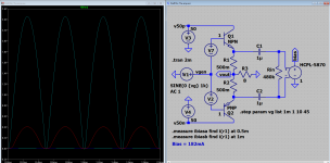

Edit: See post #13, I would like to be able to make a measurement of the DC bias in this amplifier (in any state of operation) [the answer would tell me 182mA see simulation result]
Edit: How to build such an device, and if not possible then 'why not'.
Edit: I am looking for a known/documented method/device/patent to measure DC bias in a operating/functioning amplifier at any level and frequency. Any hint at an idea/patent or otherwise will be appreciated.

Bias current in the emitter/source ballast resistors. I will draw and show an example circuit.

If the resistance is known you could use an instrumentation amplifier to measure the voltage across it...
Depending on current and voltages levels, a simple BJT can do the job, but you can complicate it as much as you want.

No I just want to know the bias current (e.g. voltage) in (over) the ballast resistors, averaging both would be best. I would be happy to have a method of measuring a single resistor or both.
Is this measurements for temporary use while adjusting, or definitively included in a feedback loop?
Where do the outputs of the measured go?

The measurement could be used for automatic amplifier bias adjustment, it could be used for validating/checking the operation of the amplifier (on the bench with signal attached). It would be most useful (for any purpose) if the measured signal was ground referenced.
I can not see (see #13) how this http://www.mouser.com/ds/2/678/V02-3479EN-DS-HCPL-7850-01Oct20120-909312.pdf gets the bias measured.
