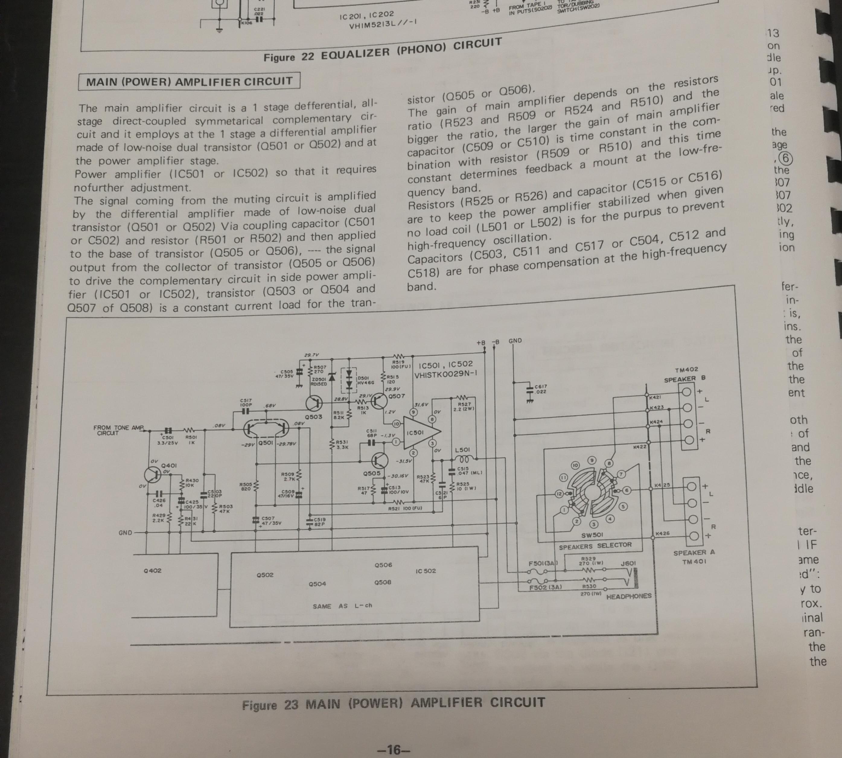

Hi all,
Can anyone tell me if it is possible to measure and adjust the idle current on an Optonica SA-5105. I have a service manual and there is no mention of idle current adjustment at all.
I am very new to this, so perhaps I missed something.
Jamie

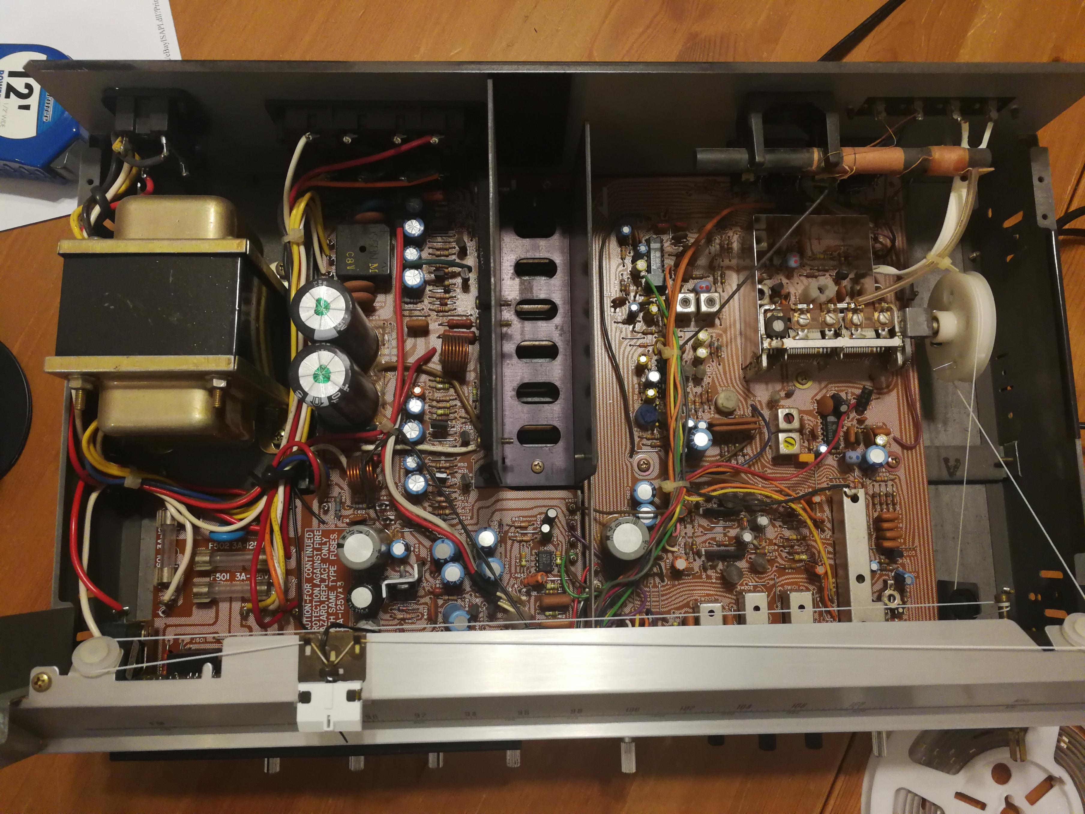

Thanks for the reply. Here's the schematic and a photo of the inside of the receiver. Amps are screwed to the left side of the heat sinks.
I probably shouldn't even be messing with this thing. I just bought it. It was new, in the box for 40 years, still in plastic with all the paperwork. It sounds great to me. But I'm curious, I'm 51,and I need something to fiddle with.
