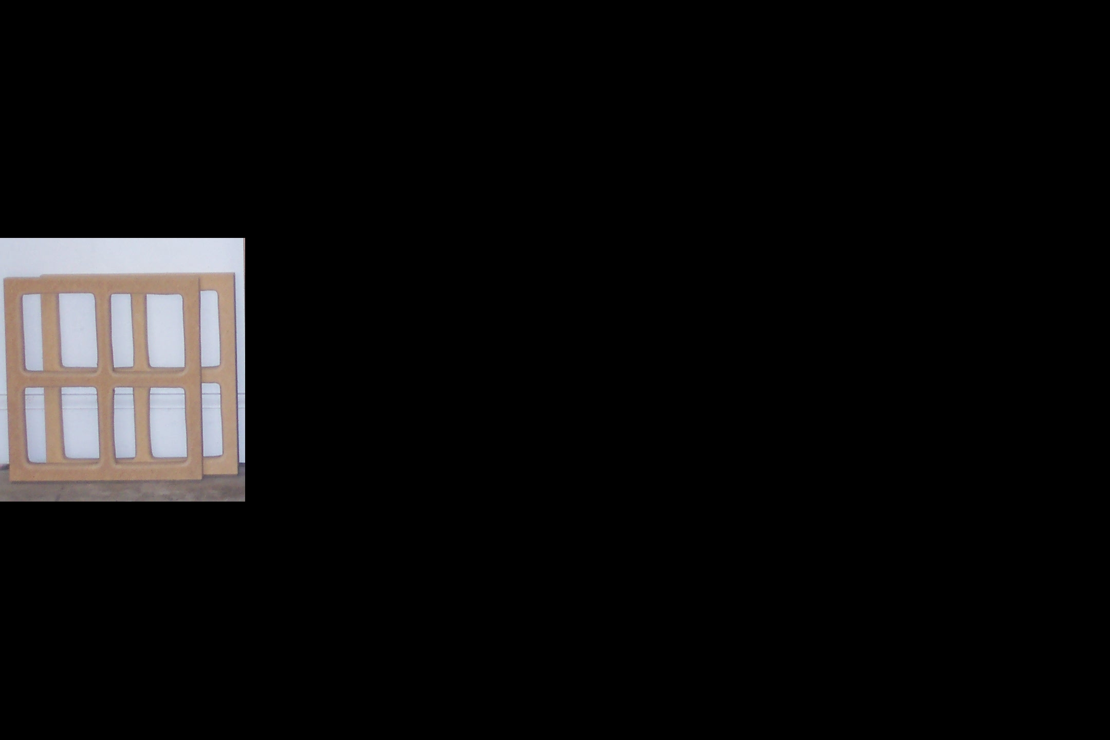

A window brace is a piece of plywood,whatever, that fits between the sides of the cabinet and has a hole(s) in it. The classic window brace has an X across the cabinet. I generally use a brace with a circular or elliptical hole in it.
Bob

concerning window braces: i have heard from many seasoned speaker builders that it is important to space the braces unevenly, so the resulting panes of wood (between the braces) have different sizes/length. That puts them at different resonant frequencies.

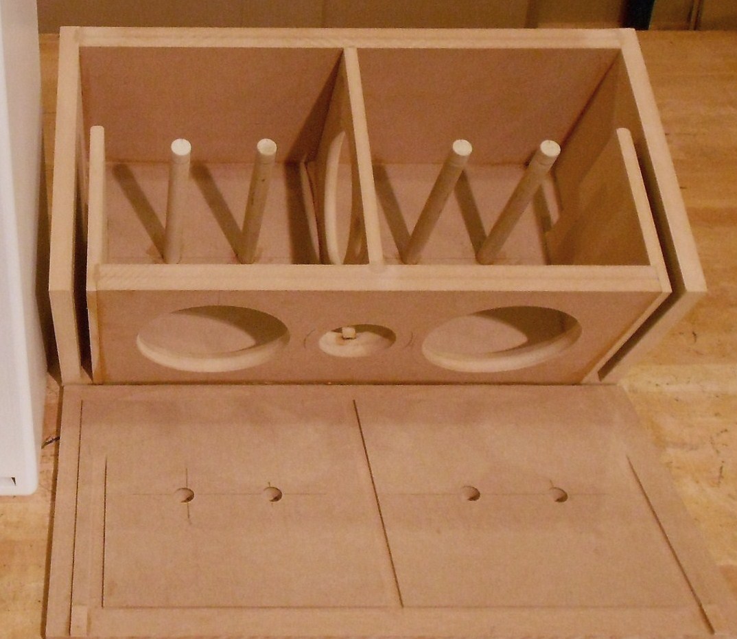

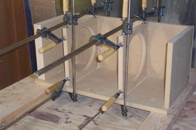

This is what I've been doing for bracing, I think it makes sense.
- double 1/2" medex laminated for front and back
- 3/4" sides/top/bottom
- center brace
- dowels as shown (3/4")
The ploy is that the front/back/side are super strong and top/bottom are small enough where bracing is not needed.
