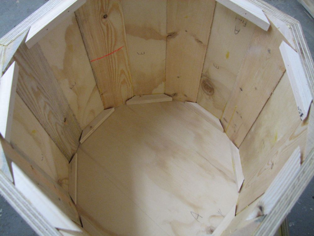

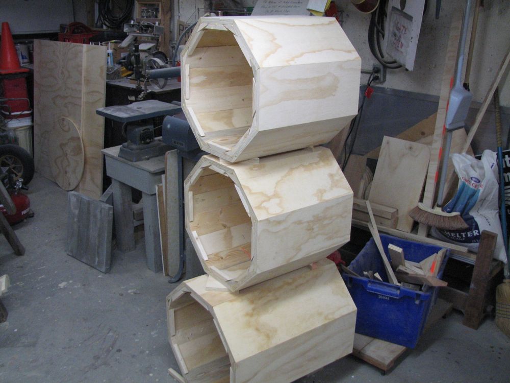

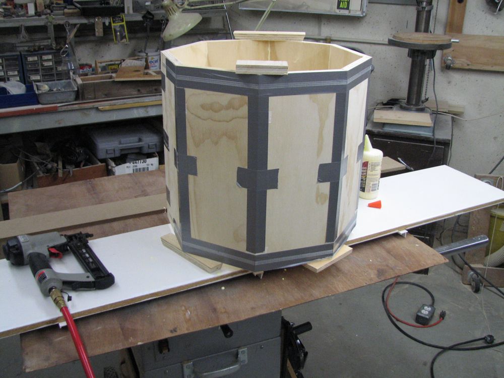

On the brad nailing.. I wont do it again and was trying to have speed for some small cabs but not crazy about fasteners in cabinets..
Brad nails are fine if used onn the inside of the cabs.
Ever had a nail buzz in a plywood enclosure such as a bass bin?
No.

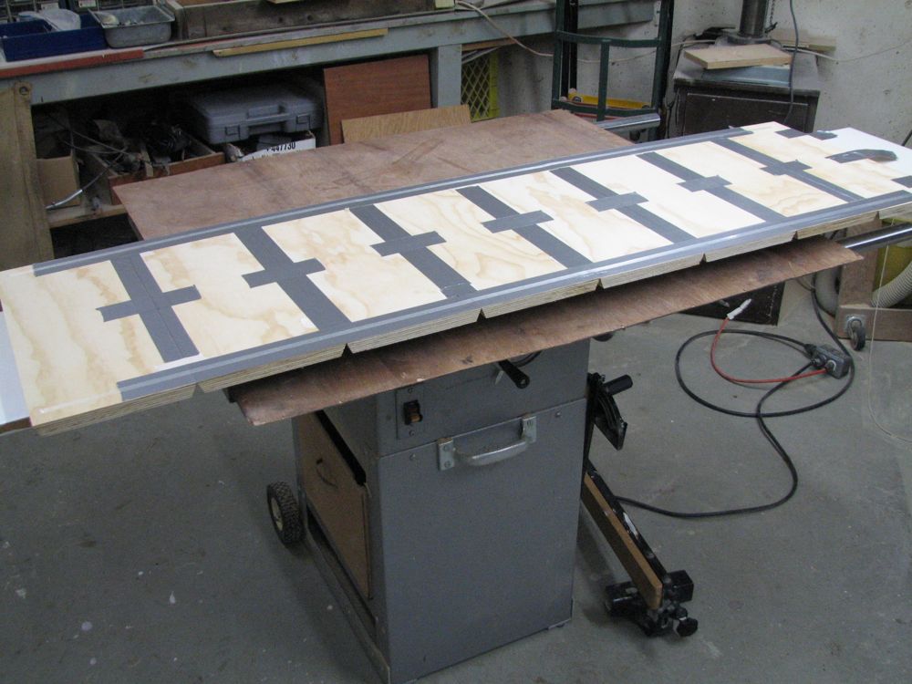

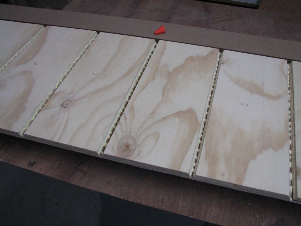

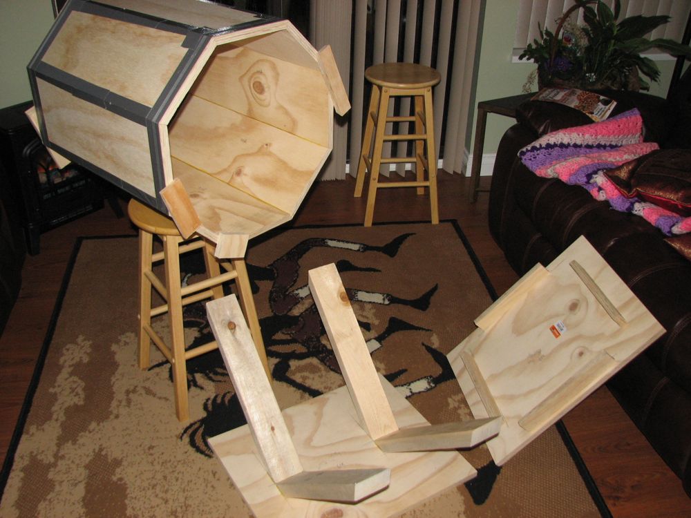

A temporary method of clamping could be to use a strap and clamp system
Straps are good, so is 'tape and roll' with cleats if the box is not square. I don't have full pics here at the office but if I remember when I get home... It's a great method if you are careful.
If you use screws
These seems old fashioned to me. If you don't have the necessary tools, fine but otherwise, how long do you want your project to take?
The glue lines will often show
Keep your wood inside for 2 weeks before starting.
