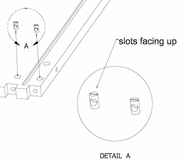

I think those screw in T-nuts are nasty, and no use for good prescision.
The proper fixture for wood is barrel nuts, also called cross nuts.
The only downside is that it leaves an exposed (screwtop, the top of the nut, used for alignment).
I attach two images of how they are used normally...
I thought the OP was looking for a way to Make a box he could open and close. I reccon with some gasket material, it may be good enough for a airtight seal, as you could tighten the nuts way beyond what you could do with one of those T nut jobbies.

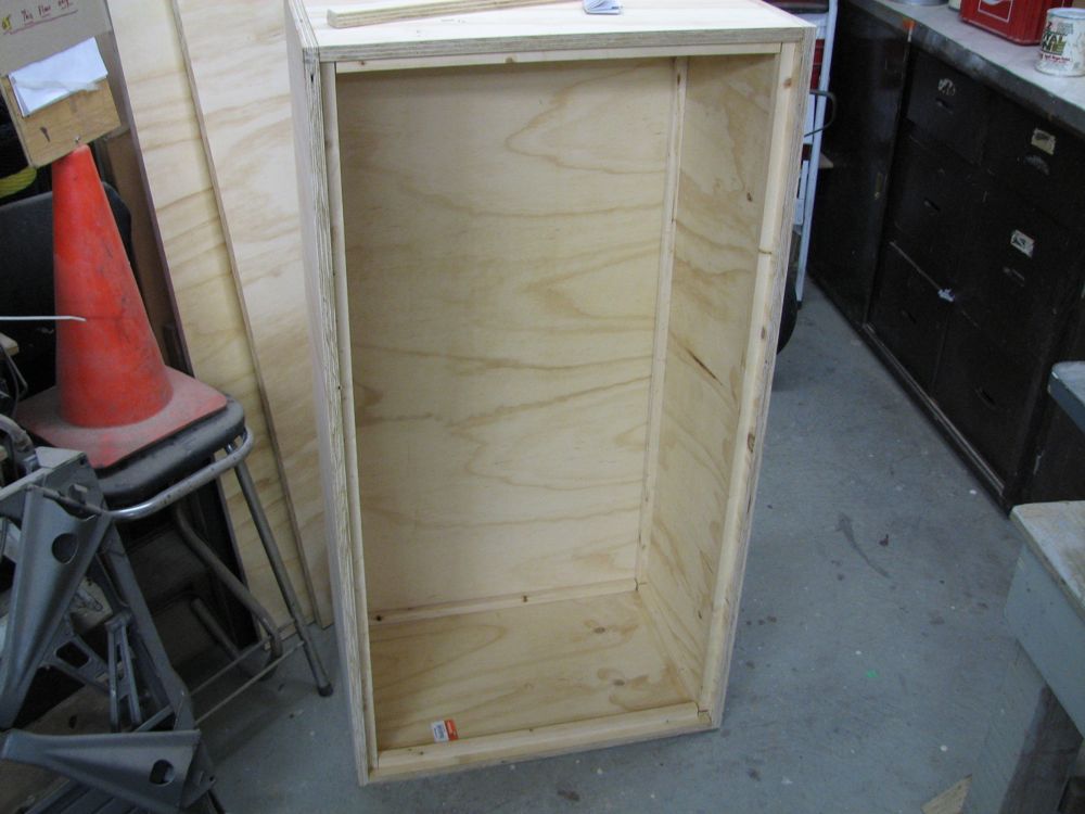

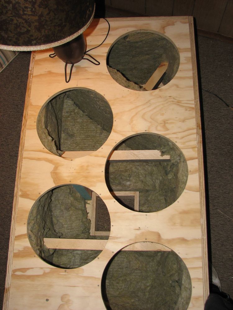

Cleats are the small strip of wood on the inside corners. See pic. They could be called inside corner blocking but that takes too much time to type.
Brad nailer is a small nail gun for finish work. The nails have almost no head.
Fire means use a gun yes.
Use 1 1/4" nails on 3/4" material and clamp (sometimes you can use straps) before you nail where possible.
Put braces (either stick braces or shelf braces) in front to back and side to side spacing them unevenly to break it up into different panel sizes
