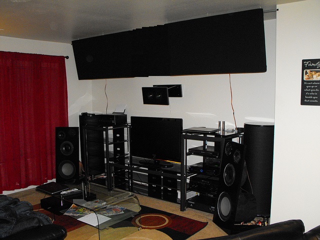

There is zero EQ on the 21's - simply a 18db/octave crossover @30Hz. I have tried the 21s in four configurations. The first was all four on the floor with pieces of wood holding up the magnet - very impressive. I then had them stacked (2 per side) with no baffle - still not bad. I then added a ~2'x4' baffle - a pretty good gain in performance. Current setup is 2'x4' baffles suspended from the ceiling - mainly space restraints and the wife likes them. There is minimal baffle movement at large (relative anyway - my best guess is 5-6mm) excursion.
The crossover does eat a lot of headroom before the amplifier - I'm using a behringer A500 (4ohms/channel) with the gains all the way up (almost). I am also using a consumer to pro-level booster with it's gain almost maxed.
With this setting they blend very well with the mid/tweeter combo. Note - above ~60hz the 21s need very little power. It is not until the 30-40Hz range where the amplifier really starts pumping out the juice - and that's if I'm listening at high(er) volumes. FWIW - the four of them have handled almost club level volumes without over-excursion with the exception of a select few songs that dip into the 20Hz range. I can activate the 40hz high-pass filter on the receiver and volumes can get into the ridiculous very easily.

I'm glad that this old thread popped up. I am very interested in something like what is shown hanging from the ceiling in this pic from post 15:
The reason that this is interesting to me is not because they are using the MCM21" drivers but because this kind of mounting of an open baffle near a wall is of interest to me. Once you start to bring the wall into the equation, you get something that behaves more like a line than an open baffle. In the picture, the baffle is far away (e.g. I am guessing 12"/30cm or more) and all sides are open. This means that the Q of the line will be low. But you still get delay from front to back. Delay is the reason that the low frequencies do not suffer from a complete acoustic short circuit and cancel out. When the line becomes smaller and sides are closed, it will tend to have a resonance. John Kreskovsky has explained that for a U-frame this resonance causes a negative group delay that tends to cancel out the delay. Adding stuffing helps to damped the resonance which reduced the group delay, and the low frequency behavior is better.
I have a couple of drivers that I have wanted to try like this, in a large open baffle near (and parallel to) a wall. I need to experiment to see how close you can get to the wall before the resonance of the cavity starts cause problems. This space could also be stuffed, although I am not sure how much good that does at low frequencies. It may reduce higher modes, however.
The advantage of this approach is that a rather large open baffle subwoofer can be placed out of the way, at the wall, but you still get the benefits of an open baffle system. Compared that to a U-frame, where a long length would require it to stick out in to the room, and you can see the benefits right away.

My 21's are still hanging from the ceiling. I love them there as they do not take up any floor space. I did draw up some more OB designs, however I do not have any plans to build them as of right now. The ported 21 idea was just that, an idea and was mainly looking for feedback. I feel that you can get much more bang for your buck and space by going with some SI HT 18s or some FI subs. I think those would be better choices. If I had to do it all over again, 4 18s from either SI or FI would be the ones I'd get.
@CharlieLaub
The OBs are about 24" out from the rear wall. The right panel is only a few inches from the wall and the left is about 6-7" away. The total open area is rather large, so I was not expecting any resonances to occur. If my room was larger, I would have much liked to keep the drivers on the floor to get some good "bounce" and a bit further from the rear wall.
