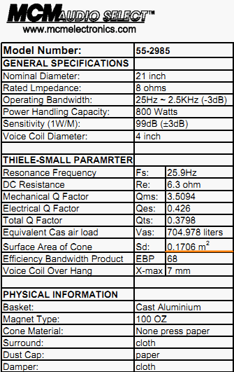

Where did you get BL = 20.13200 as i don't see it in MCM's data ?
I inputted that figure into WinISD v.0.7.0.809 & together with the other parameters i get Sd = 0.1492 which is so close to yours as not to matter.
But Sd = 0.1706 m2 in MCM's data, which would make a difference !

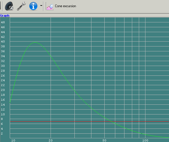

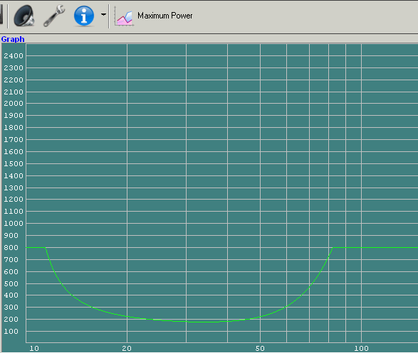

What power did you input into the Signal TAB ?
I made the following observations about MaxPower & Excursion as shown in my screenies.

Hey Zero,
I'm using WinISD 0.5 alpha Pro. BL was auto calculated as was SD. FWIW - the actual cone diamater + 1/2 surround = ~268.5sqin (if I remember correctly - based off of 18.5") = 1732sqcm. I'll have to see what that comes out with.
I think I entered around 4W for the signal - but of course that's a 0db gain for the LT. I have since messed with the model again, by changing the HP to 9.8Hz, LT (f0=50,Q0=.88,fp=14,Qp=.54) This drops the gain down quite a bit at the expense of about 2db @10Hz or so but an increase of about 3db above 20Hz. I can live with that.
And after that it quickly runs out of headroom, due to Excursion limitations ! I have to say that personally, i would rethink using this driver in such a project. But it's good to experiment without making sawdust etc, just to see, what if. Sometimes things do work out 😉

I do not see any benefit of using this driver for home applications. The box required is huge and with a LT circuit you will probably be getting some motor noise from it if you push real power through it.
