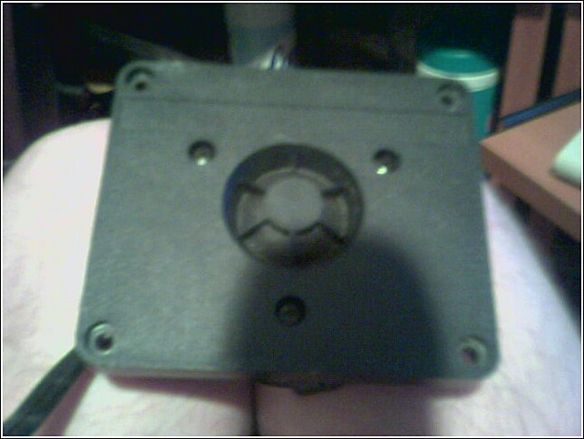

I have recently acquired a number of square 1 inch soft dome tweeters. manufacturer is Philips of Belgium part number dd0100972. after some research roger russell confirmed them to be McIntosh units used in the xrt 20c McIntosh loudspeaker. they are supposed to be comparable to the round Philips AD 0163HE-T8. does anyone have basic specs on this driver? currently running a 1st order x-over at 3000hz and am quite surprised by their sound. While they may not be morel mdt33 (currently in my 2ch setup) they are darn close! any support for this driver is welcome as I am planning to use them in small mtm actively x-over for my computer system.

Here it is
The AD01630 came in two versions, the T8 (8 ohms) and T15 (15 ohms).
In both cases the resonance freq. is 1300 Hz and a power handling of 4 watts (crossed at 2 kHz) or 6 watts (crossed at 4 kHz). Power handling seems very conservative (I drove some of those at very high levels).
Manufacturer response curve is quite flat, with a decline starting at 15 kHz.
Nice and smooth vintage driver, but quite surprising (although true) to find them in - so called - high end speakers.
the reality is we don't need 20khz, we merely want it. 15k is fine. as long as the tweeter is fast enough.. then it's all good. Try mcbride or 'q' audio, out of canada. he used to sell lots of them. he might have specs.
