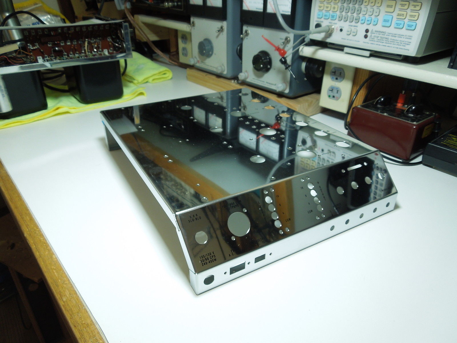

I'm looking for a reproduction chassis for his Christmas present; otherwise he should have all the parts he needs.
Good luck. I don't know that there is enough of a market for people who build McIntosh clones for someone to turn a profit on reproduction chassis. I could be wrong, though.
That's a pretty valid point. There are a lot of barriers to entry for cloning one so odds are pretty slim that there's a bustling market for reproduction parts but I'll post back when I find one. This thing's going to be hefty too with all that iron on a single chassis.
They pop up on eBay every now and then:
McIntosh MC275 MC 275 New Reproduction Chrome Chassis | eBay
Good luck, and keep us updated!
P.S.: Getting the emblems/logos is the hard part. Been (not very actively) looking for some for my MC75's for quite some time now...
I'm very happy to be proven wrong!
