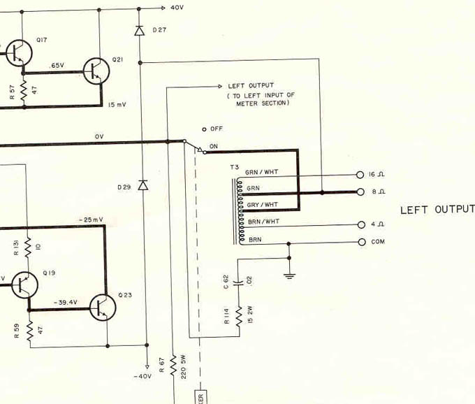

You right the autoformer is an inductor. I found an old schematic of a MC2505 amp I owned. Yep back then folks would give you a schematic of the amp you purchased at least Mac did.

From the schematic I'm gonna guess that the amplifier has a 6 ohm impedance prior to the autotransformer.
Thanks for the schematic! It helps a lot.
