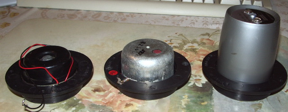

Hi Alan,
I've got a stash of HF1300s squirelled away.This includes a pair from some early Celestion Dittons.These have smaller magnets and appear less sensitive as well as sounding less satisfactory than the "larger"(normal) magnet units.
Most of my samples are of 15 ohm impedance.I think the issue of 15khz extension was more related to Celestion quality control problems.There appears to have been some variability depending on the particular grade of phenolic impregnated fabric used.Acording to M. Colloms even the spacing wrt the phasing plate was critical to performance.Historically Spendor received mild censure of their BC1 due to colouration issues with less than perfect samples of the HF1300 exhibiting a 12khz peak.Apparently this was resolved with tighter selection process(more rejects).Spendor used to stock replacement diaphrams,not sure if this still applies?
Ebay shows matched pair HF1300 supposedly NOS available at "Hi Fi Classics-de".
The best sounding units are undoubtedly the Spendor "selected" ones.
See pic L-R Early Ditton unit,Spendor selected(red dot),HF1300 Mk2 with plastic pot and screw terminals.

Hi eanee,
thankyou for posting the above - there is some there that I did not know.
If you have not seen, then go to:
Click below to go to
and to his Spendor BC1 page in "Vintage" at the top-right of the screen.
There you will see photos of a dis-assembled HF1300, and having seen those I can easily understand the points Martin Colloms made about "tolerances".
