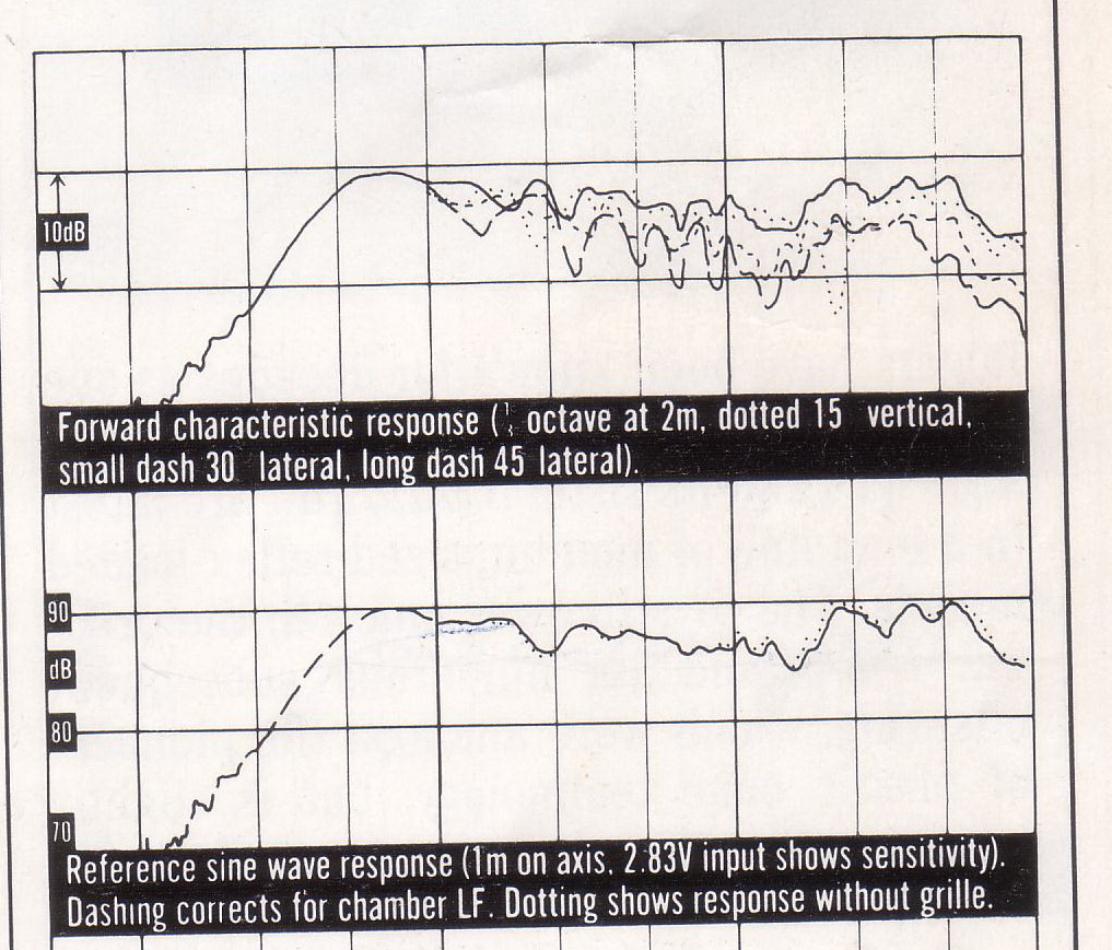

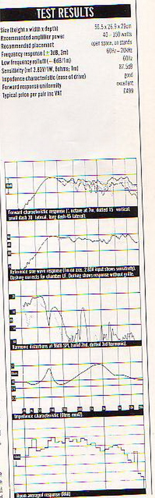

Here's a scan (sorry about the quality) of the MC4 test results from Hi Fi Choice.Definitely looks like the tweeter is voiced a couple of dB too high.Increasing the value of the series resistor in the tweeter network could be worth a try?
the Scales' figures ?
Hi eanee,
just what we need - thankyou very much indeed !
The frequency Response plots confirm what was in my memory about the balance of treble to midrange for those l'speakers.
Adding a series connected resistor to the tweeter circuit will alter the shape of the crossover's treble filter.
What I need to know is what is in that filter in the crossover, and there may be 1 or 2 resistors there currently,
thus my questions to Kris in #17.
Changes to the crossover will have to be done carefully so as to not affect the integration of the treble with the midrange.

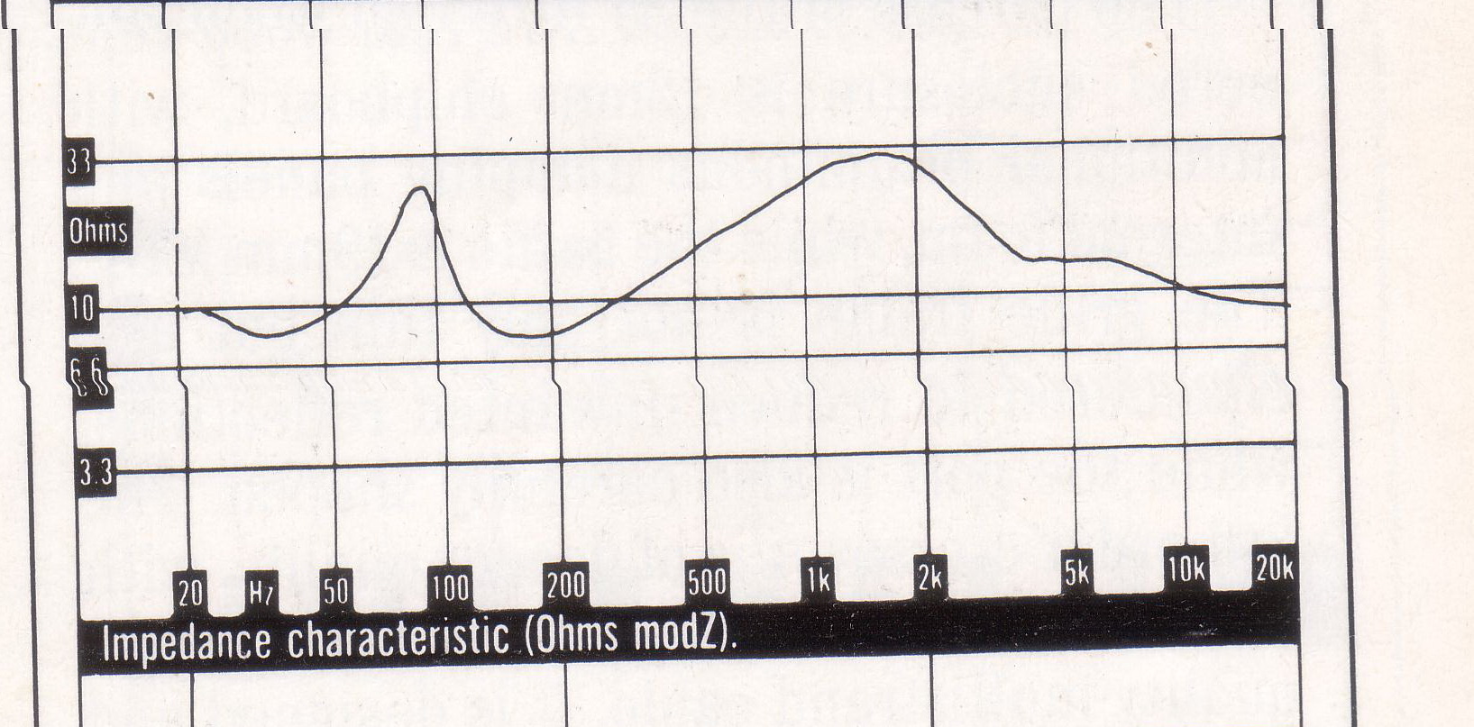

The Plots themselves are clear enough in your Scan, but not the numerals on the Left Vertical Scale of each plot.
Please can you look at the original and Post here:
(1) - for the top plot, what is the number for the dB spacing between the two horizontal lines ?
(2) - for the 2nd plot, what are the three numbers at the left edge of the three horizontal lines ?
(3) - for the 4th plot {Impedance}, what are the four numbers at the left edge of the four horizontal lines ?
In particular I need to know the Impedance values so as to be able to decide how to not detrimentally change the impedance whilst usefully lowering the treble output.

Hi Alan,
Hopefully these scans should be easier to decipher.
Impedance curve looks pretty benign.

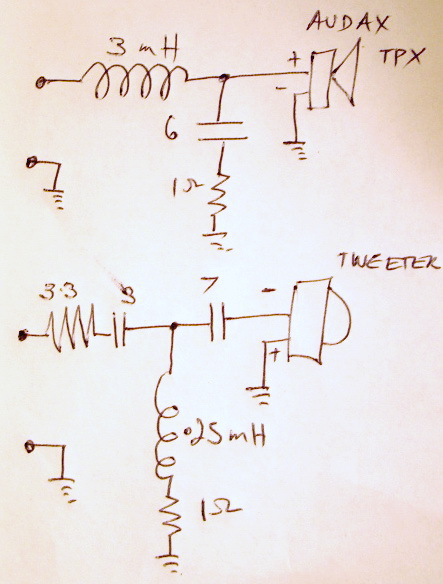

IIRC the MC4 crossover circuit had a 12dB low pass section with approx 3mH series inductor,6uF rolloff cap with 1 ohm series damping resistor.
High pass was 18db,3uF/7uF series caps plus .25mh inductor roll off.
Series input resistor to high pass of approx 3 ohm.
Cheers,Ian

Hi eanee,
Thankyou indeed for posting the clearer plots in which I can easily read the numerals on the Left vertical axis,

Here's the circuit arrangement as I recall,values should be pretty close.

and thankyou for posting the drawn schematic !

We should check the schematic to see if the connections are as eanee remembers, and if the capacitor and resistor values are as he remembers, thus please do write all details of all numerals and letters that are printed on these components, including any Brand names.
There probably won't be anything printed on the inductors, but if there is, then write that also please.
Check also the + and - Polarities of the tweeter and woofer connections to the crossover - note those that eanee has drawn,
and check these were remembered correctly.

"I see the MC4's treble drops off very sharply from about 11.5kHz in that "Hi-Fi Choice" plot, but perhaps what is printed includes a high frequency limitation error in the particular measurement technique used.
Does the Treble extend to any higher frequencies on any of the other plots for any of the other brands of l'speakers in that Issue of "Hi-Fi Choice" ?
Rechecking the Hi Fi Choice tests it appears that the premature 12k treble rolloff was unique to MC4 and MC2 both using the 30mm Elac dome.Other designs showed good extension to 20k.
Cheers,Ian
Subjectively, and according to admittedly crude 1/3 8ve measurements I took at the time, the Elac certainly had more hf extension on axis than the Celestion. It may be that the magazine in-room responses are composites/averages of various microphone positions, as Stereophile's in-room measurements are now. With a large dome like the Elac, the power response will be obviously be 'duller' than smaller diameter tweeters, all else being equal. Given the likely need for a supertweeter and powerhandling limitations, the HF1300 or the Coles equivalent wouldn't be my first choice for the money these days. They are good though, and even though the speaker it was in wasn't that great, the HF1300 made it surprisingly hard to move on. I didn't think it was exceptonally smooth, but the basic clarity and liveliness was really good.
Technicalities aside I found the Elac/TDL 30mm dome very explicit sounding but also a bit hard and relentless,paralleling the experience of krismusic in this regard.
Unfortunately this appears to have been an all too common complaint made about the early generation of metal dome tweeters.

Hi Kris,
as I'm not sure of your technical experience, I'll post a few suggestions to include with what I asked in # above:
Most multimeters are not specifically accurate with their low ohms readings,
thus to assist:
(1) - before you measure, touch the measuring probes together and adjust whatever may be possible on your meter to get as close as possible to 0 ohms reading.
(2) - measure a low ohms' resistor also, if you have one, so that we have a Reference.
(3) - the resistors in the MC4 crossover will still be in-circuit after the tweeter is disconnected, thus you will not get a correct reading across those resistors, but do not desolder them from the board, because that will reduce the electrical integrity of the existing joints.
(4) - measure BOTH tweeters, because there may be sample variations.
(5) -and I forgot to include in my last post, if there is any Part Number printed on the back of the tweeters, please write it in your post also.
