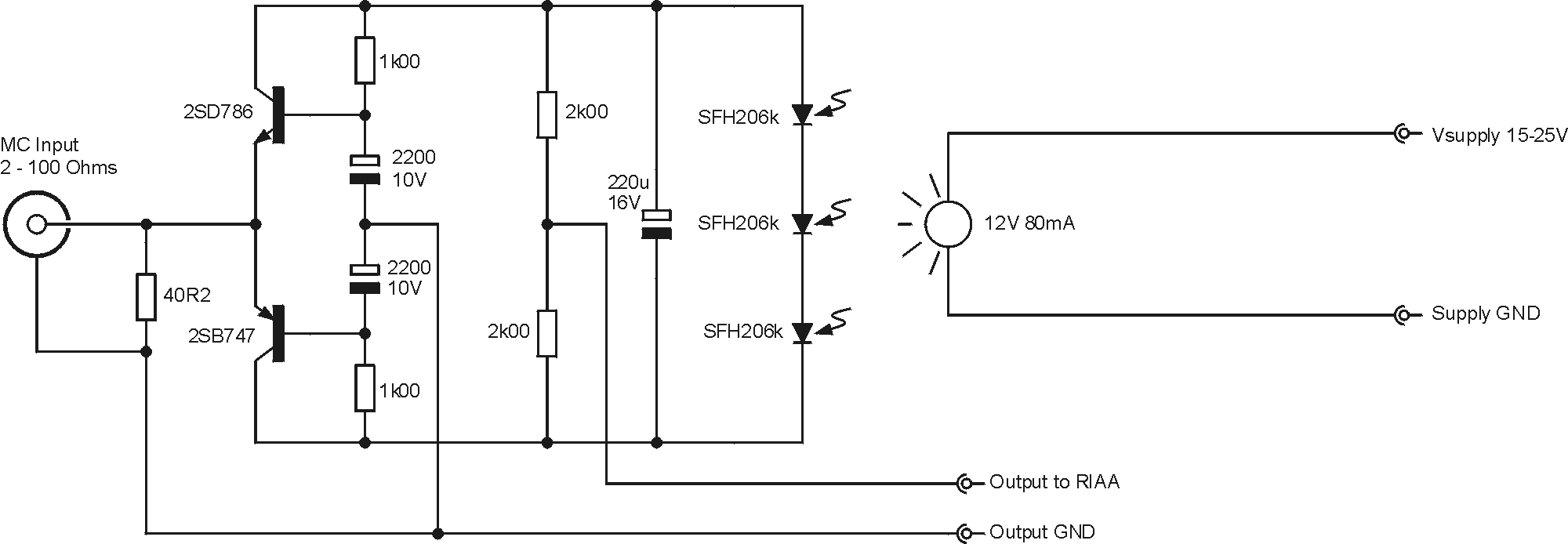

I am using ortofon step up transformers, but one day i with try this simple circuit.

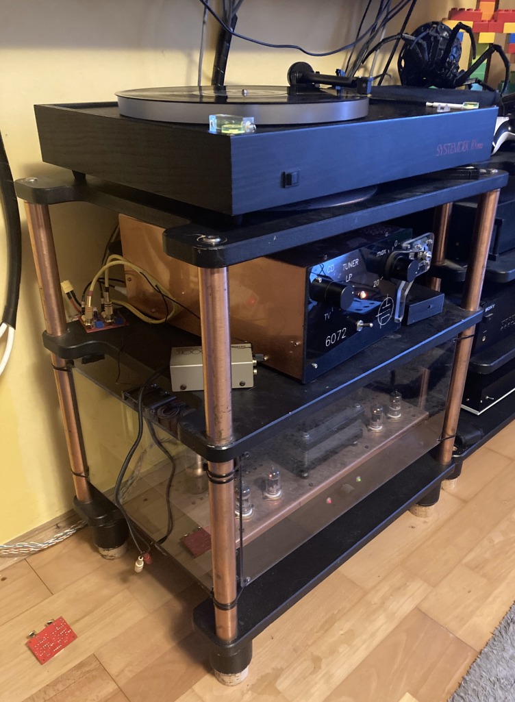

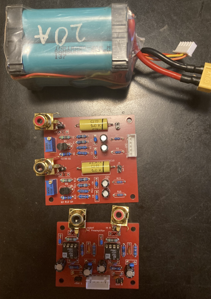

It was testing day today.
I've finished 2 versions:
  • the Hiraga through hole
  • the AD797 through hole
Pickup is Hana SL, RIAA&preamp is 6072 based circuit.
The good news is, both works fine. The Hiraga needs DC adjustment, the opamp based doesn't require any adjustment. After a setup and a quick test with oscilloscope and signal generator, then listening.
No noise issues, no 50/100Hz hum.
Before the AD797 I've tested with a few opamps I have at home, some are not cheap, but the AD797 clearly wins. Easy. Not bad. Quite similar freq response like the transformer, maybe a bit more base and the space, details, body of instruments are there. On the other hand, one side of an LP is enough. It makes me tired.
Than, I've tried the Hiraga (With unknown transistors at the moment! I've purchased 50psc of "2SC1775A", maybe it is, but who knows. I've selected 4 based on beta.) For hear it first, I did not like. The reason is, less treble, less details. Unconnected after 5 min.
... but, I've did tested each a few times and I've realized the Hiraga also has all the details, also volume setting was wrong (it has smaller amplification). If I listen for a few minutes, I clearly prefer the AD797. If I listen at least a side or a full album, I prefer the Hiraga.
I've kept rotating the AD797, Hiraga, Denon transformer for sometime just a track, sometime for an album.
The AD797 is not bad, quite close to the transformer, but the transformer is better. Same details level, but doesn't make me tired. I've expected this to be honest, but, it came really close. Maybe pairing it with a bit less detailing amplifier it would better.
The Hiraga, I think it has potential. Will try with other transistor, just for fun, and now I'm thinking to find some good SOT23 transistor and build it surface mount, put it into a tube/case like the Sony (or Ortofon T5) transformer with a power connection on the side.
Can you recommend surface mount transistors for the job?
Thanks,
JG
