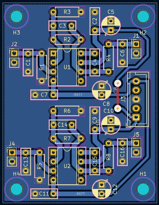

I have a pair of AD797 and I try it, just milling a pcb for it with a Hiraga. The Hiraga I will put together with BC560s first, so I have no big expectations, the AD797 may shine with that comparison, but I'm hunting for better transistors/arrays and designs with them.
Thanks,
JG
Thanks,
JG

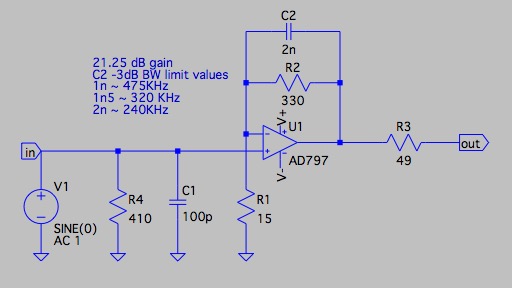

AD797 is a very low noise and adequate slew rate choice.
Firstly the AD797 was designed for ultrasound preamplifier use so yes it has an adequate slew-rate! In fact all audio opamps have plenty of slew rate, not usually an issue at all in audio design. For 20kHz on a +/-15V supply system you only need about 1.5V/µs for the fastest loudest signals, and at normal preamp signal levels 200mV/µs is enough.My parameter was slew rate
1.5 to 20 seems a good band, higher rates can damage or distort the output sound.
That was what I meant, too high a slew rate means the output stage may not be able to cope with the rapid signal change.

The OPA1612 dual opamp also makes a credible MC amp - 0.9nV/rt Hz so it’s at the same level as the AD797 and you can pack both channels into one opamp.

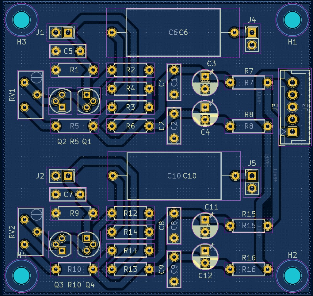

Thanks!
Probably the input cap is not needed either, but I made a place for it at least. I know the output resistor I left in the circuit is way too high, will replace. I way thinking about a few hundred ohm, like 330.
I have a tiny milling machine and used to make simple, one sided PCBs, but I've broke my last milling tool yesterday :-(
I will just order PCBs from China once I finish with the Leach first design also.
Thanks,
JG
