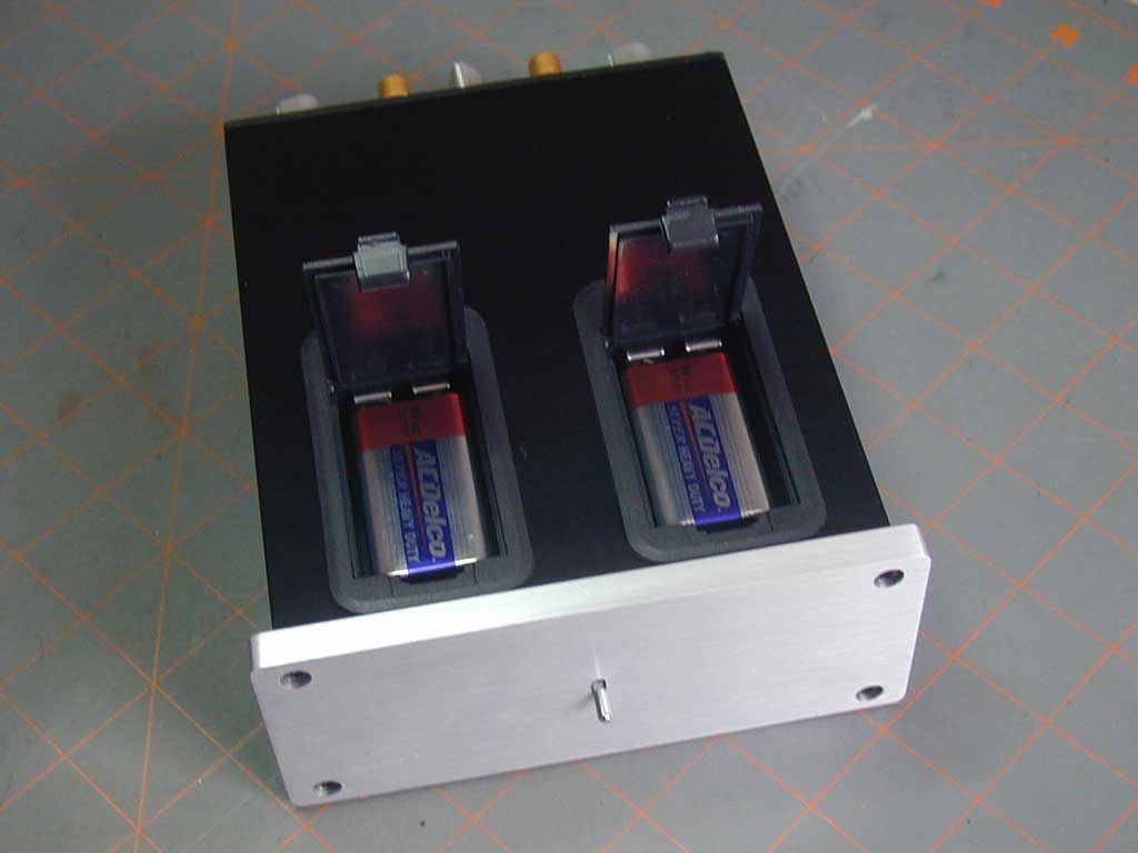

THAT300 is NPN only, you need at least 1-NPN + 1-PNP. I used the THAT340, 2 x matched NPN + 2 x matched PNP in the same package. The matching allowed eliminating emitter degeneration for lowest noise. I built the updated "Current Mirror" version, went way overboard with chassis design & switching functions, but basic circuit doesn't need it.
re: op amps. The right ones are eminently suitable for LOMC amplification. I've built an AD797 unit that is excellent. Not stand-alone though, an expansion card to the Apt Holman preamp:
Apt Holman plug-in MC expansion board
The basic circuit is simple, and could be used stand-alone with an appropriate power supply.
I run both above at 32-33dB gain, even at that much, they are very qui
